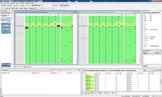

who can determine the right PREAMP value (see my patient ROM file).
May be with PC-3000 or MRT .....
(Terminal not work -> CTRL + L, hdd is damaged!)
Thanks for help!

Looks like D0 00

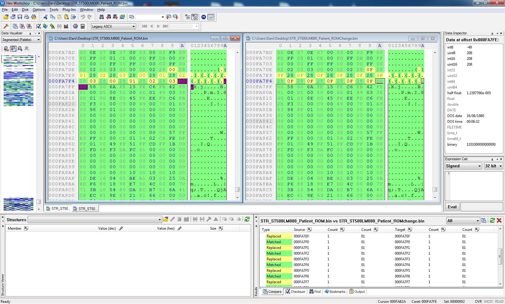

pre amp value indicated in your rom is D0 00

Question the PREAMP bytes are not a fixed offset !? (as far as I know).
How can i calculate the right position ?
Or is the right position in a another byte offset like MR jogs (WD - mod. 47 0x20).
Thanks for any info.

Locating the preamp ID in a Seagate F3 ROM:
http://www.hddoracle.com/viewtopic.php?f=59&t=2173&start=60#p18028
