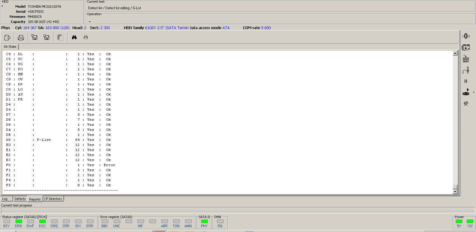

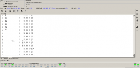

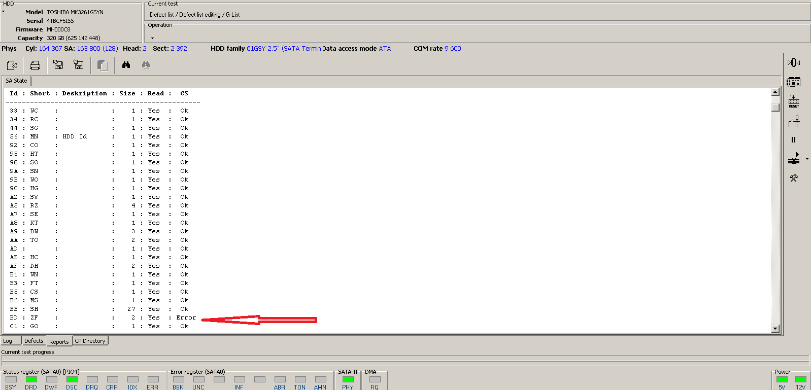

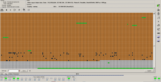

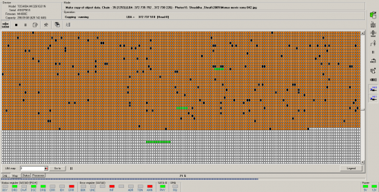

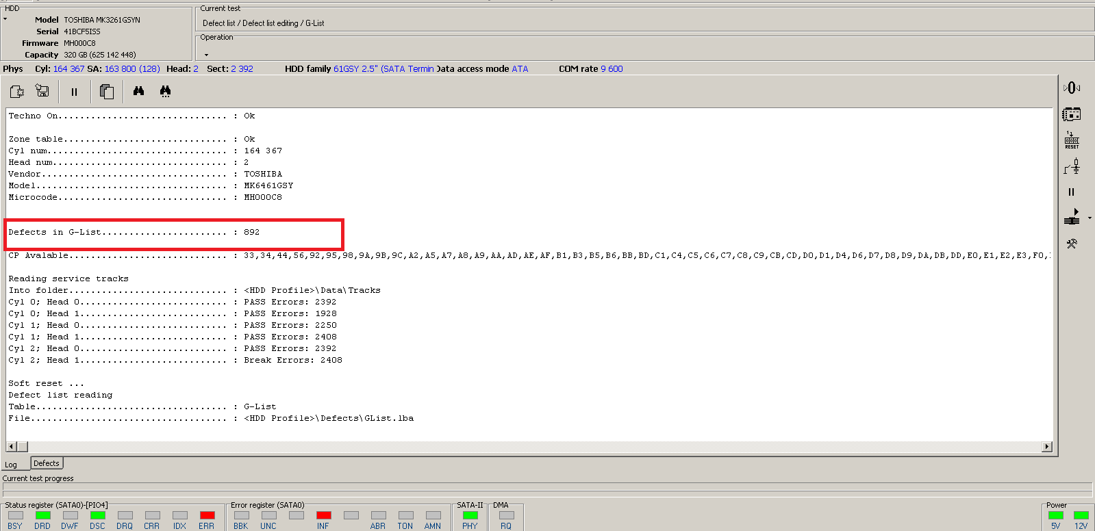

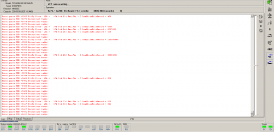

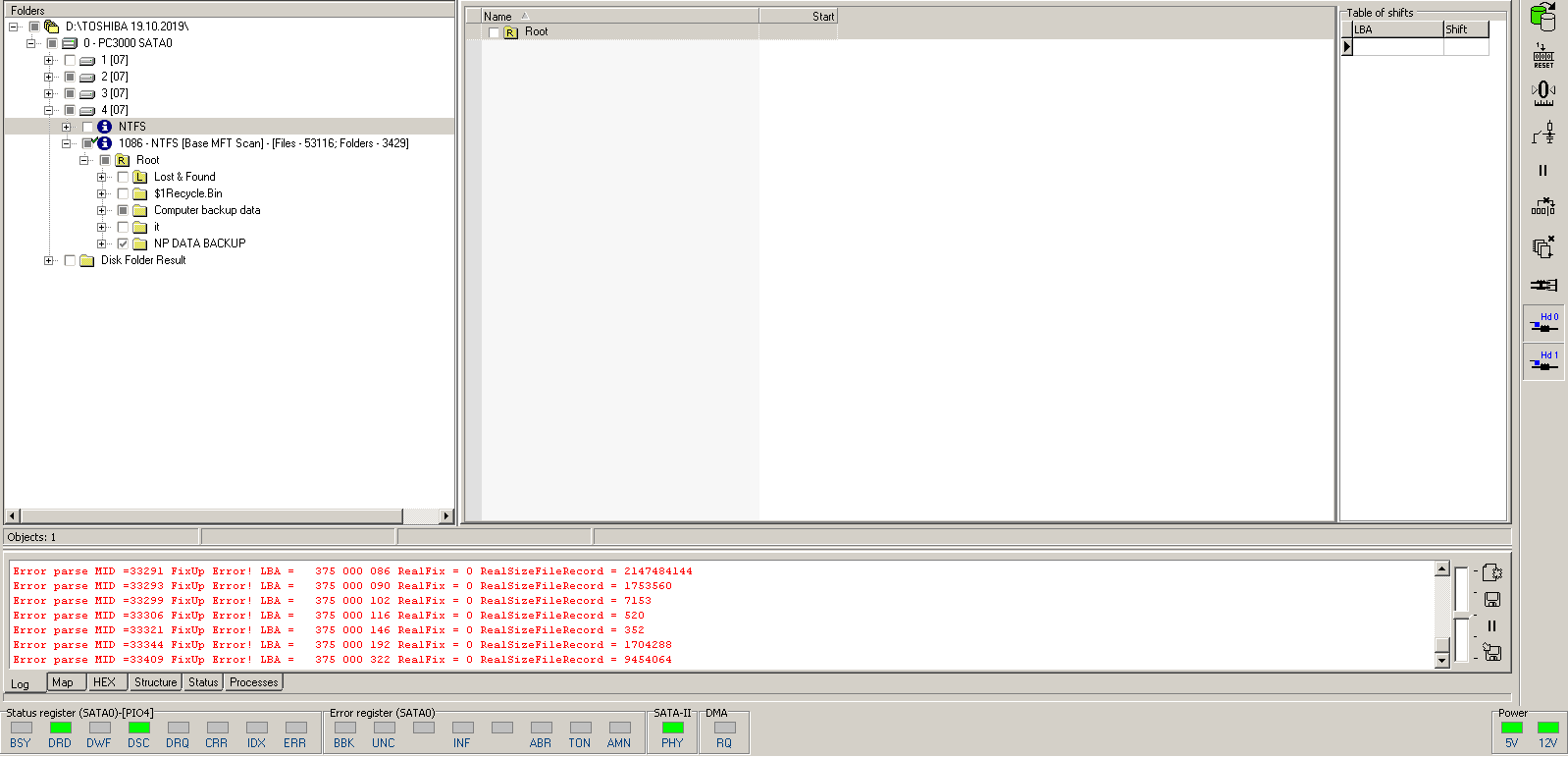

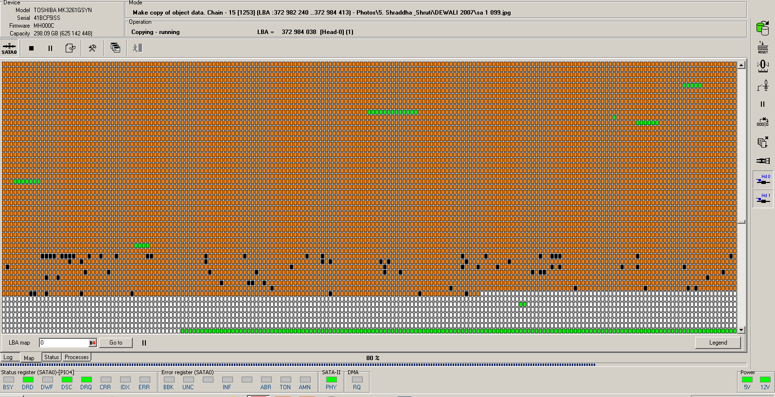

I am working on Toshiba MK3261GSYN hard disk.

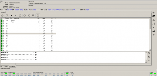

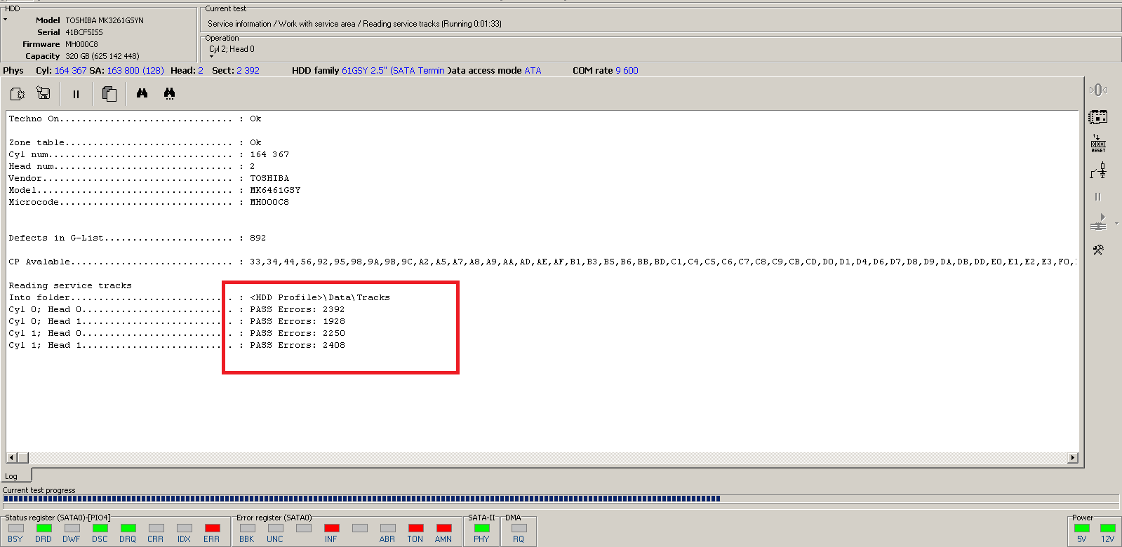

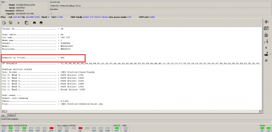

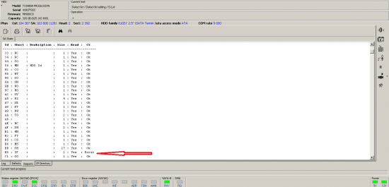

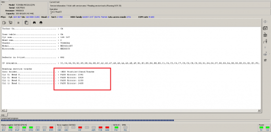

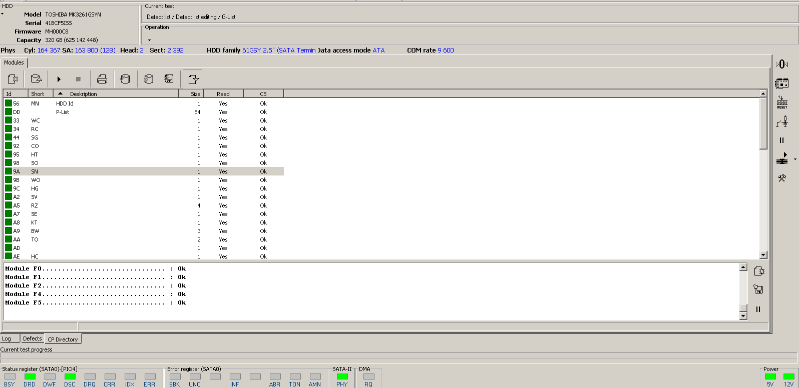

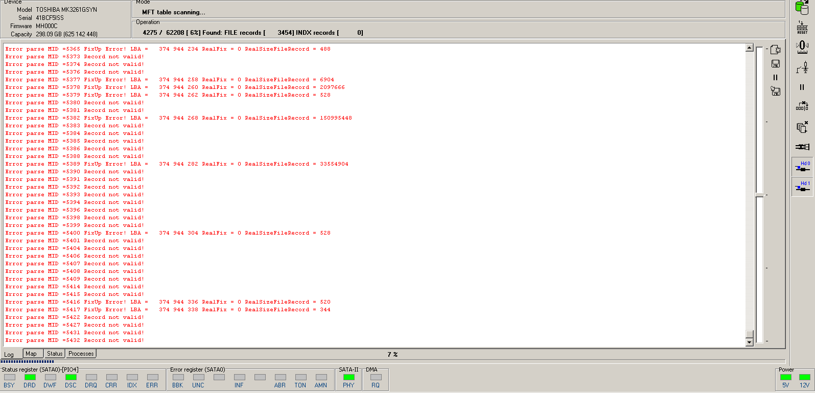

It has got detection I can read modules as well (except 2 ), crucial P list and G list can be read , however disk gives error while reading service tracks.

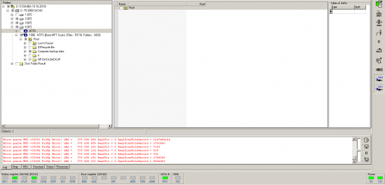

There seems to be somekind of MFT or ECC related issue as I could copy all MFT's after scanning I got all data folders which are corrupt.

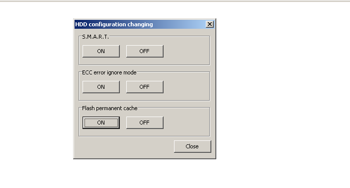

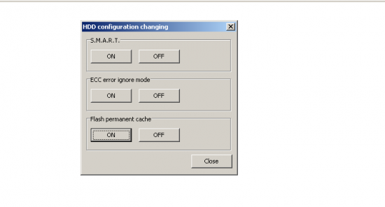

In disk configuration I have tried to switch OFF smart / ECC ignore error and cache settings , but even after altering settings outcome does not change,
I think heads might be OK (head 1 at least). Can someone pls. let me know what is root cause of these errors , where head is to be blamed or its firmware related issue.
I have attached service area backup here -
https://drive.google.com/file/d/13gO6Iu ... sp=sharing

Yes I suspect the same at least head 0 . But when I change ecc settings I could read flawlessly like any normal disk so I am puzzled whether heads are really bad or not.

Yes I am using PC3K with Utility & Toshiba serial adapter only ,I have recovered all data but large no of the files are corrupt (some of the folders are intact fully).
Since I am getting aprox. 25MB/sec transfer speed I cant say heads to blame fully. I think its either a bug or some setting

 Post subject: Re: Toshiba Heads or FW
PostPosted: October 26th, 2019, 18:44
Posts: 17312
The errors reported for the CP checksums are bogus. The problem is that PC3K has a bug which results in some CPs having the wrong size.
I have written a tool which extracts correctly sized CPs from the ROM.
CP_corrected_sizes.7z [3.15 KiB]
Downloaded 416 times

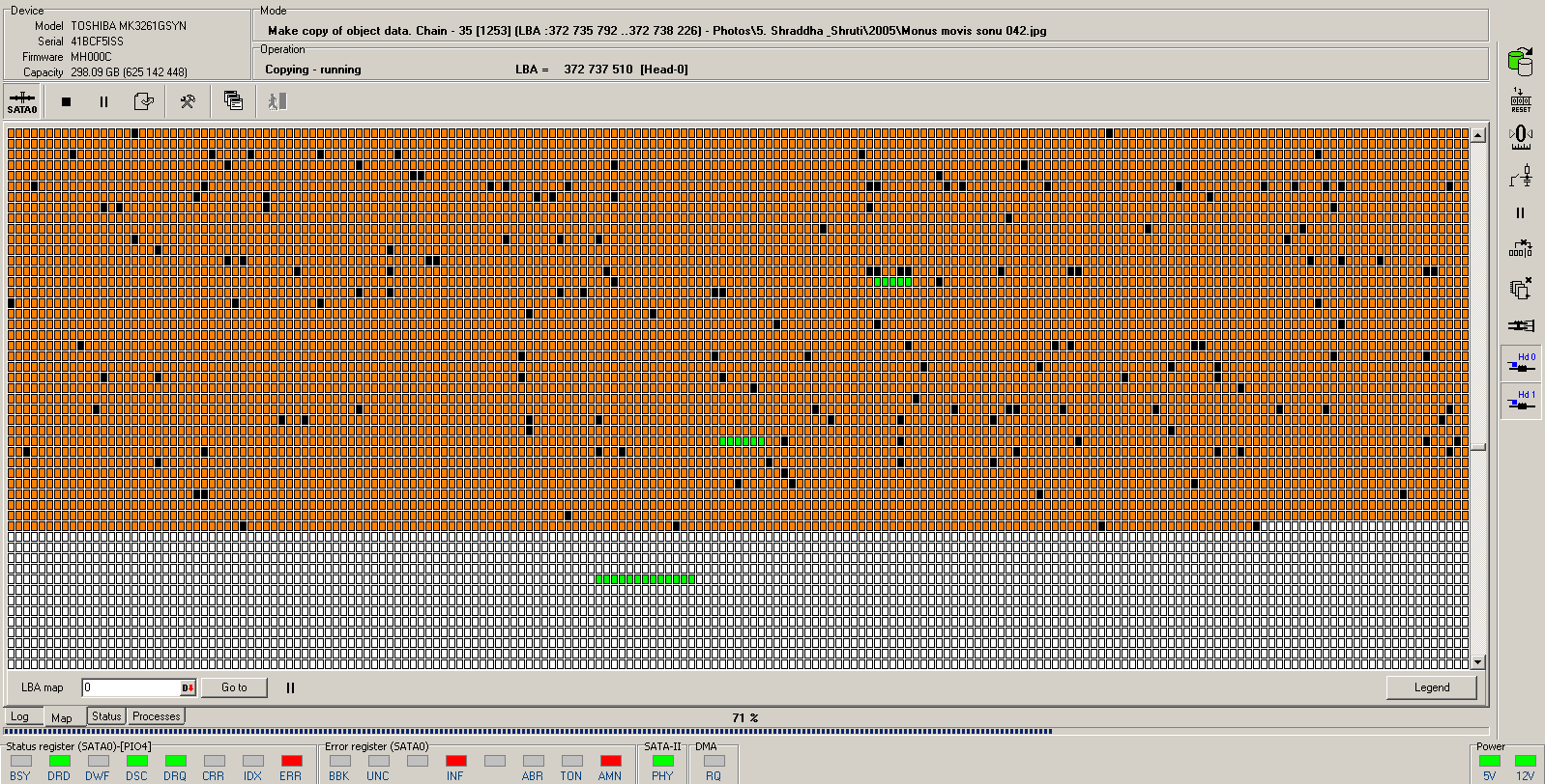

Here are those suggestions --
1) While entering utility check whether ATA+COM is selected -- here in my case only ATA was selected earlier (don't know whether that is default)
This helped I think to read zone allocation table properly,
2) There are 2 ways to create virtual translator and disk response / reading is different for both ---
a) we can create virtual translator while creating Headmap ---- This works , reading in this case is normal (green colour) unlike reading through utility.
b) Virtual translator in "reading by utility " selection , in this case disk reading response is different ( colour is orange here)
By these 2 simple changes I was successful to recover all data though head 0 was weak.
