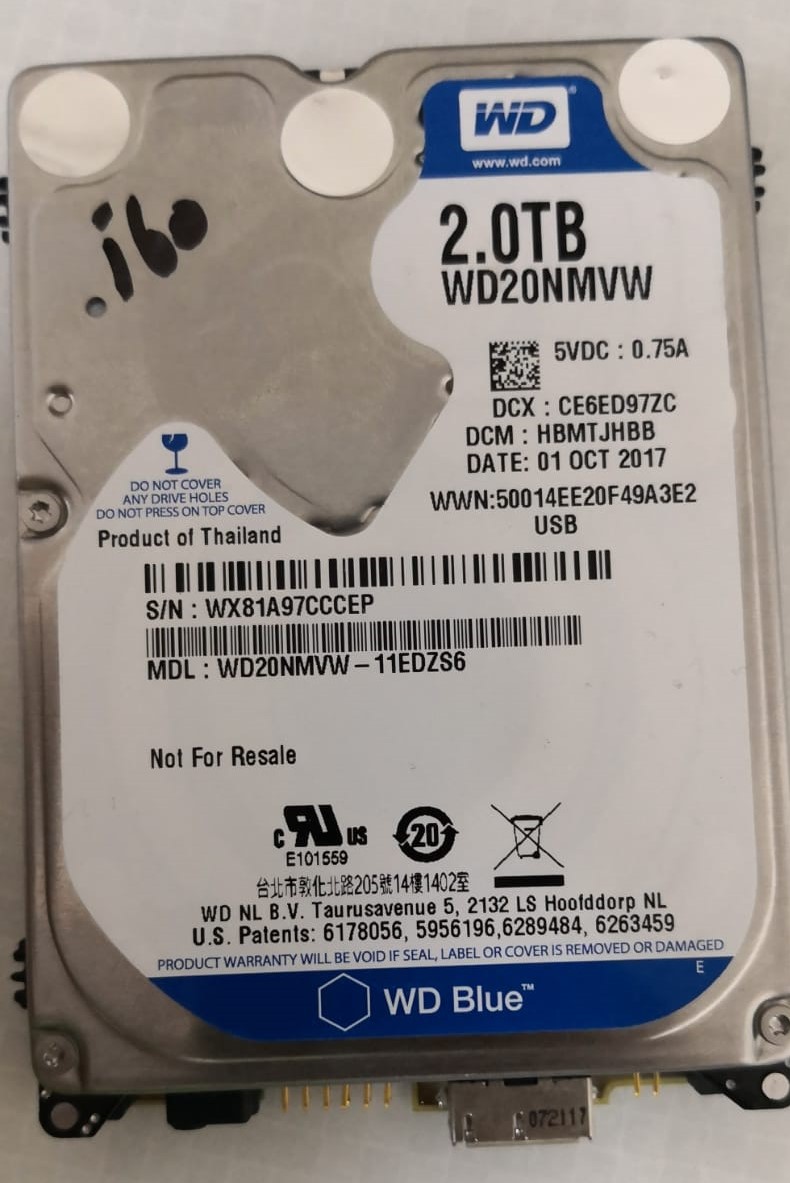

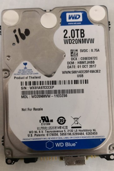

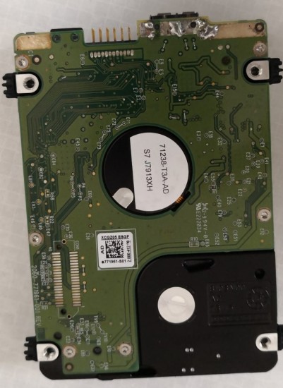

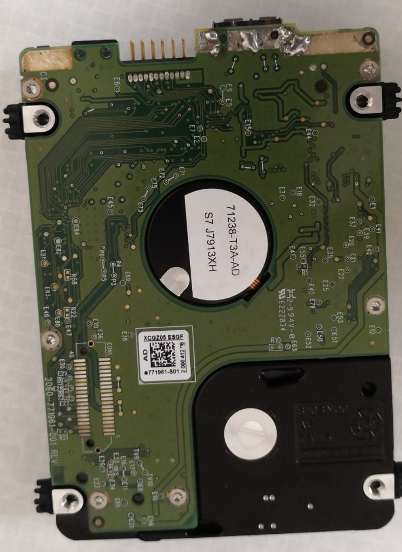

Hello friends
Help
Disk is running
drive cannot be accessed. No partition appears.
What is the solution because it is usb?
There are 4 more cases such as wd usb.

Convert to SATA interface for precise diagnosis.
+1 :good:
Use Sata Pcb 771960

Not sure what all that excess solder splatter on the underside is all about?
Have you tried connecting the drive with a usb2 type cable? One used with an android phone would do the job. Sometimes even if the usb3 side of the socket/circuit is damaged the usb2 side still works.
