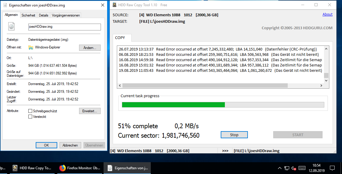

Hi @ll,
lately I was trying to recover some ore hopefully all the date from a friends hard drive. My first step was do copy the hole HDD (WD 10B8 2TB) to a Image. Sadly, this was really really slow (0,1-0,2 MB/s.). In the beginning there were lots of Read errors but after some days the error count was really low, so i had good hope to recover most files from the Image. Bad luck after 2 month of copy work we had a power failure and my server is not attached to an UPS. So the copy job reached a little more than 50% in 2 and a half months. I would like to resume at this point and not start all over again. Is there a way to do so? Or do you have another advice how to speed up the copy process? In the end it’s not really imported to get the files asap because the really important ones are emotional pictures but I’m not so happy to not restart the Server for 6 months and also power failure can always occur. I would be happy for advice.
Thanks Hangart

Hi. All is not lost!
I think I would use a different tool to complete the job. Probably Dmde as the free version would allow cloning.
First check your img file for the last lba to be written.
Then set Dmde to copy to a NEW img file with the starting lba as the first unread.
When the copying is completed you can then create a complete image file by merging the two.
Or you could write the first img file to a good drive and then write the second img file to the same good drive. Then carry out a data recovery as required.

I would use HDDSuperTool to apply the "slow fix", then use HDDSuperclone to finish the job. Set the start LBA to 1981746560.

I'm trying Dmde right now and it's working till now, slow but working. My server is running 24/7 so the time (approximately 30 days) is not a big problem for me. That's one of the reason I'll not try to fix the slow issue before I got the first complete Image. The other is that I'm afraid of damaging the HDD/Data when applying the slow fix.
After the imaging Process with Dmde is complete I’ll give HDDSuperTool and HDDSuperclone a chance to get another complete Image.
I’ll keep you updated.
In the mean time I tried to recover some .jpg s from the “first” (aborted) Image with Dmde and it works fine. So I hope I’ll be able to recover most of the Files with a complete (merged) Image
Never the less I want to thank you again for your help I really appreciate this.
