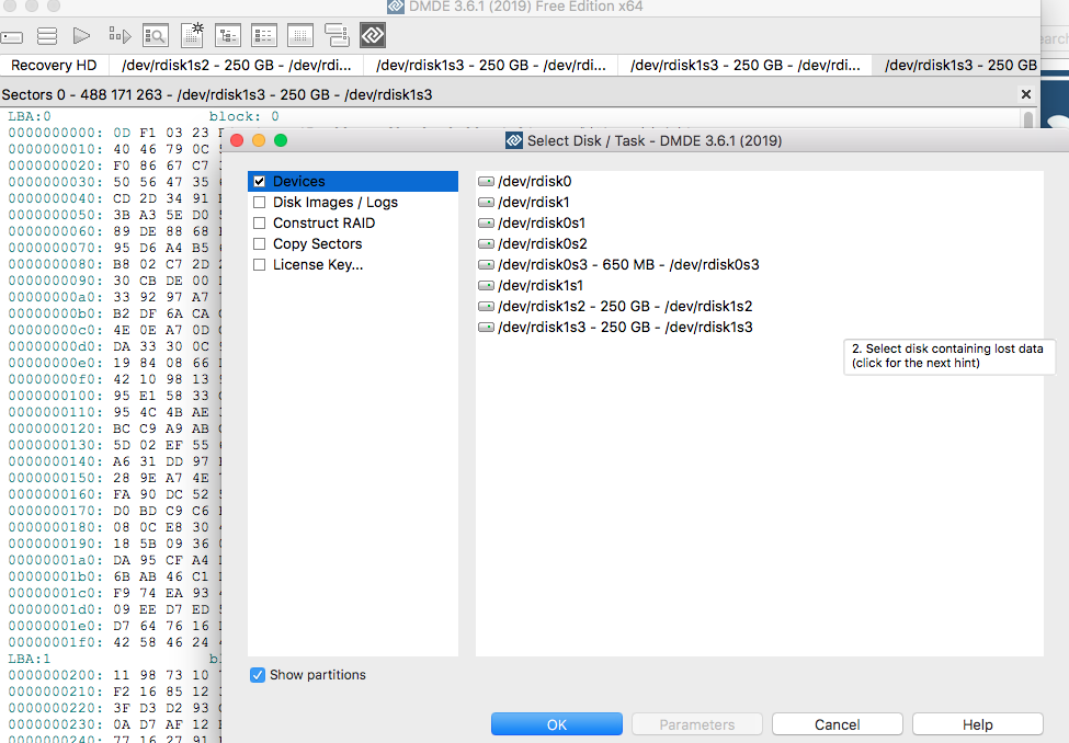

Can you show us the Partitions window in DMDE?

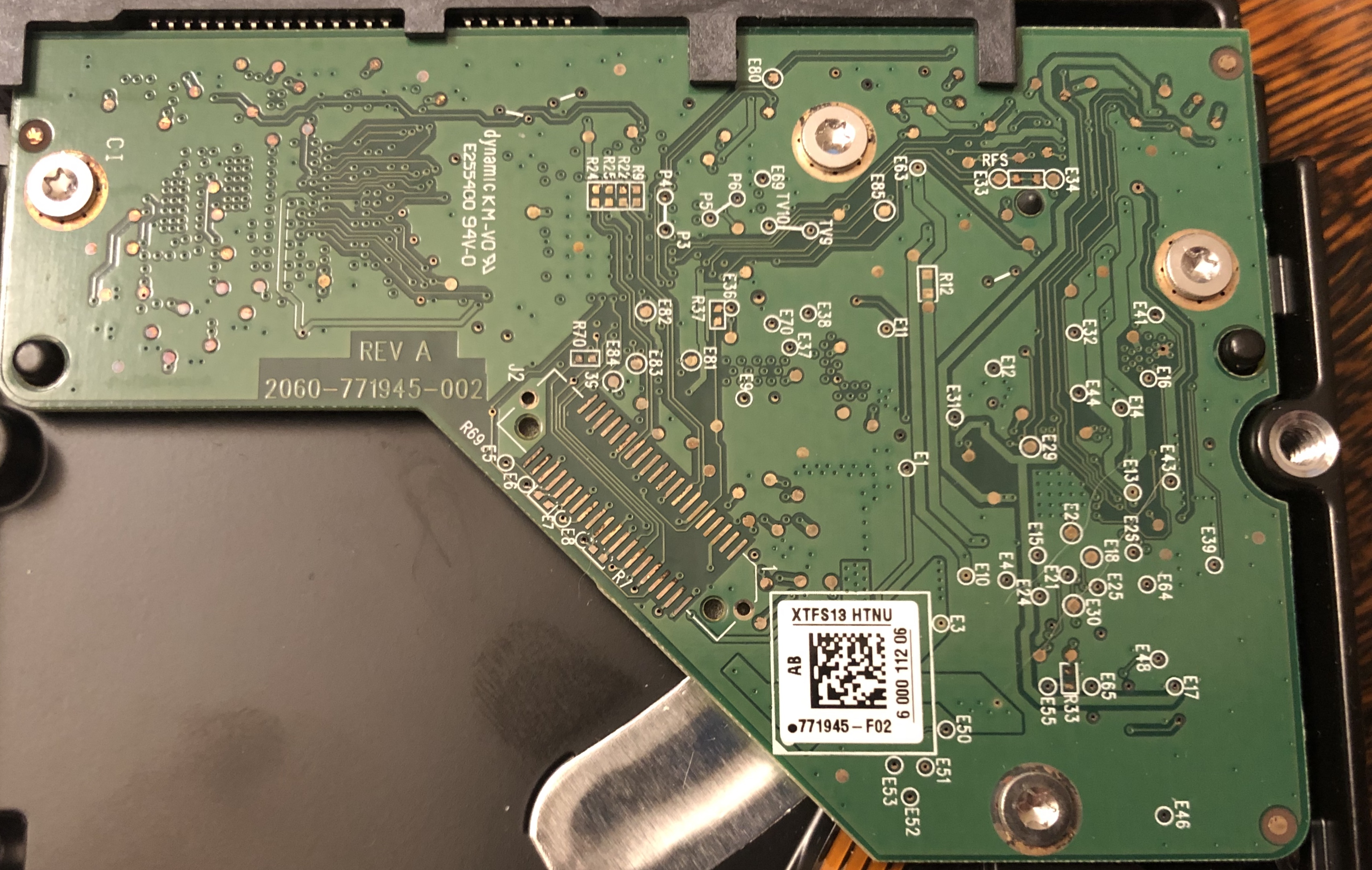

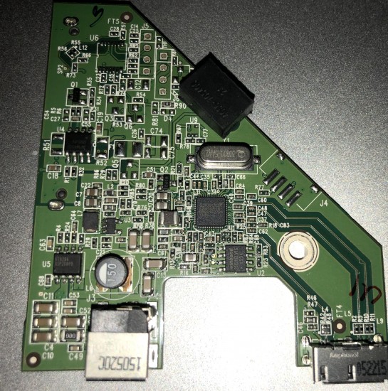

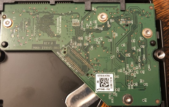

Can you upload a detailed photo of the PCB from the enclosure?

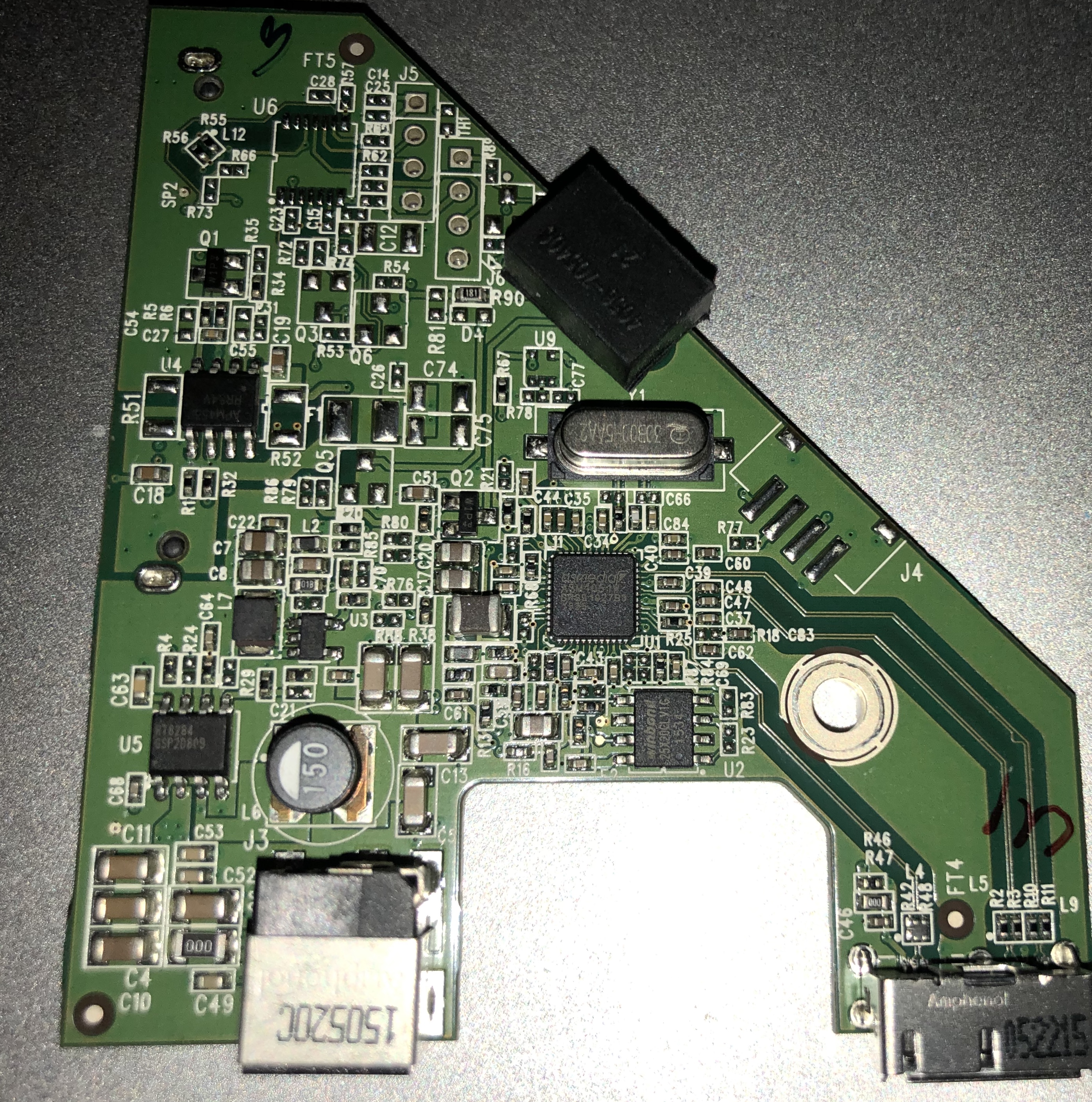

OK I am going to grab that app and send the report. Meanwhile, here is a photo of the board

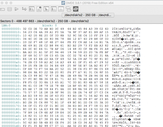

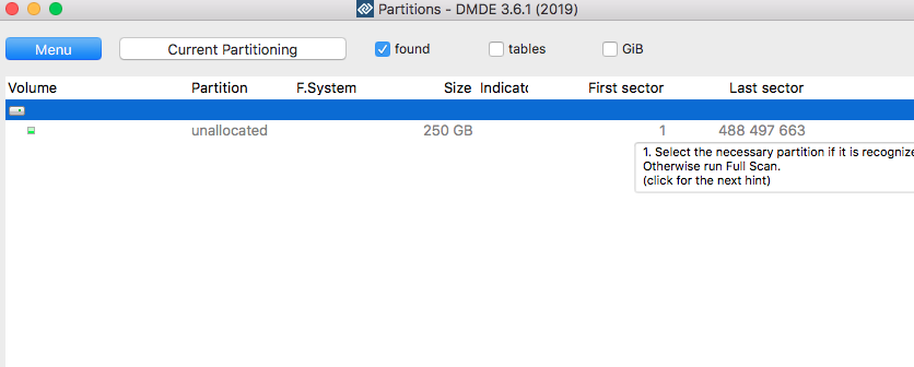

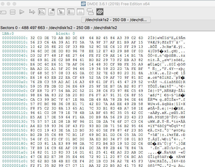

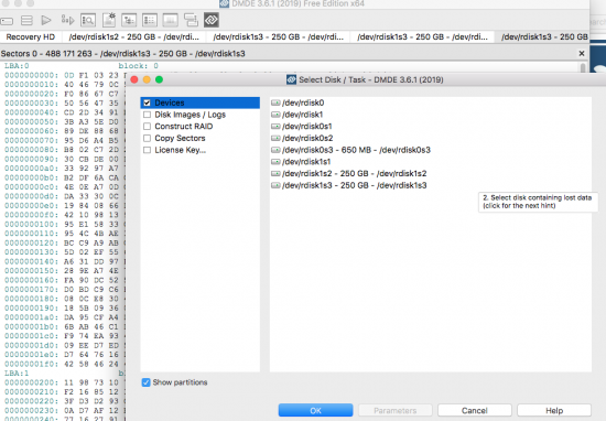

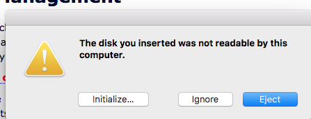

OK I am attaching screen shots from the time the drive is connected to my Macbook. First the system says the volume is unreadable, to which I select Ignore, and then what I see in the DMDE interface. I'll await your interpretation on this.

As the drive was from a MyBook, I suspect it could be encrypted by the enclosure.

The data is usually encrypted by default by the USB bridge in the enclosure, with a blank password. So if you do decide to set a password and “enable” the encryption all it has to do is change the encryption key and not have to go through the whole drive encrypting the data.
Not saying the drive doesn’t have other low level issues, but bear in mind that it could very well be encrypted.
Try some hex editing software (like winhex, or hxd?) to view and/or image the first few thousand sectors and see if you see some “repeating patterns” which will be encrypted zeros.
Or if you can make out the USB controller on the bridge board, such as JMSxxxx we can see if it’s an encrypting one.

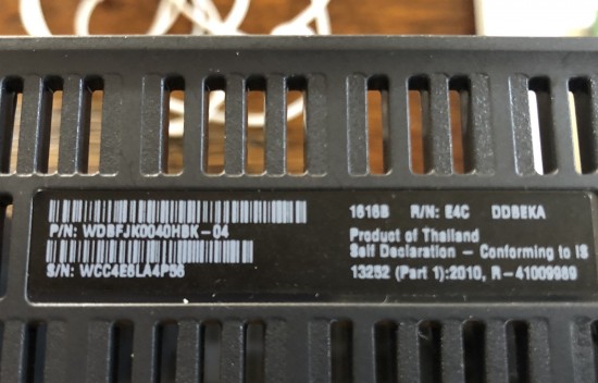

PostPosted: October 29th, 2019, 15:12

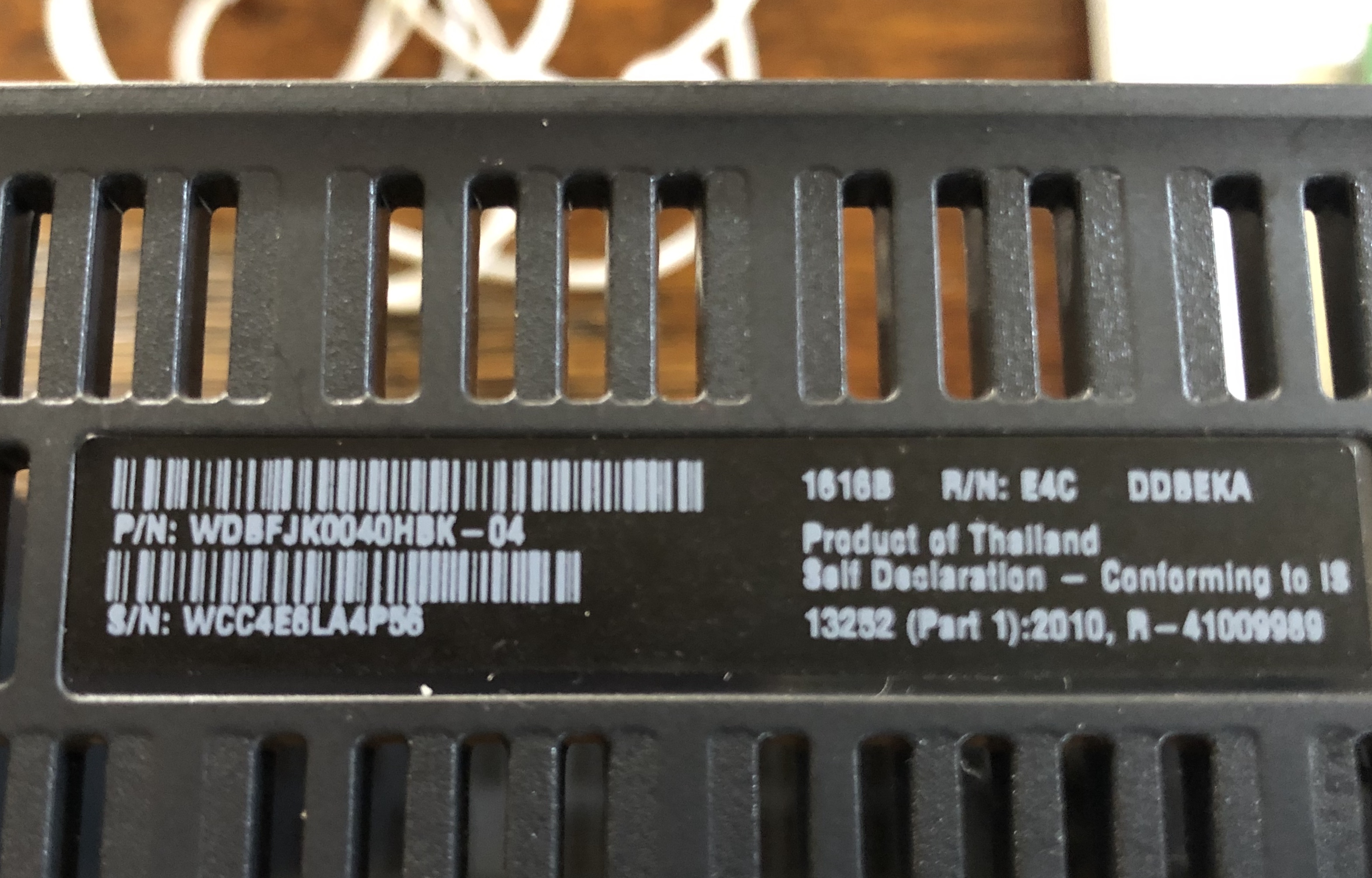

Can the OP provide the P/N or S/N of the enclosure?
Can you upload a detailed photo of the [component side of the] PCB from the enclosure?

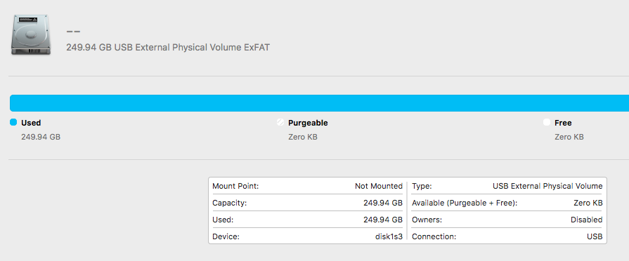

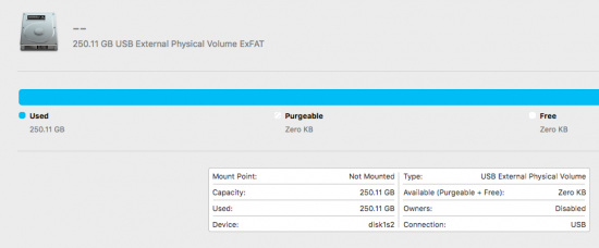

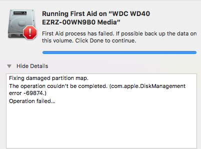

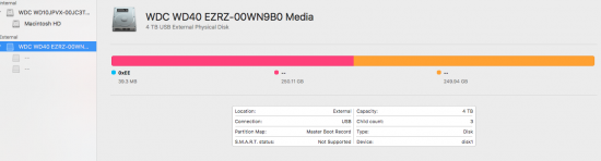

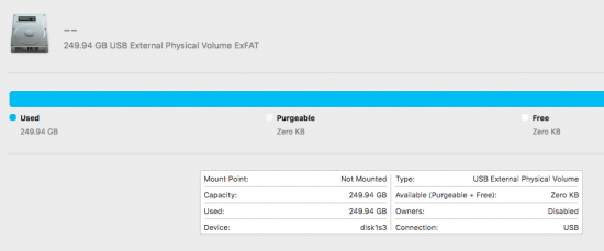

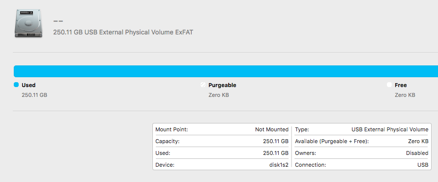

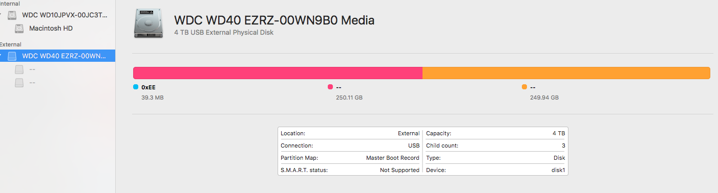

Hello all - I've been out for a bit, so here is some additional photo information as requested. Hope this helps. Also I am attaching what I saw in Disk Utility on the Mac.
Aside from the obvious, I am quite concerned that the partition sizes showing are smaller and don't add up to 4TB.

 Post subject: Re: 4TB WD Blue issues following power surge/outage
PostPosted: October 29th, 2019, 17:35
Posts: 17335
Your drive has two unencrypted partitions, but your enclosure's 4KB sector size is the reason that they are seen as being 8 times smaller than they actually are (512B x 8 = 4KB).
    8 x (249.94 GB + 250.11 GB) = 4.0004 TB
You can recover your data with DMDE, or you can purchase a bridge PCB from a 3TB+ My Book Elements.
If you connect the USB-SATA bridge PCB to a USB port on its own, and power it from an AC adapter, does its LED flash? Does you PC/Mac detect that anything is attached to the USB port?

https://dmde.com/download/dmde-3-6-0-770-mac32-gui.zip

Thanks - I did install and run this software with the HDD attached, but to be honest this is an area out of my comfort zone.

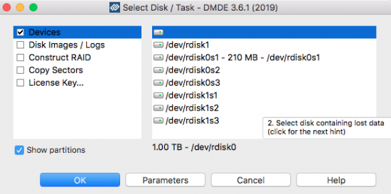

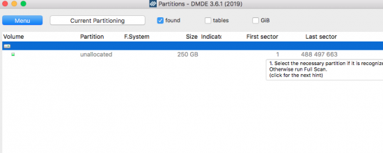

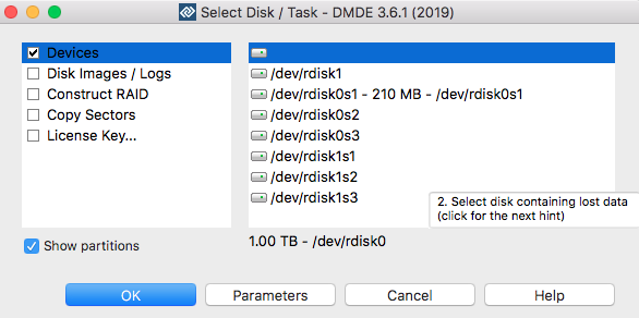

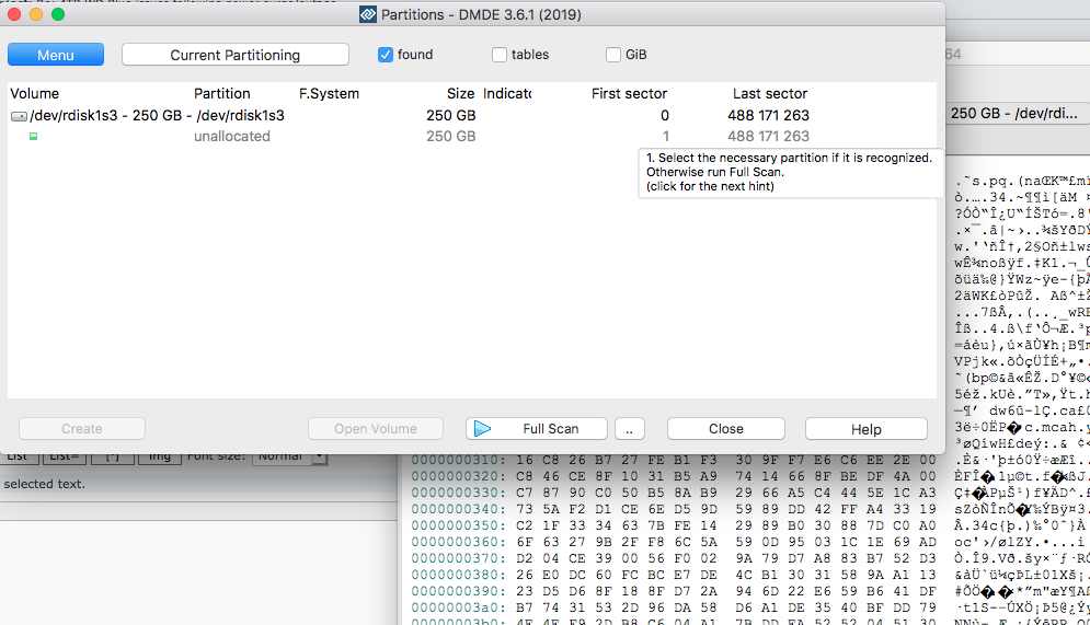

Just to be sure, in DMDE double-click each Volume and expand the Root. Do you see your file/folder structure?
Could we at least see the initial Partitions window?
PostPosted: October 29th, 2019, 19:40
Joined: October 28th, 2019, 19:47
Posts: 16
Location: West Coast

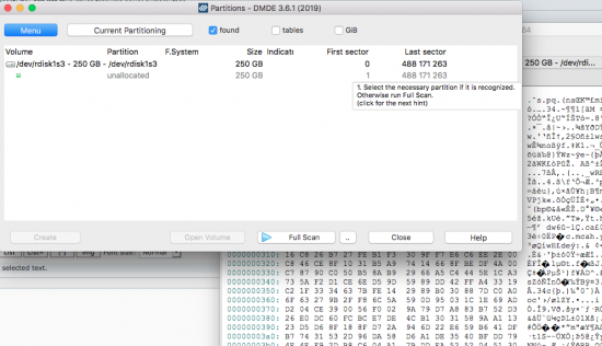

I hope this is what you were looking for. Since the drive is connected to a USB cradle, not via the WD board, is this all just that default encryption that is preventing me from seeing my files? If there is any other DMDE command I can run to provide more details, let me know!

And just to answer the question, the file/folder structure is clearly not visible...
