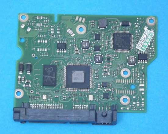

This PCB has two SOIC 8, one next to the other.
My donor PCB have two, but the original PCB came with only one.
What is the difference?
The PCB is 100664987 REV B
What are the markings on the ICs?
