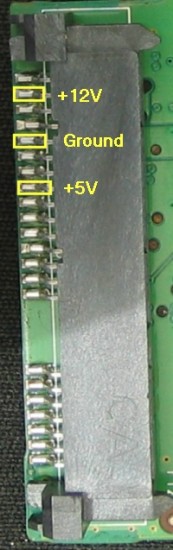

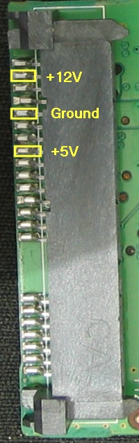

Posts: 17230
Can you measure the voltages between ground and each of the +12V and +5V test points?

No change when keeping the button, unfortunately, don't have a meter to measure the voltage.
