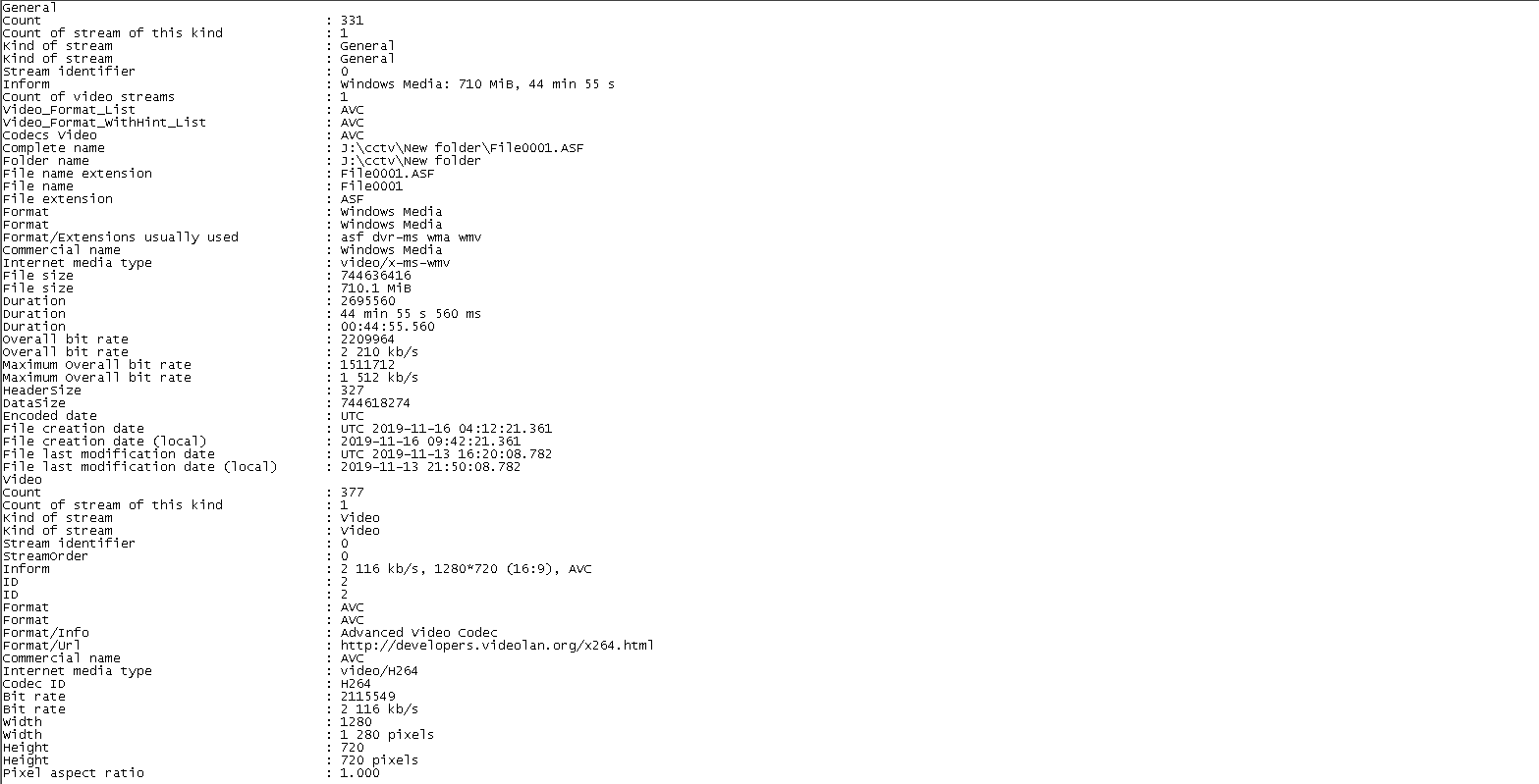

These are exported video files from a DVR system (model unknown). Exact cause of corruption unknown.I have tried my best before finally posting here.
Files are identified having AVC codec (attached is snapshot). They may or may not have full video data or its corrupted thats why files are not playing.

for any others following,
tried asfbin, it says either no stream information is present, or that critical file header info is missing.
Developers site for further info :
http://www.radioactivepages.com/asfbin.aspx
other repair progs replicate whats already there and cut it at 5k file size.
likely as per above, and expected, headers plus random data.
header is associated with .wmv
no programs so far play the files in their current state.
Recovery programs might have been useful at full device stage, looking for a filetable / deleted files etc
Repair programs are finding nothing other than the header.
