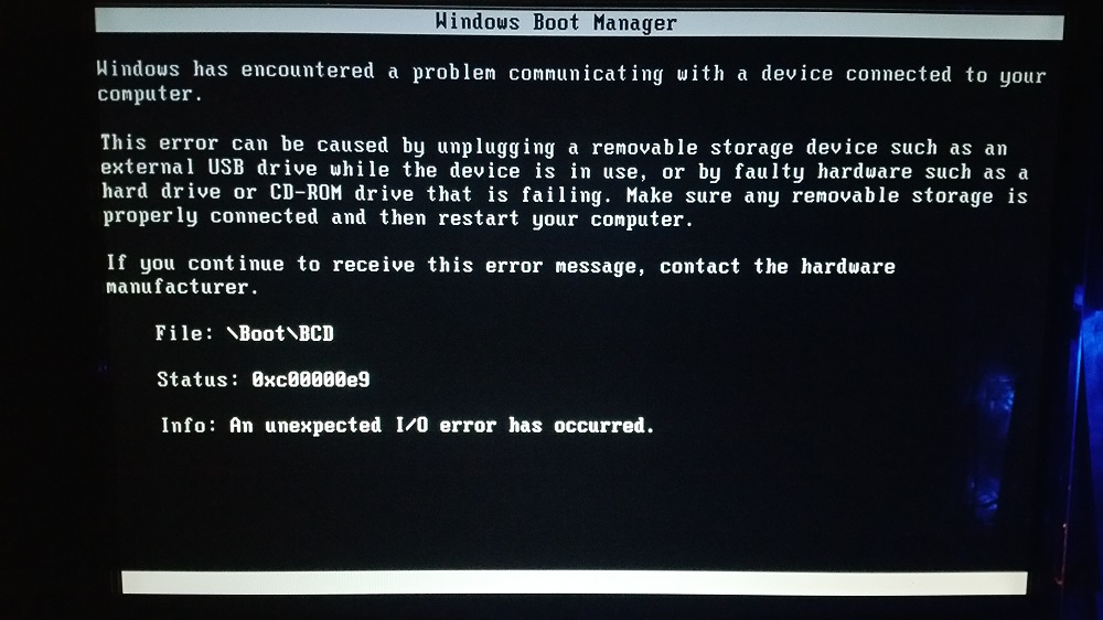

Hello everyone, quick introduction: I am an idiot!! I could completely avoid this doing a simple backup..
The system (win 10) froze on shutting down and I had to turn it off by force. From that moment on there has not been any way to access the drive (a 320gb SATA Maxtor). I would like to recover the data if possible. Up until now, I have had no luck accessing the drive.

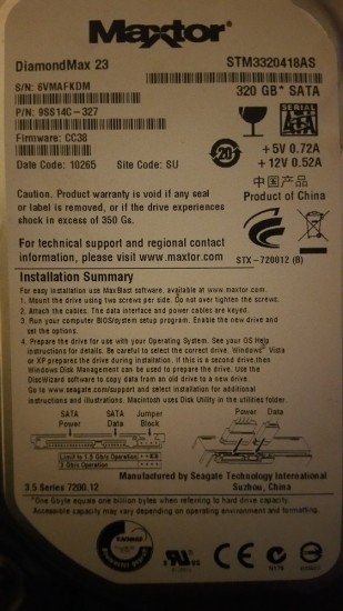

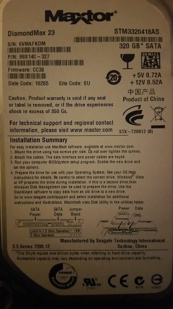

Here the drive specs:

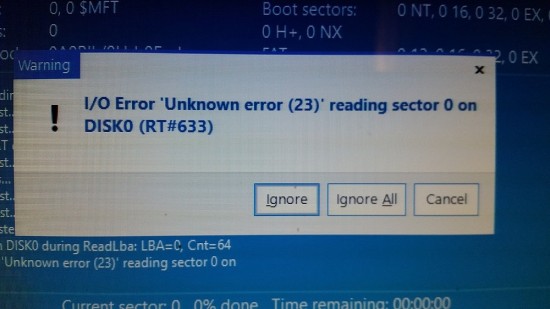

The first few times after the failure the driver was still able to run win 10 recovery tools menu but, aside from being slower than the norm, every tool I tried have been of no use: each one of them gave me back either i/o error or disk write protected. I tried with CHKDSK from cmd but it saw the drive as RAW.

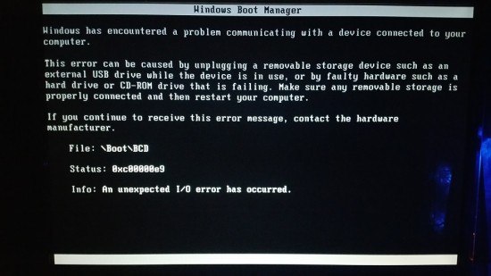

This is what I receive every time I now turn on the pc and choose to boot the drive.

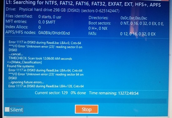

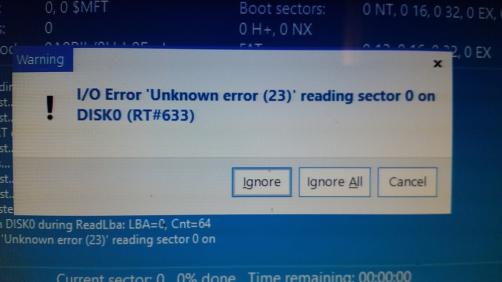

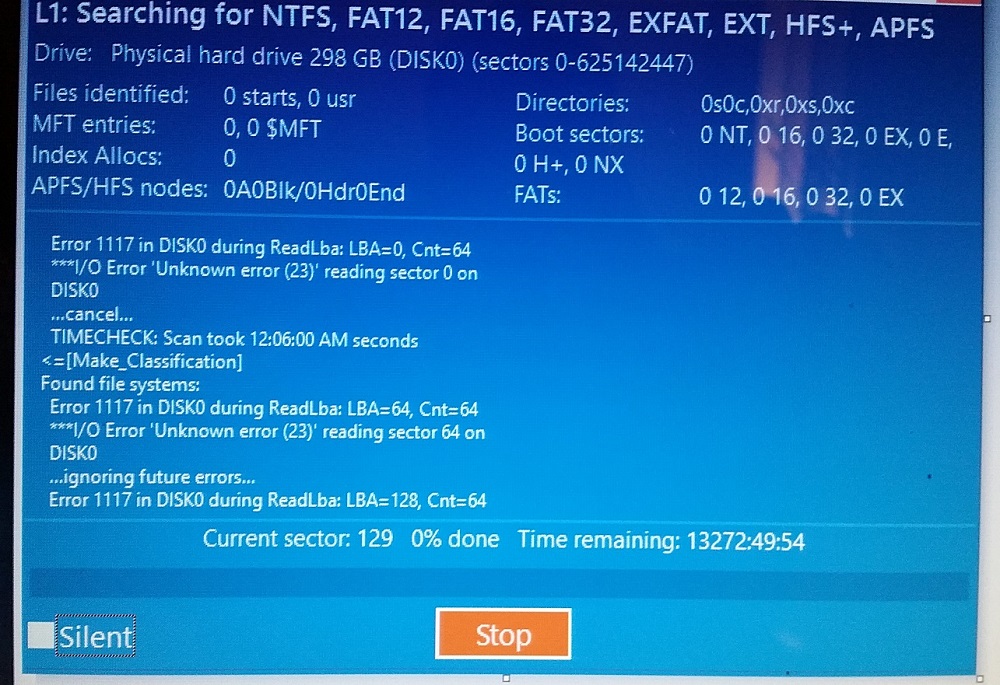

I tried with several other recovery software. Most of which simply didn't detect it or gave back an i/o error. One of those or maybe the only one able to scout the sectors is GetDataBack. These are some of the errors it was giving.
Based on the type of errors I showed would a PCB swap be of any help?
I would really like to have access on the data again.. please help!! Thank you

Your drive is actually a Seagate drive, branded as Maxtor.
Your problem is 99.999% nothing to do with PCB.
It looks like media issues (bad sectors) to me, possibly with some firmware problems as well but we’d need a terminal output to give us more information.
If your data is at all important, then my advice is to take it to a PROPER data recovery place (NOT a regular PC store or “PC Guy”). It shouldn’t be “too” expensive AT THIS STAGE.
However if your data isn’t very important and you are willing to risk losing it with DIY attempts then you could try cloning it with something like “hddsuperclone” or “ddrescue” (search on this forum for more details) and then try and recover the data from the clone. You may need to use recovery software if the file system is damaged.
Please be aware that DIY solutions carry an element of risk and could damage your drive BEYOND RECOVERY, even for a pro.
Good luck!

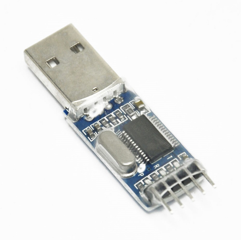

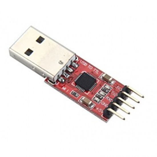

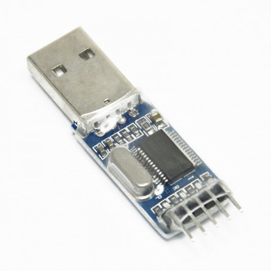

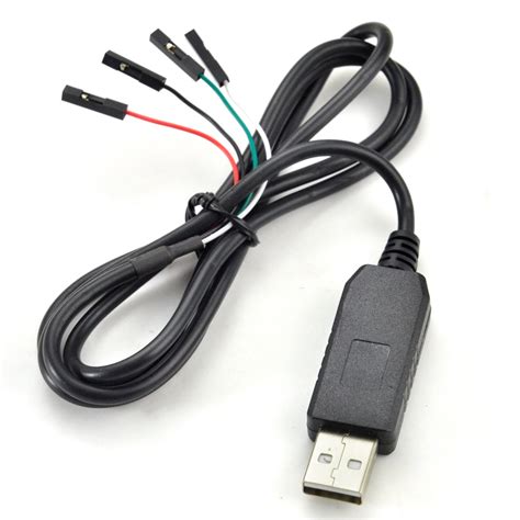

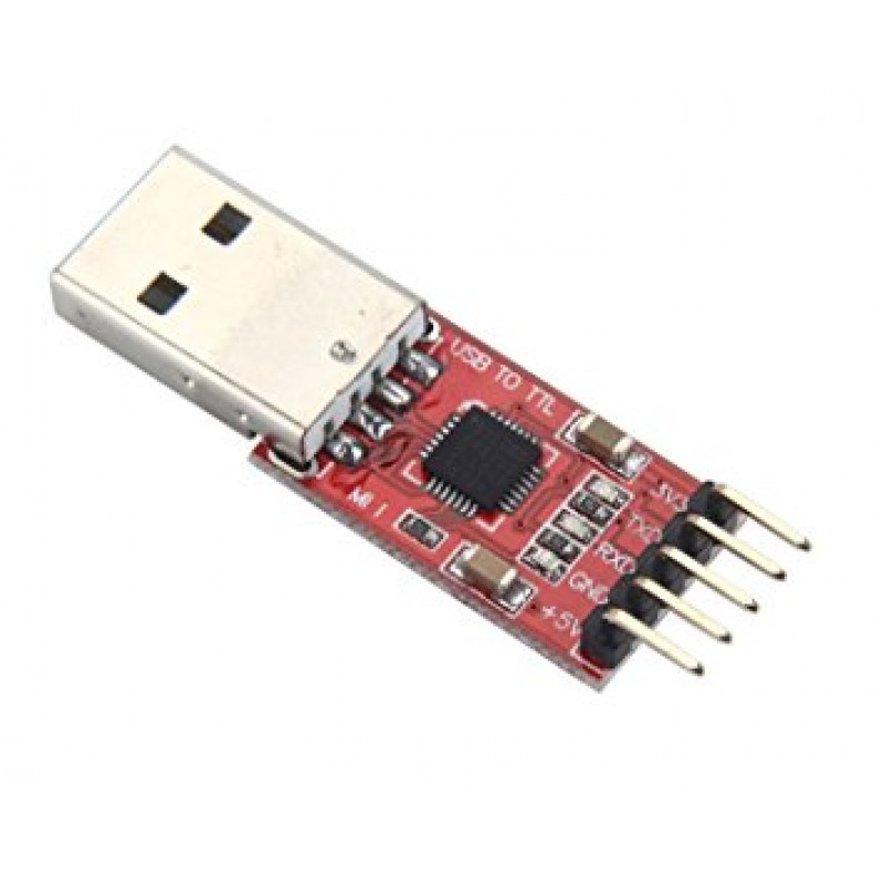

Just to be sure: what is the difference, if any, between these three TTL adapters?
First one appear to be cheaper.
Last one is not simply an USB jack ending with pins, I presume..
Thank you
 Post subject: Re: Old Maxtor recovery - I/O error
PostPosted: May 21st, 2019, 17:56
Posts: 17335
All 3 appear to be 3.3V TTL-serial converters. Take your pick, but make sure you get an additional cable for the first two.

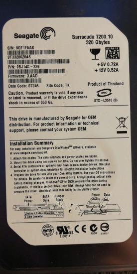

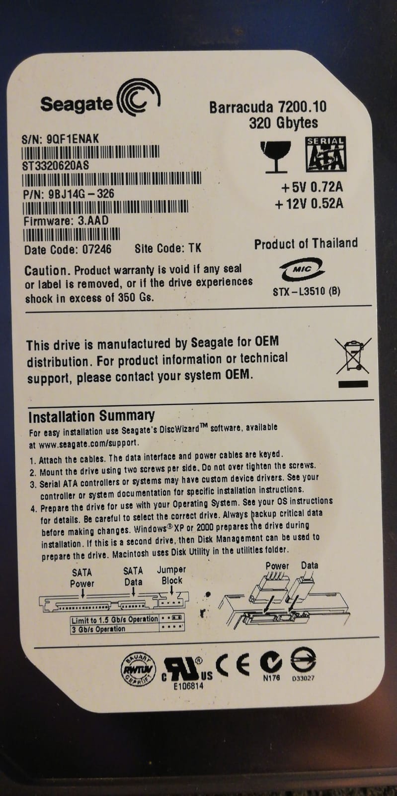

This one will be my GPD (Guinea Pig Drive :) )
An old half failed Seagate. Perfect to mess with..

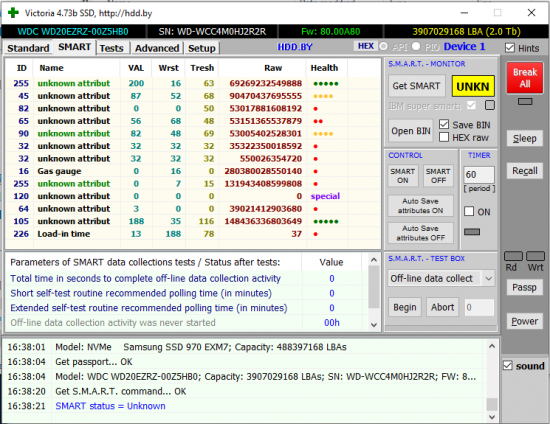

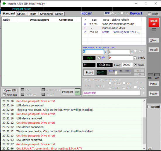

I run Victoria. SMART: unkn
PostPosted: June 21st, 2019, 3:22
Posts: 927
Location: uk
oneRd wrote:
Sorry, I didn't mean to kill you enthusiasm with my "think out loud ignorance"
Make sure you use an up to date version as is here: http://files.hddguru.com/download/Softw ... ia473b.zip
If that doesn't work then try with the drive installed in a usb connected external enclosure.
Or you can set the sata port to compatibility/ide mode in the motherboard bios.
One question though....did Victoria see the drive in the passport tab even though you couldn't run the get smart command?
PostPosted: June 21st, 2019, 14:52
Joined: May 15th, 2019, 13:14
Posts: 70
Location: Italy
I was using the 472b so I assume it was okay

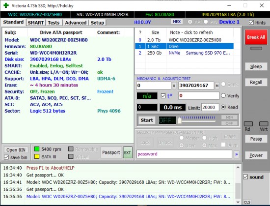

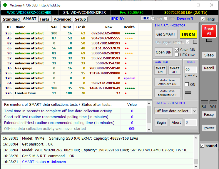

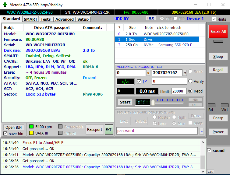

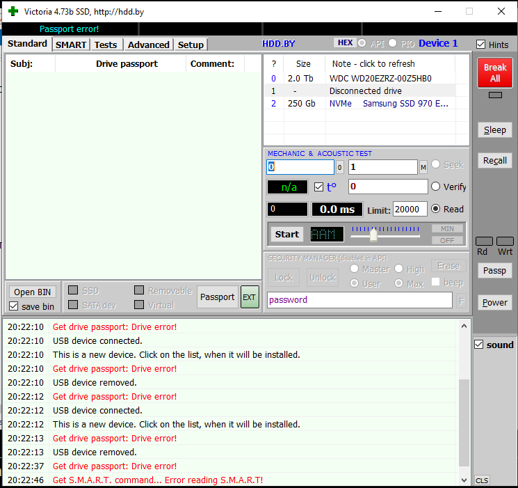

First two screenshots were made with 472b, the drive seem to be labelled "1 sec".
Last one I connected the drive via a SATA to USB external box and used the 473b
I couldn't find any such setting in my BIOS
As a possible symptom, every time I connect the drive (PC off), especially via SATA, the system takes ages to startup. A couple of time I even had to reset.

You connected the drive via usb and it was no good.
Now you have to connect the drive to a motherboard sata port and run Victoria again.
My fist attempt with Victoria 472b (fist two screenshots) were make with the drive connected via SATA directly to the motherboard
