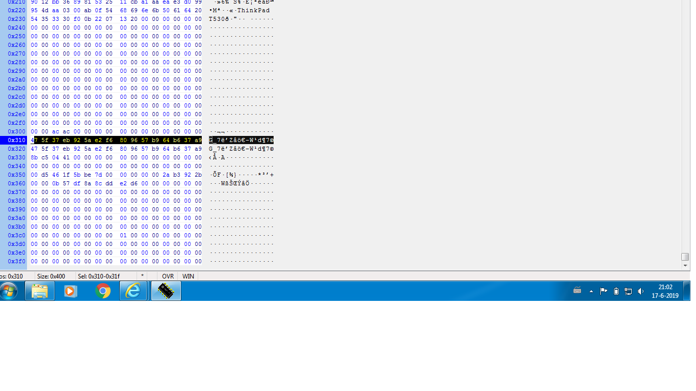

Ok,
i got some news, i have found the bios dump of the lenovo where this hdd is from.
The password from the laptop is on this dump (see picture) 2 same lines with encrypted password, i'm 99% sure this password is also the hdd password.
can i use this with victoria?

 Post subject: Re: Toshiba (lenovo) MK5061GSY ATA password unlock
PostPosted: June 17th, 2019, 18:02
Posts: 17228
zenelli wrote:
Ok,
I don't think so.
ThinkPad BIOS Password Design for UEFI:
http://monitor.espec.ws/files/lewnovo_password_399.pdf
PostPosted: June 17th, 2019, 18:41
Posts: 17228
If you have the original laptop, does this mean that the [unhashed] HDD password is known and that you are needing to circumvent the password because the laptop is dead? If so, have you tried the HDD in another Lenovo laptop?

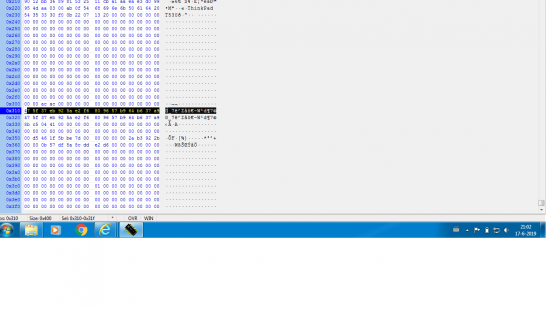

No i dont have this laptop anymore, and no i dont know the password. i bought this laptop long time ago with bios and hdd password, the bios password i could read it with special software and removed it (See picture of dump)
the hdd password is the same i think with the bios password
