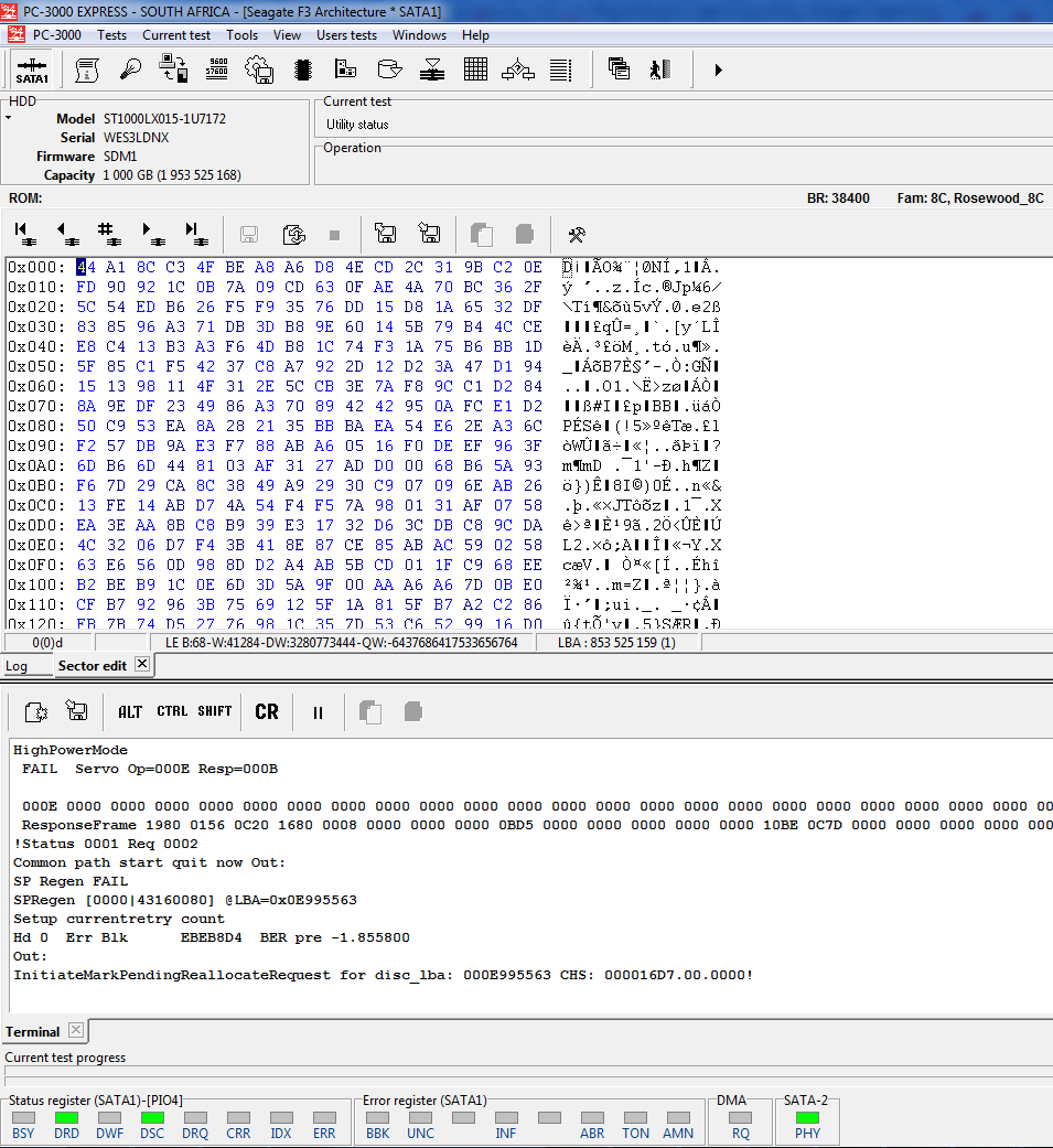

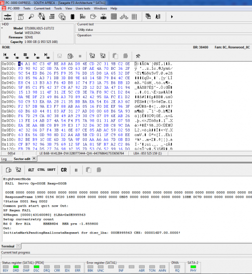

Is there a method available (publicly or privately) to patch the ROM on one of these? The drive in question is ST1000LX015-1U7172 family 8C.
PC3K currently unable to (obviously).

The drive does initialise, however there are some bad areas (perhaps even a weak head) for H0 according to terminal. I want to headmap this drive and perform some SA changes and establish preamp revision which is why I want to patch ROM.

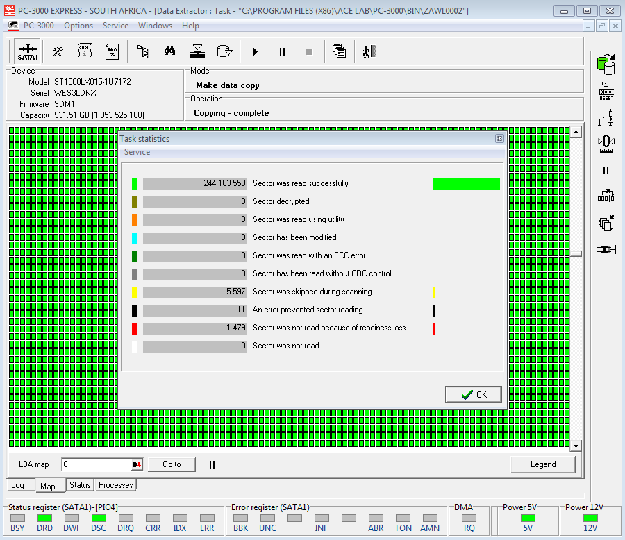

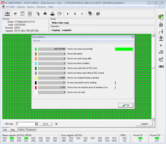

I managed to solve this without patching ROM by leaving the drive to 'settle' for a few hours and imaging it backwards with a long timeout and small block size, good result. Got lucky this time around.
