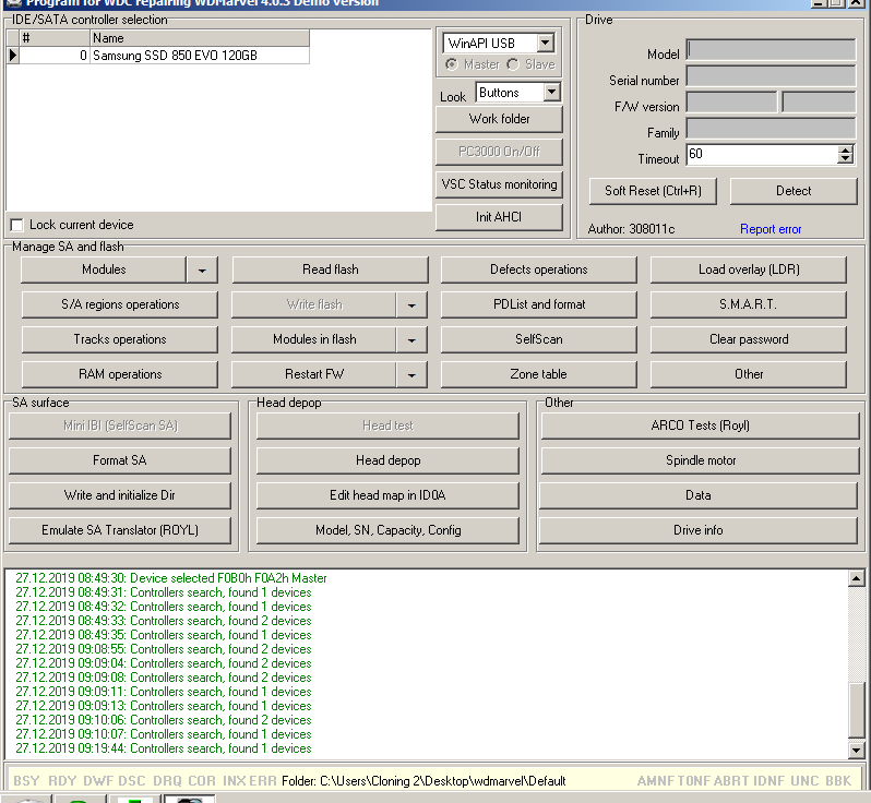

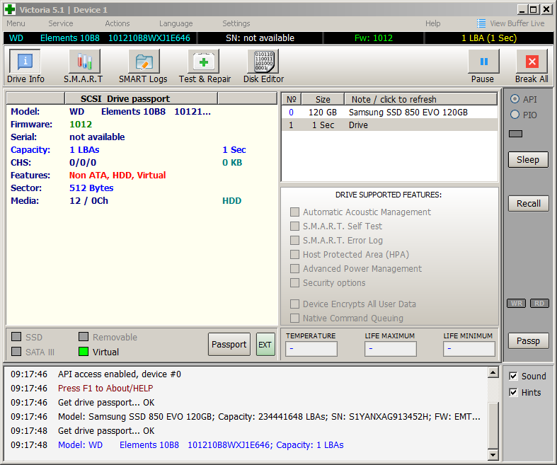

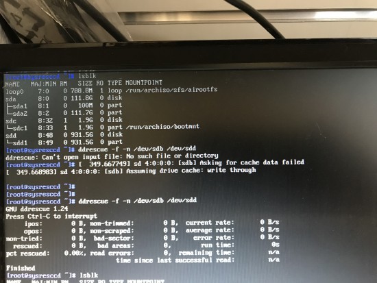

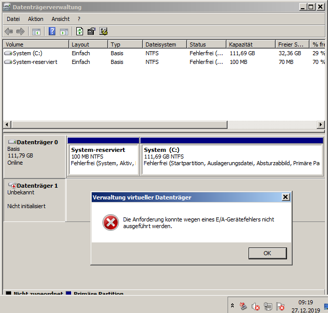

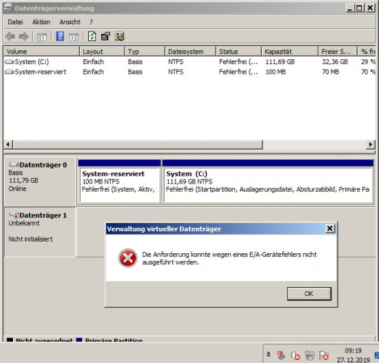

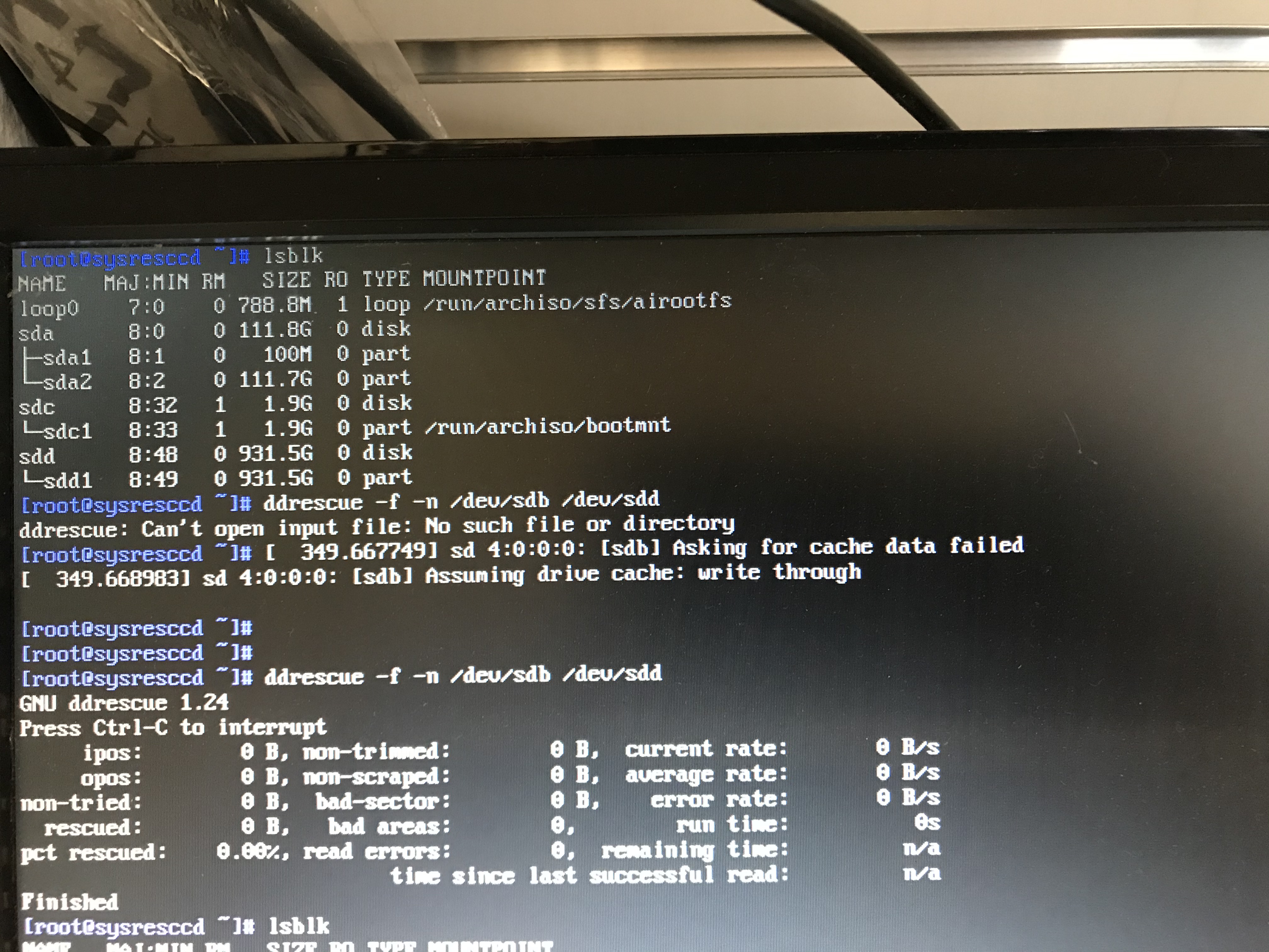

Hi there, I've some problems with a Western Elemtns 1TB 2,5" WDBUZG0010BBK.
Disk is shown in devmanager as WD Elemts...
Disk wont init by Diskmanagement -> E/A Error
After i plug the cable it starts to spin and make some noises (no clicking noises)
~20 seconds later the noise will end.
Victoria can see the disk, WDMarvel cant see the disk
DDRescue fail. Some Ideeas?
best regards
Fabian

If no clicking noises, probably head stuck...
Do you ear the platter spin? Or a beeping noise?
What the PC is detecting is the USB controller...

This is what u can hear...
Platter spins
i uploaded it to wetransfer... wav, m4a and mp3 is not allowed to post.
https://we.tl/t-n79qMKYGuf
when the noise ends, the platter still spin
best regards
Fabian
 Post subject: Re: WD 1TB WDBUZG0010BBK not init
PostPosted: December 28th, 2019, 14:01
Sounds like media damage to me, I expect there to be “dinks” on the platter surface(s).
