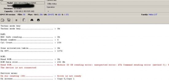

Spot the issue here..

ROM Data size is incorrect.
Angel Data Recovery
 Post subject: Re: Something you don`t see everyday
PostPosted: December 11th, 2019, 14:19
253Kb??
PostPosted: December 12th, 2019, 2:17
Posts: 2844
Its really strange,
Out & In util. again >> shows correct size.
3k glitch :mrgreen:

Sir ,
Always Advisable To keep old software versions at hand incase something does not work .These are 3 platters and 6 head drives which are pretty solid reliability wise .How was your presentation in the conference [ You always rock :D ]
