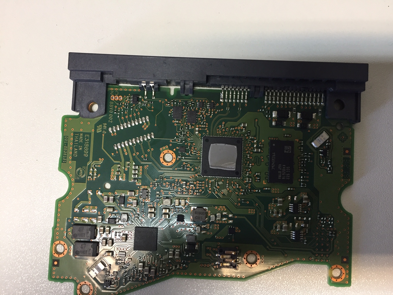

This is a photo of the pcb.
Can you point me where is rom chip or which chip to transfer?

 Post subject: Re: WD4003FRYZ-01F0DB0 PROBLEM WITH PCB
PostPosted: July 16th, 2020, 16:28
Posts: 17230
Did you check the fuses and TVS diodes?
There appear to be two ROMs located at the top left corner of the MCU in your photo.

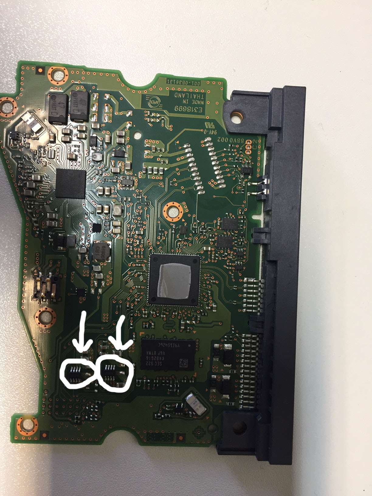

Hi all,
same problem here:
need to know if this is the chip to swap on new pcb??
PostPosted: October 30th, 2021, 14:25
Posts: 17230
atamoro wrote:
Hi all,
same problem here:
no
PostPosted: October 31st, 2021, 19:06
Posts: 489
Location: Usa
Yes I know it. recovered data before.
PCB no 0B36131
I have transfered both chips. And worked.
That chips smaller than common Rom chips. be carefull
chek this
https://www.data-medics.com/forum/threa ... -pcb.4027/
