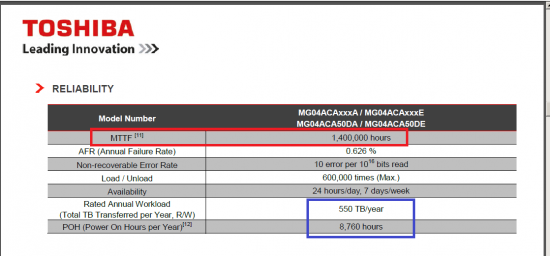

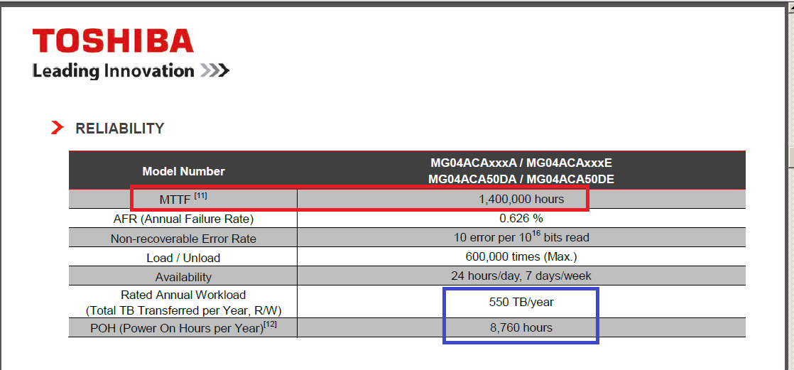

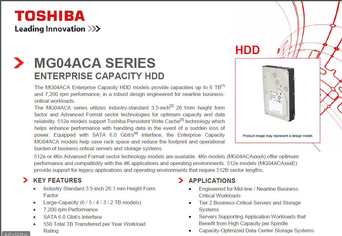

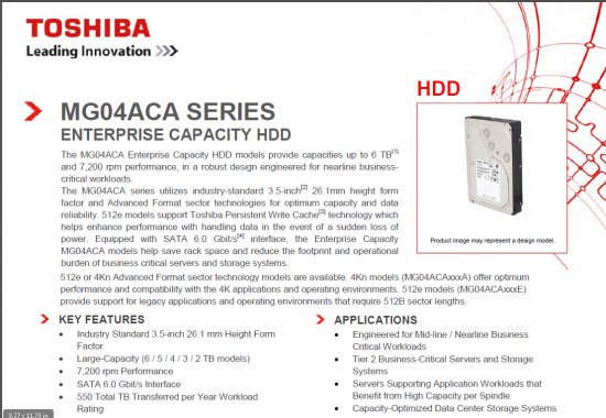

As hdd business is consolidated there is no trusted friend like Hitachi anymore.
As far as 3.5" I am very much satisfied with Toshiba Enterprise -- read the awesome specs .I am using Toshiba Enterprise over 5 years now an they are very much reliable.
My concern is for 2.5" internal SATA drives Unfortunately Toshiba is not upto the mark in this segment with more failure rates.
I am in a trivial state as of which drive to promote now -
WD Blue /Black etc - basic entry level with no reliability
Samsung -- not been sold as separate product now
Hitachi /HGST -- no more available.
Seagate ---- Dont sell.
Toshiba -- Internal not happy.
Now I want to suggest USB drive to some customers. I would like to know whether someone has worked on Toshiba Canvio Advanced USB 3.0 model ? These drives have 3 year warranty as compared to 2 years of internal SATA.
If someone has done head transplant then he might be able to give more details of internal build quality.
