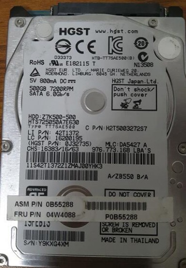

 Post subject: Help About Z7K500-500 unlock
PostPosted: December 21st, 2019, 0:01
Joined: May 14th, 2017, 7:14
Posts: 22
Location: china
[img]
[/img]
The disk, read ROM, fake DVR, but unlabeled. My understanding is still the user password, but it is not used on the computer. It should still be a hard drive that is replaced on the device. I don't know how to resolve the user password. Have you encountered such problems?

Solved, flash the BIN firmware, flash the higher version if there is a higher version, downgrade if not, and then unlock the user password.
