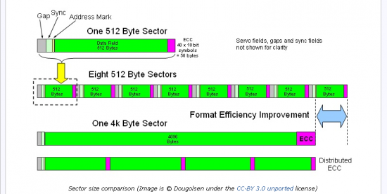

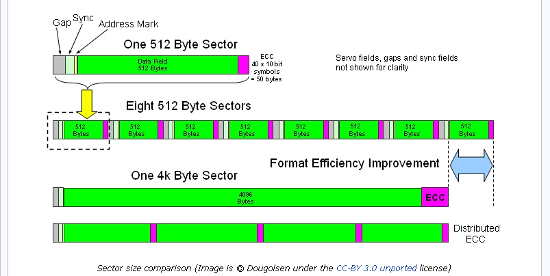

The terms 512N and 4kN describe physical sector sizes of HDDs—the smallest amount of data which can be written to or read from the drive. In other words, a 512N HDD has 512 byte sectors and a 4kN HDD has 4 kbyte sectors. Sometimes the 4kN drives are named AF-Drives (Advanced-Format-Drives).
4kN sectors were introduced to hold more data on the platters without bumping up the LBA (logical block addressing) scheme. Unfortunately, not all operating systems and applications were ready to deal with the larger 4kN sectors, especially when writing less than 4k bytes. To deal with that dilemma the HDD manufacturers invented 512e. A 512e HDD emulates an HDD controller with 8 sectors of 512 bytes and still uses a 4 kbyte physical sector. It looks like you’re talking to a 512N drive. This compatibility comes at a price. If not all 8 emulated sectors are updated by a write, then the HDD reads the 4k sector from the disk into a buffer, updates the changed emulated sector space and then writes the updated 4k sector back to disk. This means that a single 512 byte operation translates into two 4kN operations. Since a disk head can only do one thing at a time, either read or write, 512e takes at least two spindle rotations to write the data, where it is only required a single rotation for 512N. In case the write is outside the 4k alignment the same procedure turns out to take 4 rotations, further aggravating the delay. This occurs for example when a 1k write updates the last emulated sector of a 4k sector and the first sector of the next 4k sector in line.
here is another article
http://wp.xin.at/archives/2581

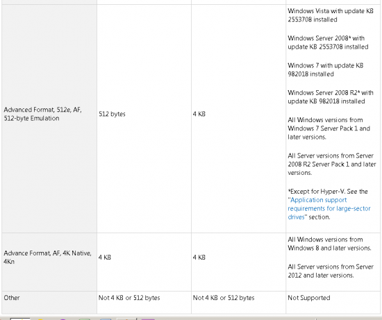

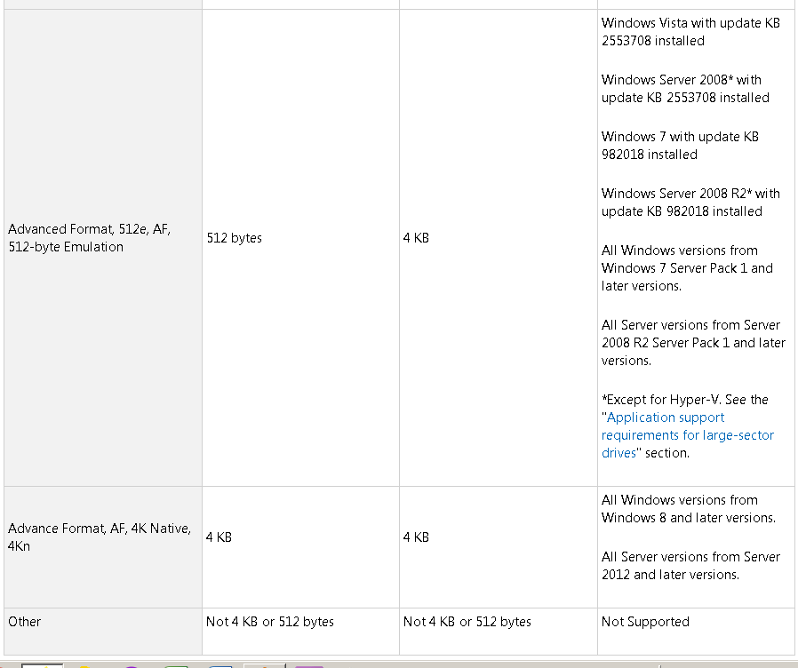

Hi Maximus
I am afriad this may not be entirely true ----------
NTFS file system is only logical part , if OS does not support 4KN (windows 7 comes under this) then this will be not truely 4KN system and earlier transfer issue will remain.
Read full MS view on 4KN support windows Versions -
https://support.microsoft.com/en-in/hel ... in-windows
