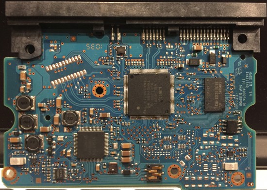

 Post subject: HDN724030ALE640 Spins up and shuts down
PostPosted: December 20th, 2019, 3:58
Joined: December 20th, 2019, 2:47
Posts: 6
Location: M83 Station 4
My 3TB HDN724030ALE640 Spins up and shuts down unless re-powered. There are no clicking sounds and it is not recognized. I removed the PCB and checked all of the large ceramic caps and diodes for shorts and the 2 fuses for opens. The only abnormal thing is (holding the connector in the up direction) a ceramic cap to the left, of the bottom of 3 vertical coils on the left side, reading 102 Ω.
So after reading the "see spot run" about checking the basics, can anyone help as to what might be the issue or what to check next. My first post here, be kind.
File comment: Borrowed from another post here

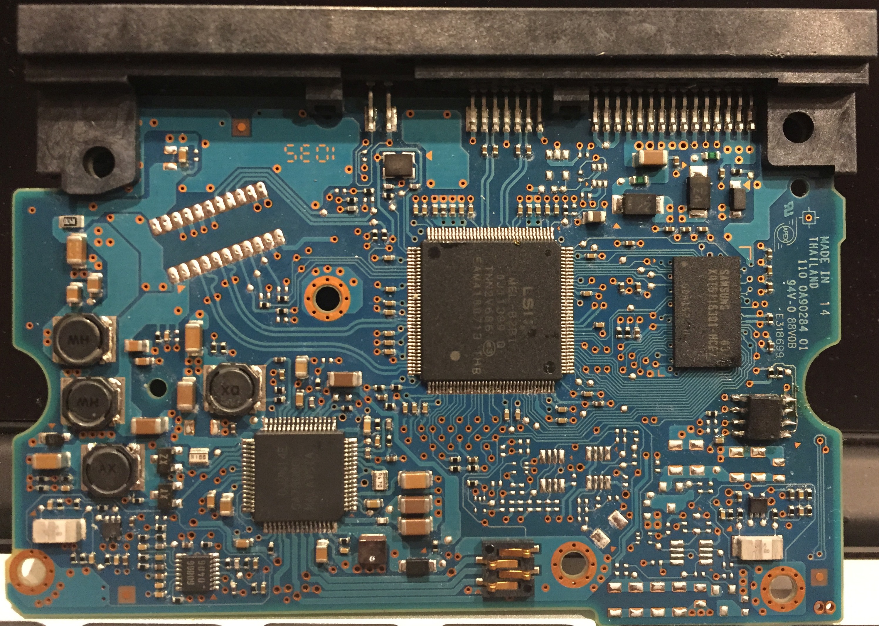

 Post subject: Re: HDN724030ALE640 Spins up and shuts down
PostPosted: December 20th, 2019, 5:14
Likely the PCB is ok.
The drive spins down likely because of mechanical and/or firmware problem.
When powered on, the drive is designed to attempt to read the firmware stored on the disk. If it fails, it spins down.

It looks like the "ROM" has been resoldered. Did you transfer it to a new PCB?

Please see the photo where it says "File comment: Borrowed from another post here" Not my photo.

On Hitachi drives there exist a module called NVRAM both in the flash chip on the PCB and on the platters. NVRAM is unique for each drive (includes the serial number) and if the two copies are different the drive spins down and reports an error. Otherwise it will try to read modules from the SA, keep spinning the platters...

When I did my research on this drives I made a full dump of SA and indeed there is a copy of NVRAM there. I never look for it so my bad. I have one copy at 3F0015385 and another one (before firmware update) at 3F0016BF2.
And yes fzabkar there are modules that are not listed in USAG and open list. They usually do not have any headers.
Unfortunately I don't remember what caused this drives to spin down after boot. In majority of cases if there is an error the drive does not "post" and keeps spinning.
My advice would be to create a loader using similar drive with the same firmware, try to read SA and go from there.
