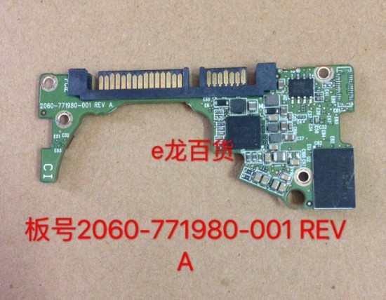

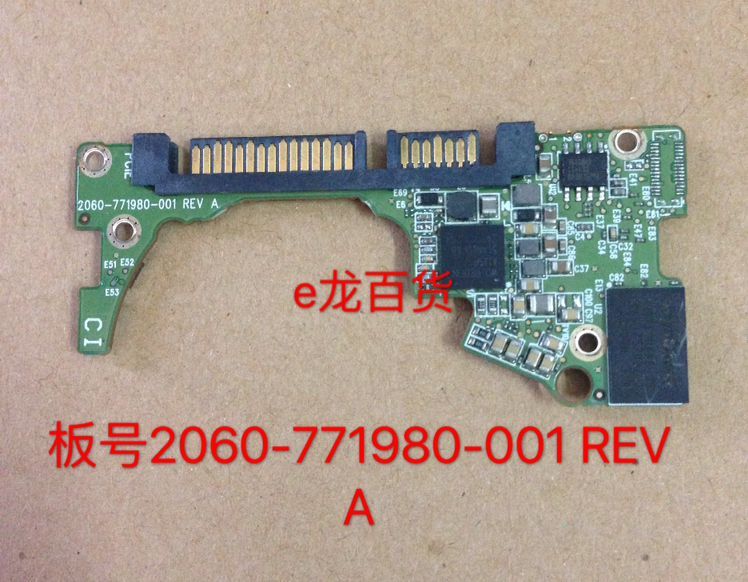

2060-771980-001 REV. A
Power Short 5V in PCB. Which to check?
is there 5V TVS or other?
 Post subject: Re: 2060-771980-001 REV. A Power Short
PostPosted: December 28th, 2019, 15:10
Posts: 17323
Examine these two components:
A clear photo would help.
PostPosted: December 29th, 2019, 10:48
Posts: 347
Location: india
No short in those components
PostPosted: December 29th, 2019, 16:52
Posts: 17323
Is there a short between SATA ground and SATA +5V?
PostPosted: December 29th, 2019, 23:58
Posts: 347
Location: india
YES
IN SATA POWER CONNECTOR 5V LINE SHORTED
