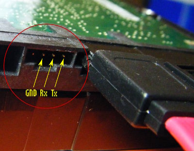

I am not a professional but I do like to tinker..
I have one of my hard drives (data drive, not OS drive) that I have to hit F2 for the pc to boot as it is reporting smart errors. I have since replaced the drive.
FYI, the drive responds to a "long format" with no errors reported, as well as a few HD utilities I have ran on the drive excluding smart errors (relocated sectors, 36, the only smart error)
I am having a problem connecting to the drive via serial (ttl) interface.. Maybe the interface on the drive is non-working.. Or maybe I do not have the right connector and my connections are "iffy" at best because I am "Rube Goldberg'ing" the connection.
What type of connector can I buy that fits the serial interface on the drive?
I have searched for "4 pin, 2mm" and a bunch of others and I can not find the correct connector.
Can someone tell me what exact connector to buy?
As said, it is my drive. I do not intent to sell it to an unsuspector.. Just playing with the drive.
All that said.. I am in the US and if someone wants the drive(s) for parts, I will send it to one of you guys for parts for no charge except for postage (USPS flat rate). I do not want to ship internationally so US only.
I actually have two drives.. One will not take a long format, the other one is the drive I am talking about.
Drive 1 (won't long format):
Seagate ST31000520AS, Firmware CC32, Date Code 11053
Drive 2 (the one that works perfectly excluding the smart errors as I said above):
Seagate ST3100052AS, Firmware CC38, Date Code 10436
If someone could tell me the exact 4 pin connector to fit the serial interface, I would be most appreciative..

All the TTL adapters I have seen come with individual connectors for each pin.

I get it.. But my "wires" are too large to connect to the itty-bitty pins.. After taking off the plastic doo-dads over the actual metal connector..
I have crimped them so they connect but if not careful, they will tilt / twist and one pin can touch the other which is not ideal..
I have seen these connectors used on PC sound boards back in the day.. Just can not find one now..

Use heatshrink tubing to insulate the pins.

Yikes! I never thought of that.. Still though, there must be a connector you can buy to fit the "port" on the HD which is my goal..

Take some measurements (eg pitch and pin diameter) and look for a "Single Row Female Housing".
ISTM that the pitch is 2.2mm.

Just a follow up..
Using shrink tubing on the itty-bitty wire connectors did the trick. I was able to crimp the female connectors and I got a nice tight connection with no worries of the terminals touching each other with covering the female connectors with shrink tubing..
A question for my own need to know..
Is there a time limit (after powering up the drive) to get it to respond to the ctrl-z command??
At first I got no response so I thought I may have tx & rx mixed up. Change them with still no response. Put them back the way I thought they should be with still no response and then magically, I got into terminal mode after hitting ctrl-z a few times.
