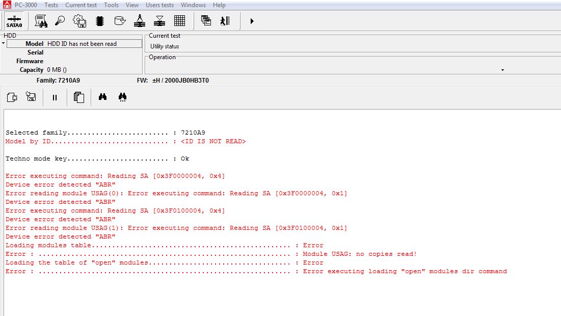

Drive comes ready and displays log in pic below. Though I can hear a quick soft click during init, I did not experience any loud clicking that client reported. This click has persisted after all diagnostic steps.

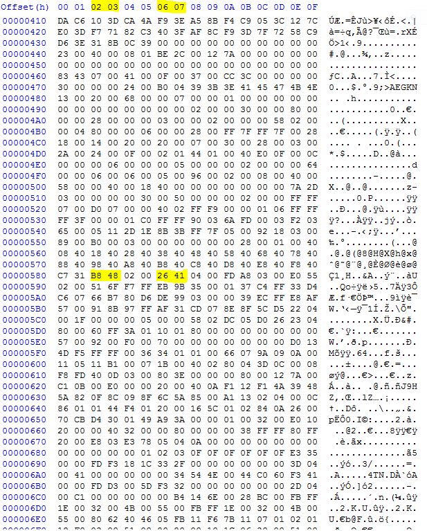

Though NVRAM has several unique sections, through analysis with a few testers (of only this model) I've found that the 4 highlighted bytes are all that need to move with the drive in order for it to initialize.
With that in mind, I've patched patient NVRAM with only these 4 bytes from donor NVRAM, and donor initializes with full capacity and sector access (though probably limited).
All I can speculate at this point is that the mentioned 4 bytes in NVRAM are the actual pointers to the directory module and this somehow became corrupted, or the pointer is ok and USAG is corrupt in some way. Not sure how to proceed at this point--would appreciate any ideas.

samick wrote:
-Patient heads work in 2 donors.
so problem is not with heads , service has problem, have you tried LDR ?
