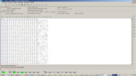

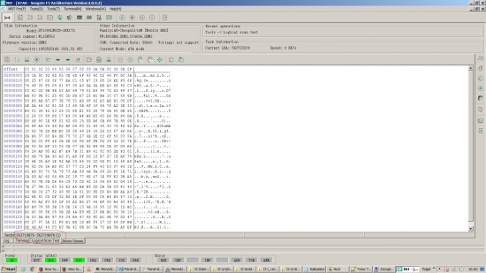

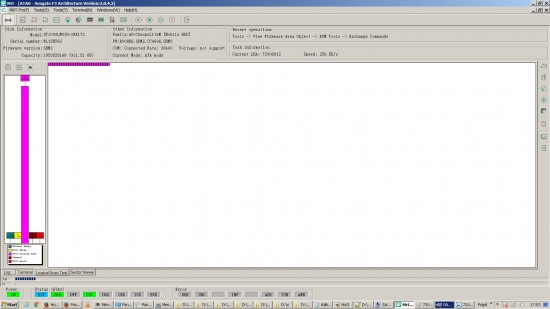

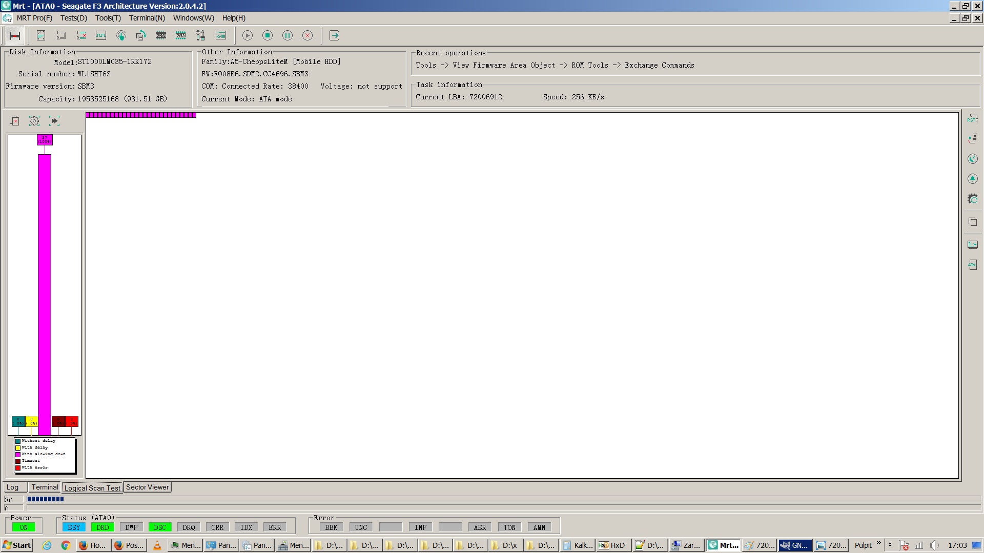

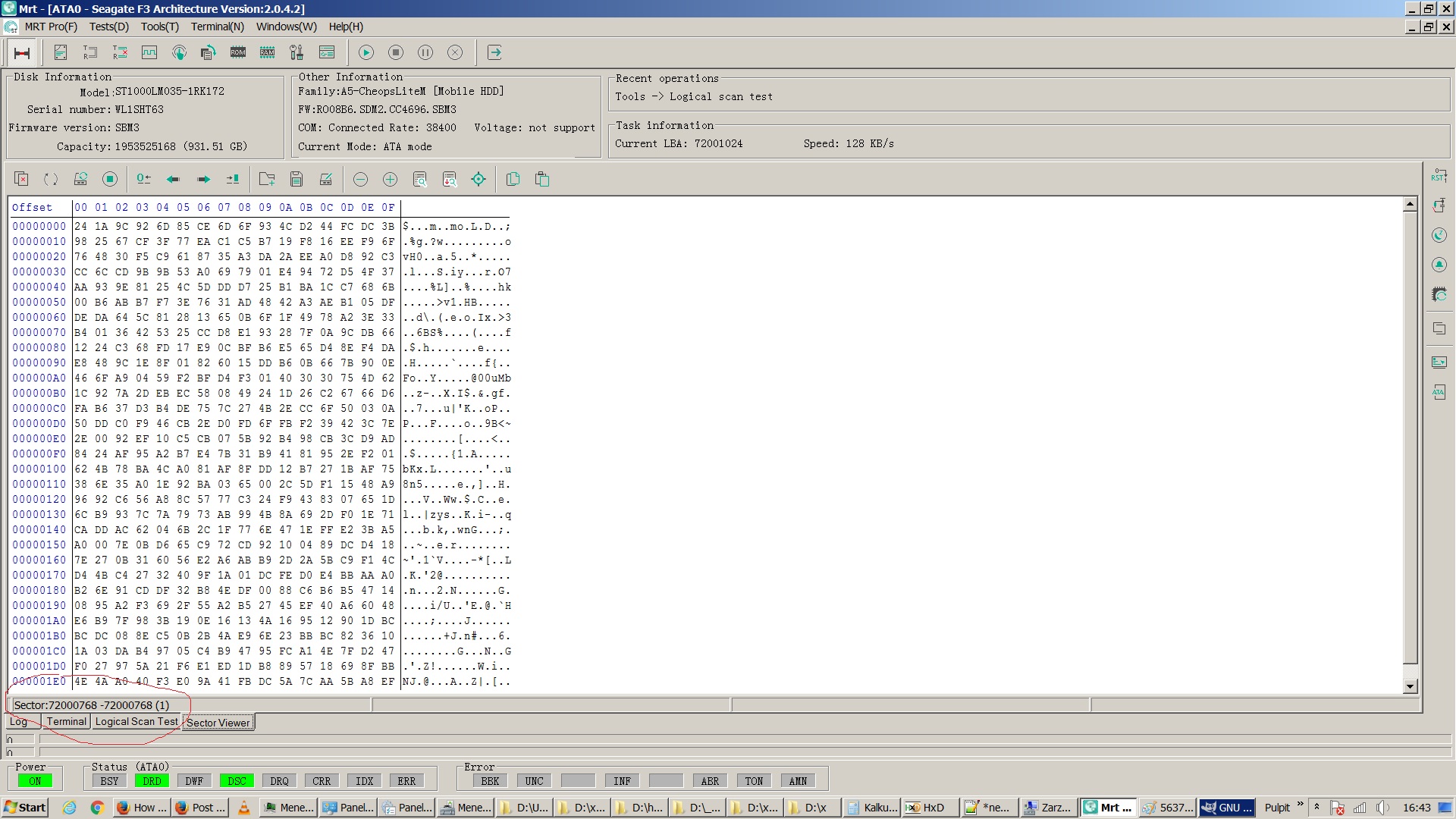

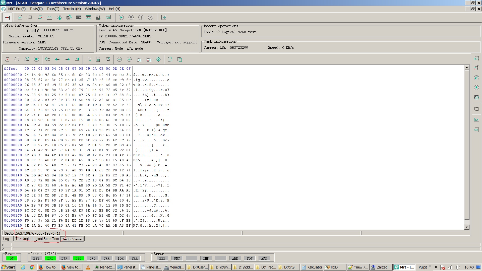

Hi
Half of its LBAs are readable, most of them with full speed, the other half is readable but very slow and shows the same content for all its sectors.
Is it possible that one head is damaged even though it returns 'something' (the same content - cache ?) and not returning ERR ?

 Post subject: Re: ST1000LM035 , damaged head ?
PostPosted: January 7th, 2020, 13:38
Posts: 1742
At least 25~30 % of data has gone.
PostPosted: January 8th, 2020, 0:54
Joined: February 2nd, 2019, 1:21
Posts: 192
Location: Sri Lanka
If you have same content of this seagate series in one head, most of time you should swap the heads.
PostPosted: January 8th, 2020, 10:25
Posts: 1777
Location: Phoenix, AZ USA
Do you have good data from the other parts of the drive?
If this area is contiguous to the end of the drive, it may have been previously wiped with the same code in each sector.

In every 'bad area':
1. the same content
2. very slow access.
Can't imagine anyone writing only to slow sectors.
data recovery Poland
