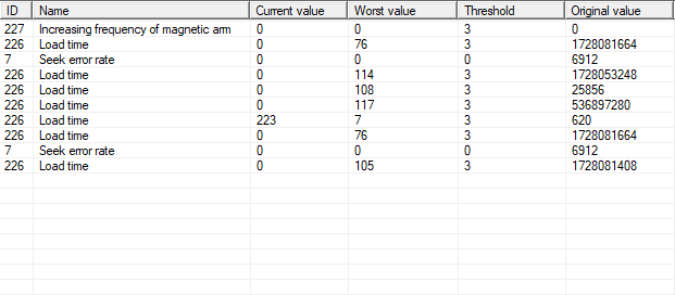

Hello Guys,
i have a case maybe you guys can figure me out the solution.
Model: WD80EFZX-68VW8N0
P/N: 2W10102
PCB: 006-0A90439
Issue: Hard Drive spinning good and gets ready in a while with Proper ID & Capacity (Family Unknown/Not supported). But, when we try to access the sectors it gets busy again.
Hope to see your revert soon.
Thank you

Can you access the SMART data?
Does the drive allow setting the ERC timeout parameters?
You might like to try the new "Rebuild Assist" feature set, if properly supported:
Yes
No

In this architecture, the PCB will give identification information separately from the germoblock. In your case, most likely the service area is not read. Maybe partlly. There are no public methods for working with them. They are not supported either in PC3K, or in MRT, or elsewhere.
There are some developments: ROM, loader, service structure, some service commands. Everything is designed for a relatively serviceable drive with live heads and service area.

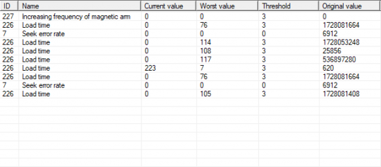

Does SMART data full? I have a PCB. It gives identification data and partially SMART separately from... HDA. 5-6 attributes, it seems. SMART data, of course, is complete nonsense.

That's interesting. I suppose the following SMART attributes could be reported without access to the SA (current values only):
    spin-up time
    temperature
    helium level

Yes, I can read this information.
But trying few attempts after reading lot of threads, still no luck.
anyone solved this kind of case earlier?
