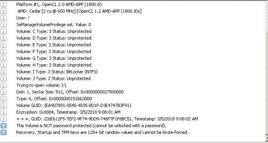

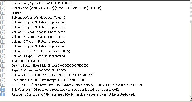

I have got a SSD for data recovery , laptop was booting due to some OS issue.
I cloned SSD on another disk .Initially it was showing unallocated space. I have recovered 2 volume (service partition FAT32 unlocked and main OS volume)
It is showing Bitlocer encryption. However customer says they have not enabled bitlocker.
When I run Manage-bde -protectors , I get No protectors found. This volume is not protected using password. How Can I identify whether Key was stored in TPM ?
I dont have access to original laptop.

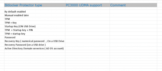

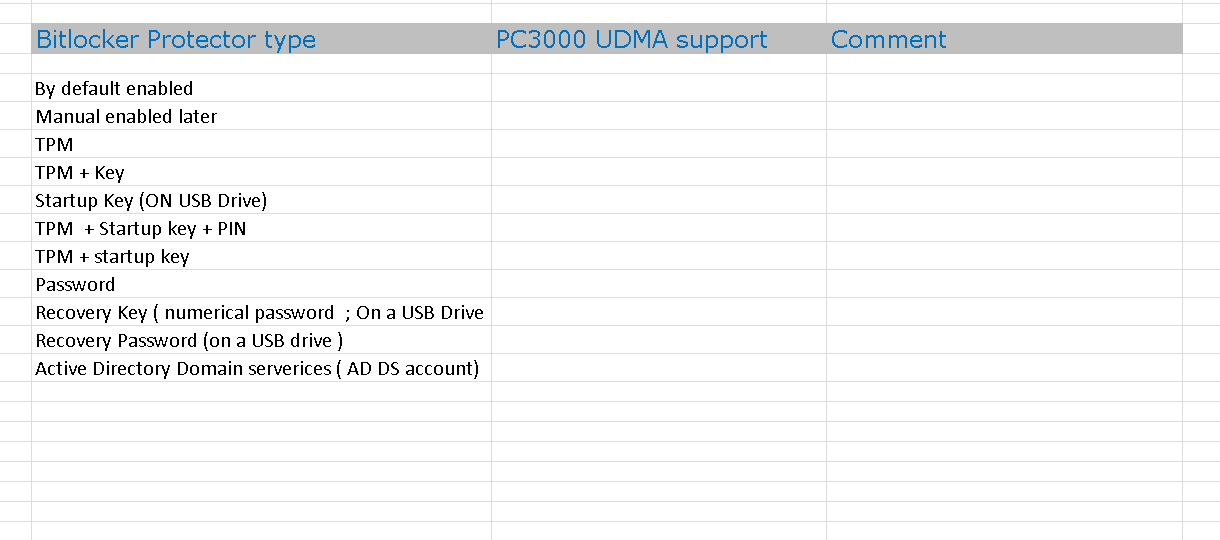

We have PC3000 udma , latest data extractor supports auto decryption of Bitlocker though it works in some particular cases where bitlocker was enabled by default and not activated later manually.
Can someone give us more details as in which cases UDMA can decrypt bitlocker without key /password ? That will help larger community.
Unfortunately I have not updated TS so I have older version of DE.
Here is excel file I have created if someone could just put his observtions that will really help.
download link -- https://drive.google.com/file/d/1CJrgSf ... sp=sharing

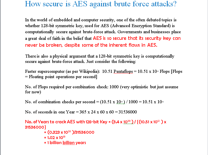

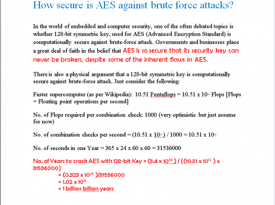

I am confused as I was of opinion that AES 128 which bitlocker uses is so secure that its US govt. official standard for confidential clasified data.
Then how its possible that even without even key this can be cracked ?
Someone pls. explain as otherwise whole security system is flawed We can no longer suggest AES as a secure standard for there data security.
