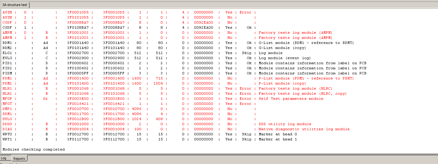

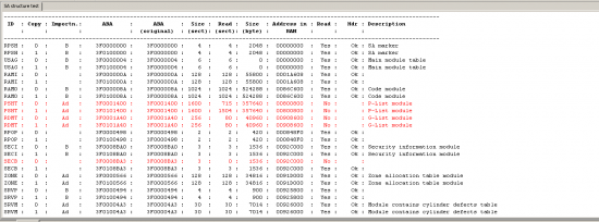

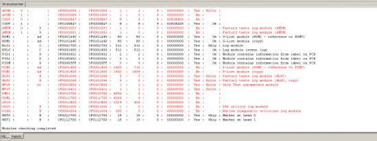

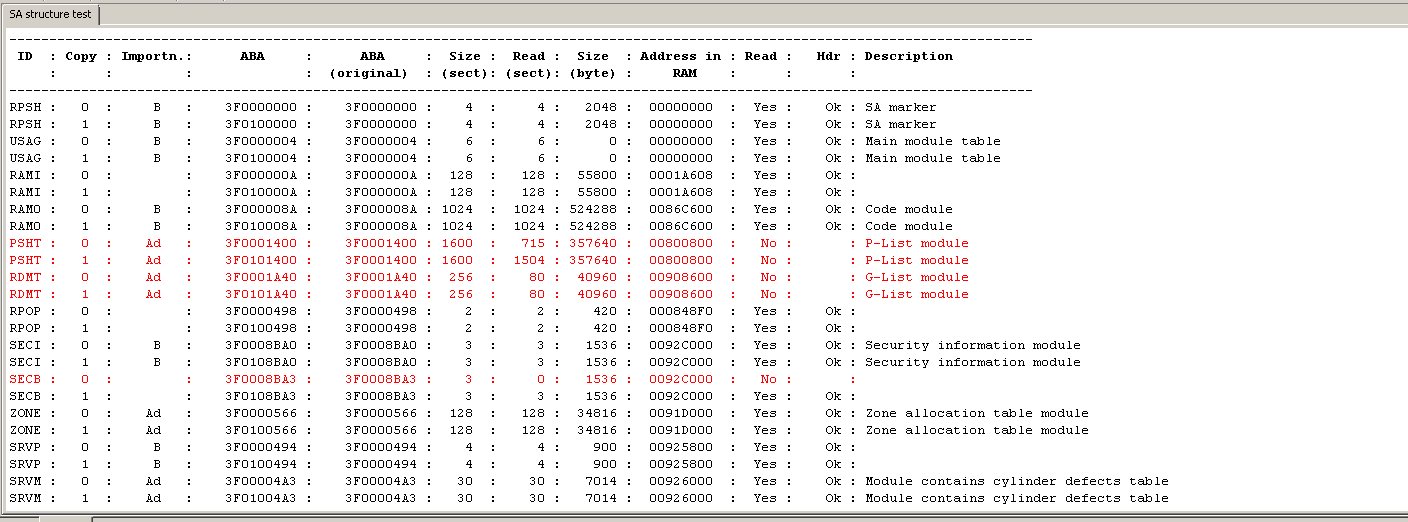

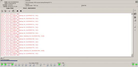

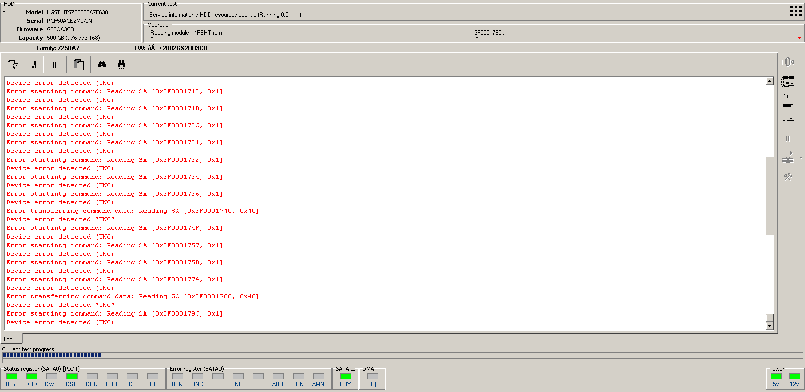

For past few days I am struggling with HGST HTS725050A7E630 hard disk.
It has defects in SA so I cant read P list (PSHT & RDMT ). While imaging disk gives lots of read errors. I have twice replaced heads (healthy ) in hope that with newer heads I might get better results. I have repaired both files as per procedure and have created translator in Ram giving path of these repaired files. However despite all this there is no difference in symptoms .
I think reallocating SA in spare sector might be the solution ,but I dont know how to do that. Can someone pls. suggest any alternate way
I have attached both PSHT and RDMT files (original as well as repaired ) .Can someone familiar with hitachi check them for any errors which is causing read errors?

the drive does not load a damaged PSHT, so you won't get too much sectors, maybe some million from the beginning.
your PSHT is damaged near the end, that area is not important, so just upload it to ram using pc3k feature.

that psht does not look very damaged, it is normal that the drive does not load it on its own but it should work with it if loaded manually.
So i think there is some other problem, like one of the heads being weak or surface damage...
