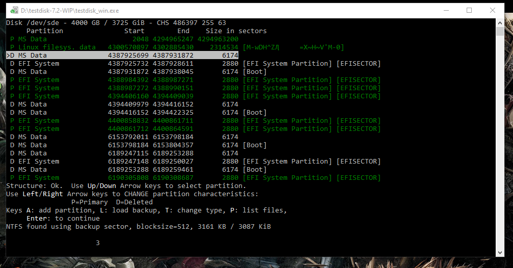

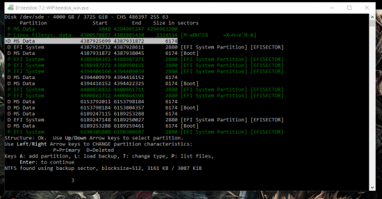

I've had this 4TB with me for a few years and had this go bad on me in early 2019. I decided to try to look into what was causing the errors in the hope to recover the drive with the data.
Ran an analyze on this drive with testdisk and took a few days to finish. Is this drive toast based on the bad partitions or how would I go about fixing them with the options in TD?
Thank you for any help.

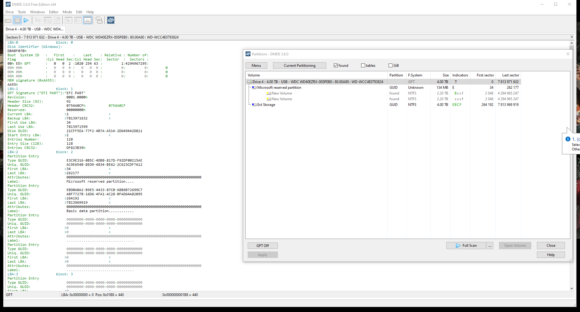

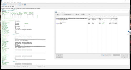

Thank you for the response. I installed DMDE and here is what's in the partition window. Should i do a full scan?

If you double-click the Ext Storage volume and expand the Root, do you see your file/folder structure?

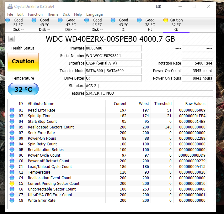

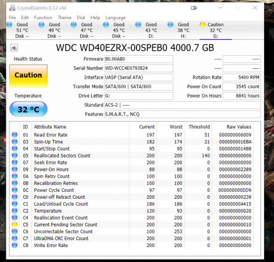

You can get an idea of the physical state of your HDD with a SMART tool such as CrystalDiskInfo. Look for reallocated, pending or uncorrectable sectors.
I would not perform a full scan. You should probably clone your drive, especially if it has physical problems. Alternatively, if you only need a few files, then you could recover them directly with DMDE, to another drive, of course.

I do see the file/folder structure yes. I don't see my pictures folder though:(
Here's the smart status:

Your drive is sick (Read Error Rate and Current Pending Sector Count). You would be best advised to clone it, then work on the clone.
