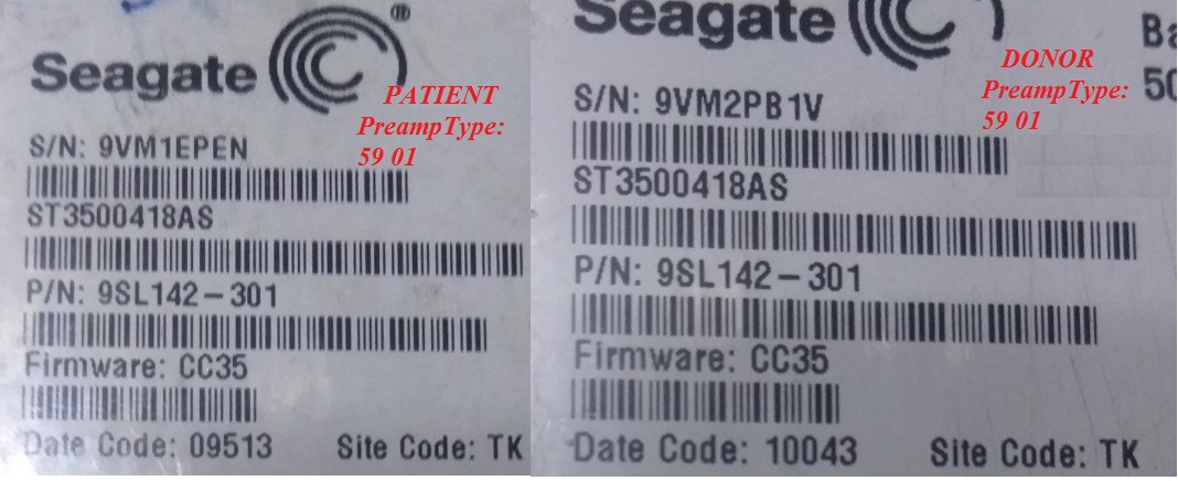

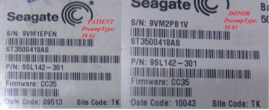

HDD INFO

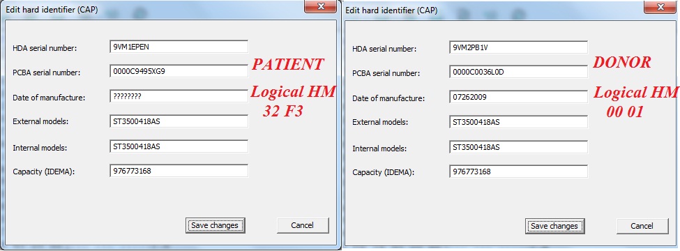

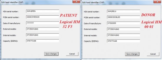

HDD-ID IN MRT

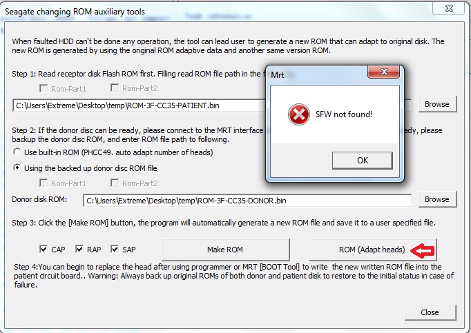

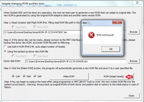

When try to change adaptives I am getting this error in MRT
QUESTION
1. is donor ok?
2. how to transfer adaptives?

It would appear that MRT is looking for the patient's head map in the wrong place. :-?
ROM-3F-CC35-PATIENT.bin
Offset(h) 00       04       08       0C
0007E490  00010215 00010215 32F30010 3FFDF60B
ROM-3F-CC35-DONOR.bin
0007E490  00010215 00010215 F6F20010 2700A000
