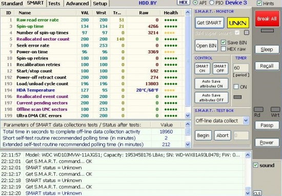

I'm currently running a scan with Victoria (4.73b) on a WD Elements external hard drive (WDBUZG0010BBK-03). It's a mechanical drive, but has the USB 3.0 connector directly on the drive board, no intermediate SATA USB board like on some other external drives. So I'm running the scan through USB 2.0 (my PC is an older Dell 755, and only has USB 2, not 3).

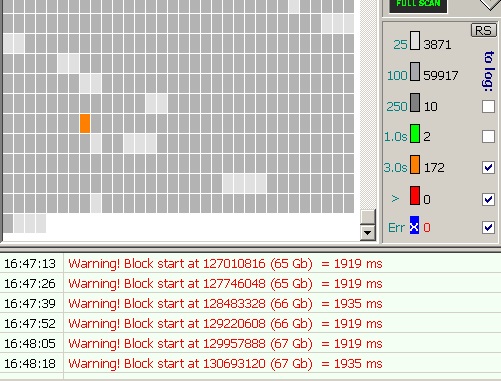

Anyway, Victoria reports the SMART data, and it looks ok (see attachment 1), but during the scan (at 6% currently), I'm getting "3.0s" (orange) errors, no red ones yet.
Curiously, the orange errors seem to be occurring at fairly regular intervals. When I was initially checking the interval, maybe 4 times out of 5 it was exactly 716800. As the scan has progressed, the intervals have changed, but are still in the range of 710000 to 730000.
Is this something to do with formatting, or manufacture of the drive surface that I'm seeing an interval like this?
If there were "true" bad blocks, wouldn't it be more random?

The drive is most likely suffering from the WD "slow responding" issue. This means that there is most likely a bad sector somewhere, even if smart does not show it. If you are trying to recover data, I show that someone has successfully fixed the slow issue using HDDSuperTool on this exact model. But that is only a temporary fix to get data, it does not fix the fact that something is wrong with it.
If you are trying to reuse the drive, even if you fix the slow issue, you should never trust this drive again with valuable data. It could suddenly develop severe issues at any time.

If the drive is scanning good now on another PC, then something weird was going on. Whatever was going on, it was happening every 13 seconds and took nearly 2 seconds to process. The big question is, was it a system/program issue, or was it the drive itself that was causing it.

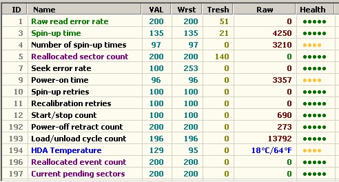

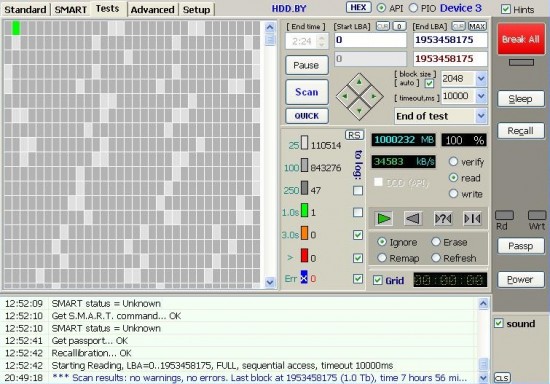

Alright, that scan finished. I've attached the smart and scan snaps.
The SMART data is similar to before, though I notice that the status (top right) says "UNKN"; is that because it's connected via USB?
Also, you can see that there were no orange or red blocks found this time, just the one green block, the second block, and the rest greys. This is the scan preformed on the Dell GX260, with WinXP.
The cable is 3 meters long. And in both cases, I was attaching the cable to the front panel USB ports, USB 2.0.
I've now transferred the drive and cable back to the Dell 755, Win7, and have started another scan, and less than 0.5% into the scan, I'm again seeing orange blocks every 13 seconds, for almost two seconds. It started pretty much immediately.
So this is quite confusing!
Any suggestions on what to try next? I have a few other Win7 installations on laptops that I could try, and a Win10 for a GX620. I also have a Linux Mint drive somewhere, are there any good tools on Linux that I could run a scan test with?

I don't know these "new" drives, but your cable seem very too much long, and maybe damaged as you said.
I suggest you trying with another, the most tiny you can, max long 50cm with a big diameter.
Then not all USB ports are very effective sometimes, try plug it at one to the rear.
Also "old" machine or laptop can have less effective USB ports, and the 3m cable will not help...
The drive is surely fine if it have works without orange in one machine. (and the SMART say it is fine)
These orange can be caused by an running process that try access the USB.
Don't worry about the one green that is nothing. (try doing erase pass on it)
But all your 100ms gray can be suspect, but it's surely because of the USB. (or maybe caused by the 2048 block, select 512 instead)
So I suggest you stopping all before your drive "false tilt" bad sector.
Find a new cable, plug to rear, full write the drive (+write LBA num option), and then redone your full read scan.

+1 for the cable being too long. I have had issues with cable length over 1m, shorter is better. Not sure if that is the cause or not.
If you want to rule out the operating system, try using Hiren's Boot CD so you are using an OS that should not have any background processes running. The older version 15.2 includes Victoria. The newer Windows 10 PE version does not have Victoria, but it does have HDDScan which looks similar enough for what you are doing.
