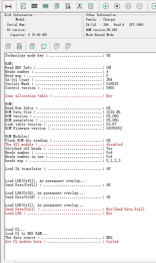

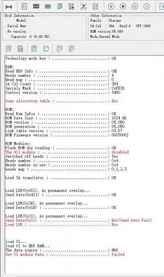

I upload the MRR of MRTLAB for this HDD.
Now the problem is that I don't get modules 01 and 02.

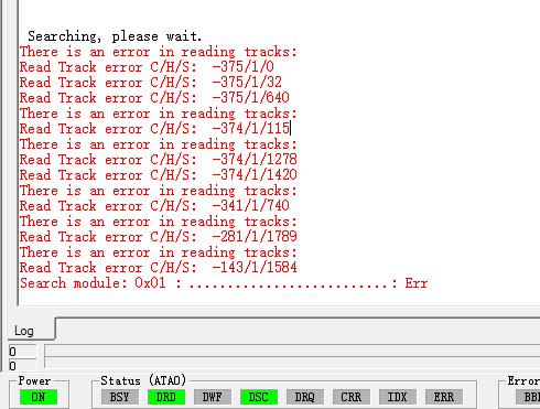

Cannot find modules 01 and 02
 Post subject: Re: I need LDR for WD20SMZW-11YFCS0
PostPosted: November 21st, 2019, 5:12
Posts: 474
Location: spain
Save Path:D:\MRTDATA\WDC Marvell\Charger\WDC WD20SPZX-22UA7T0-01.01A01-WD-WXL1E884ZR8U-0006002T\Data\Modules_SearchByTracks\
NN : Module ID : Cyl / Head / Sec : ABA : Length
1 : 0001 : -375 / 0 / 0000 : 0 : 32
I tried with another palmer.
The SA is damaged in the module area 0x01.
I have to find a copy of the firmware in order to continue.
