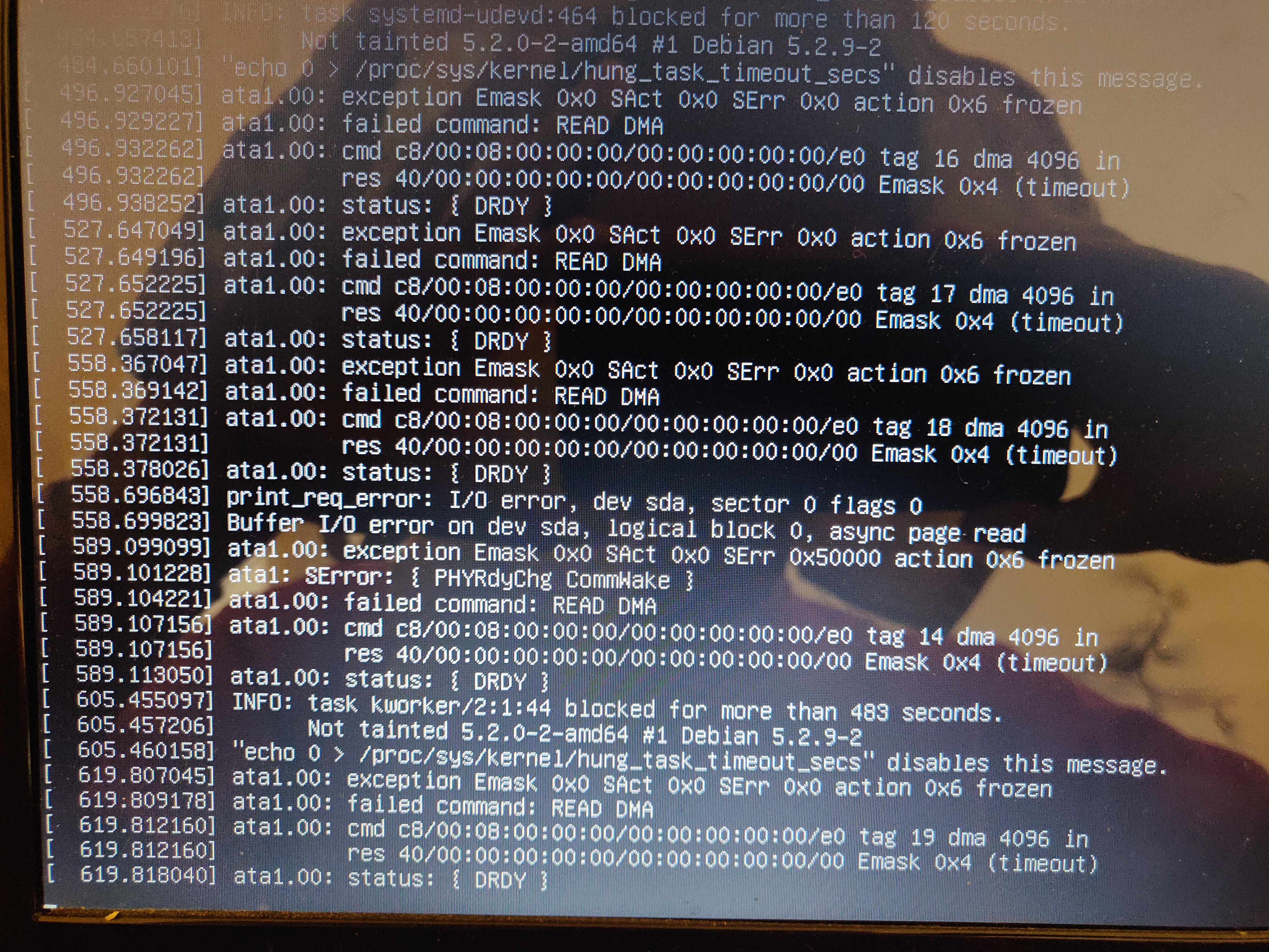

I have broken disk which spins normaly and is shown in BIOS but if I:
-connected on motherboard SATA and then try to boot using live linux or other OS->infinity boot (see attached pic)

What do you think is head or pcb broken or do I have bad sectors?
Thank you for your help
File comment: Linux boot error

High chance of bad sectors... Bad/weak head probably.
in terminal you can check SMART like this:
/1
N5
What does it show? Could you post here?

I think the drive is healthy.
Something logical is more likely to be going on.
No, clearing the g-list is not a good idea.
