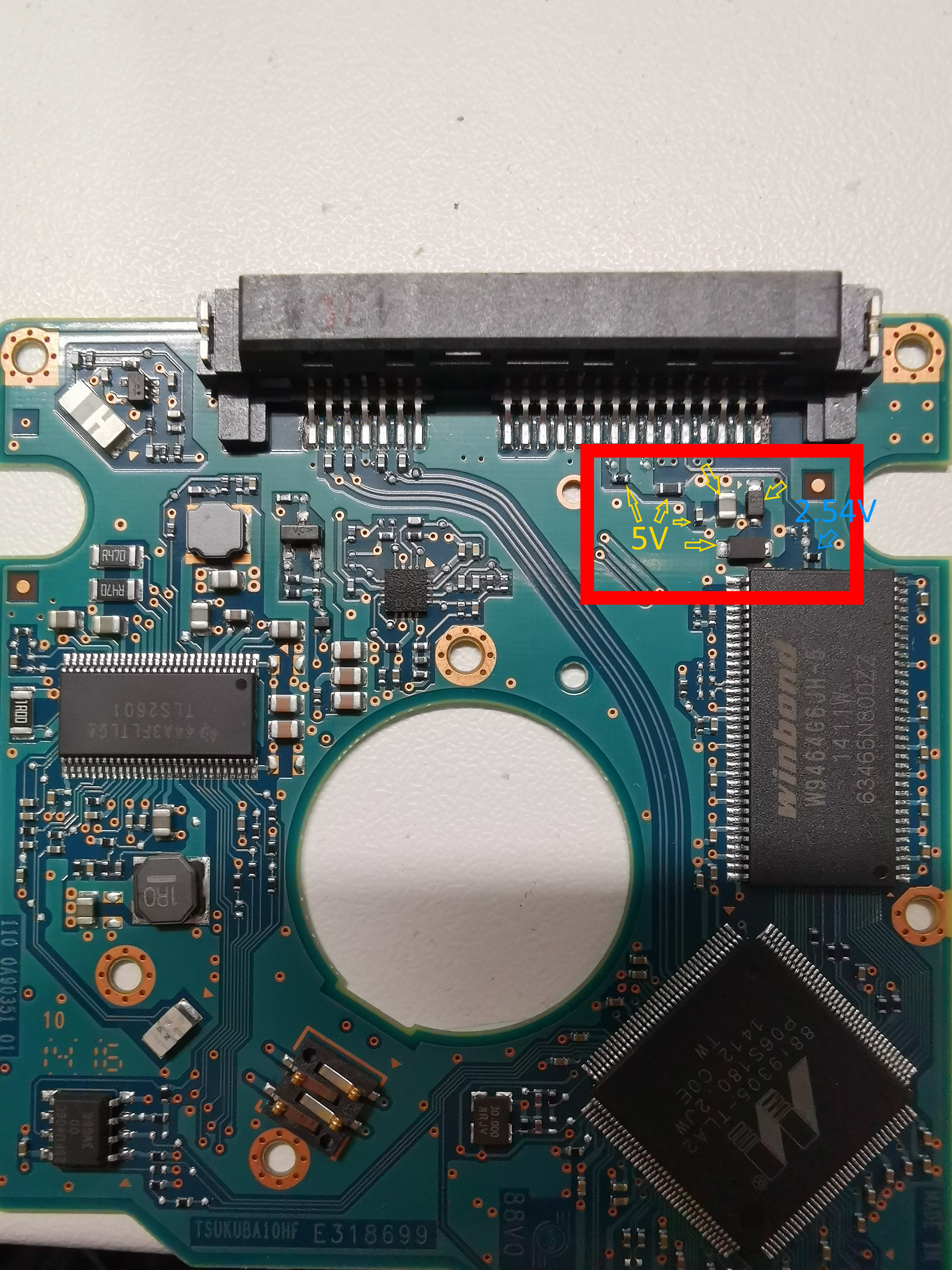

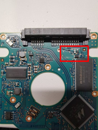

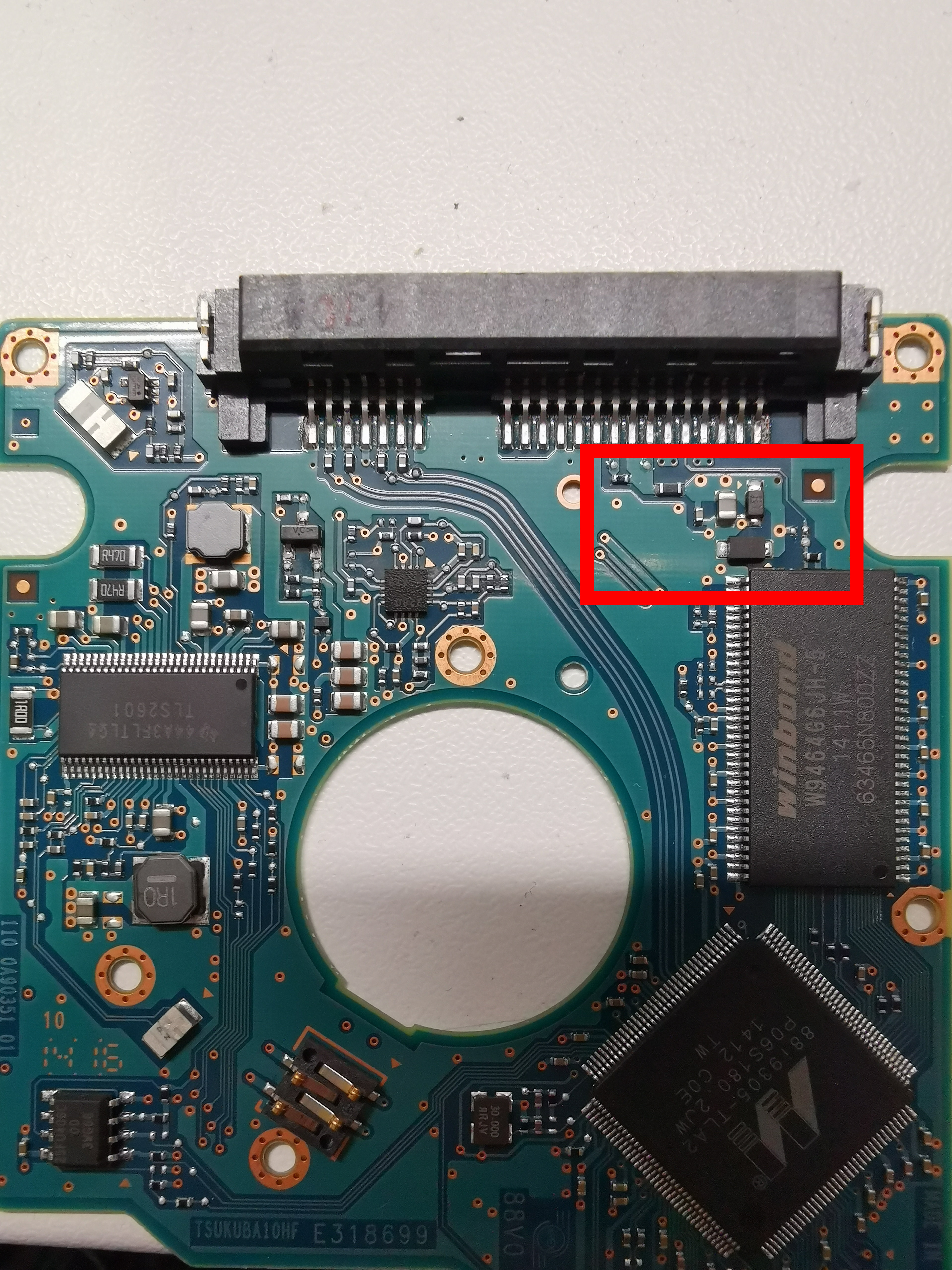

Check the 5V TVS diode and fuse(s) near the SATA power connector.

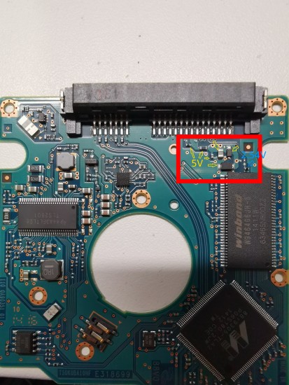

Thank you for your reply. Do you talking about this part ? Thank angain

Here is a picture with differents values. 5V seems to be ok :/

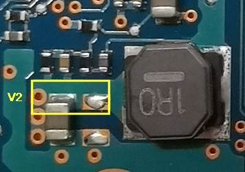

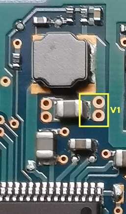

Re: HGST 1TB = nothing
January 23rd, 2020, 17:13
Measure the voltages at the two inductors above and below the motor controller IC. They should be Vcore and Vio.
I'm assuming there is absolutely no sound coming from the HDD, otherwise it could be a spindle motor or stiction fault.
Some Hitachi models suffer from NVRAM "corruption" (25FU406C, 8-pin IC). I don't know whether yours is one of these.
There may be an internal fault, eg preamp or heads, which may cause the ROM firmware to fail its POST. I'm not a data recovery professional, so others would be best to advise you.

fzabkar wrote:Measure the voltages at the two inductors above and below the motor controller IC. They should be Vcore and Vio.
If you wish to try for a PCB swap, then you would need to transfer the ROM/NVRAM to your donor PCB. Some PCB suppliers include such a service in the price, eg ...
https://www.hdd-parts.com/13022903.html
i have 2.36V on twice . I don't know if it's correct values or not ?
How can i know if it's a corruption of the NVRAM ? And if i understand, the 25FU406C is the IC that i need to transfer on a new PCB right ? Have it other thing to do ? I have soldering skills and material for doing that.

There should be two distinct voltages.
Vcore should be around 1.2V or less.
Vio should match the requirements of the "ROM" and SDRAM.
If both voltages really are identical, then this would suggest that there is a short between these two rails within the Marvell MCU.

Both are identical. I'll check if i find something wrong but i'm too newbie to do that by myself i think. Do you have any advice or tips to help me please?

Can you perform one last test? Measure the resistance between V1 and V2. If it is 0, then this would confirm the existance of a short within the MCU. Also perform the same voltage checks on your replacement PCB.

i have 2.54V on V1 and 0.876 on V2. It's seems to be ok ?

the measure between V1 and V2 aren't 0. It's .510 so i think it's ok ? It's not necessary to change PCB ?
