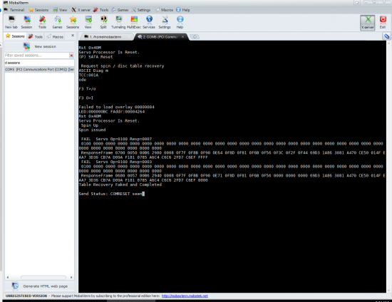

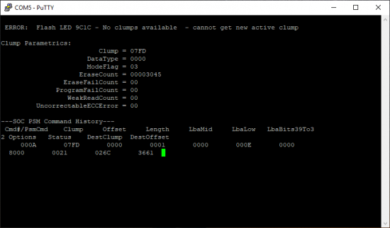

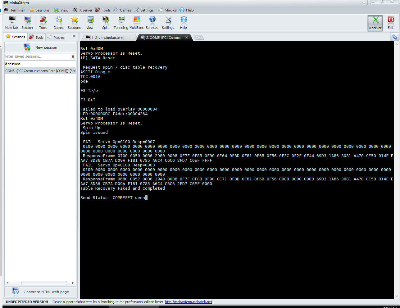

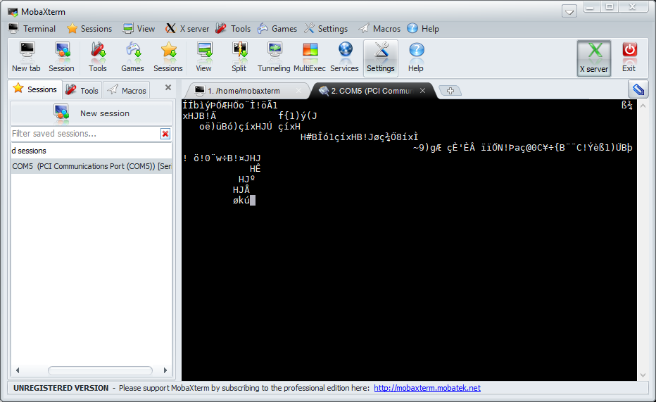

Hello guys,
I managed to make it work with MAX3232.
One hint for other people. MAX3232 will work with 2V communication. Just supply it from an external 2V power supply.
My broken HDD report the following on the terminal, at START UP:
Any hints ? what is broken? What shall I do next?
Should I buy a donor PCB? Thanks

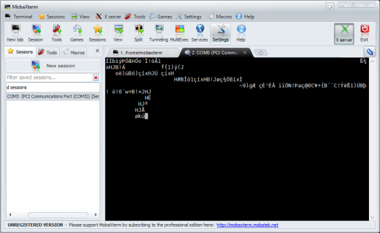

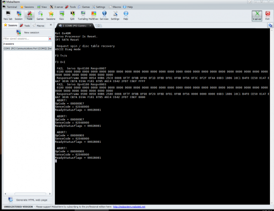

For others, I have tried first with MobaXterm, and I was not able to make it worked, I received:
 Post subject: Re: Faulty SSHD Seagate ST1000LM014 (NAND and PCB swap)
PostPosted: February 13th, 2020, 6:17
Posts: 4808
NAND problem. You need to patch the fw or use a pc3k to do it for you.
My recommendation is contacting a reputable DR shop. My pick would be Ciprian Enaru at Quartz data recovery (www.qdr.ro).

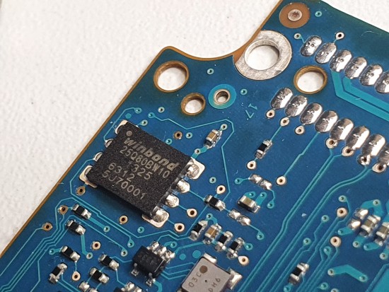

PostPosted: February 14th, 2020, 4:32
Joined: February 10th, 2020, 8:59
Posts: 27
Location: Romania

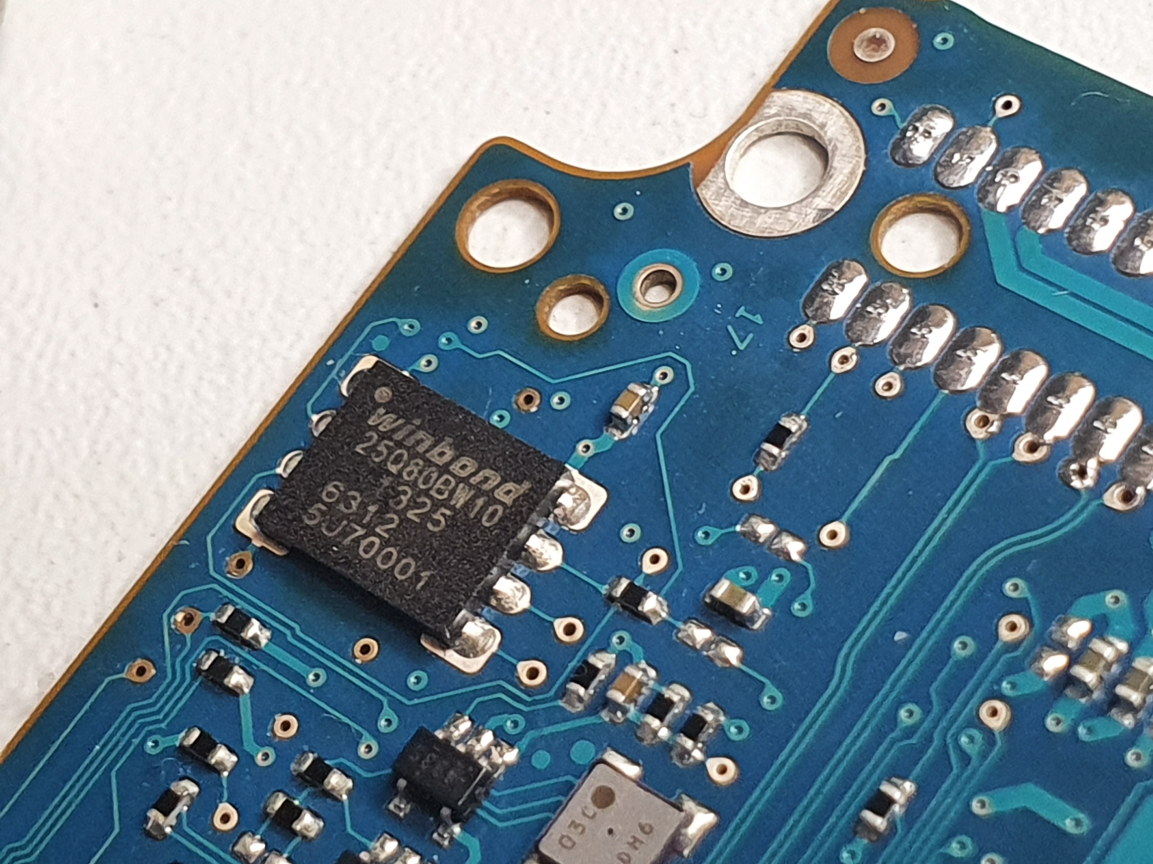

@fzabkar: Should I try to press Ctrl-Z ?
I have WINBOND 25Q80BW10 it seems to be at 1.8V, you were right.
I'm seeking for a EEPROM Programmer, and I found this one: https://www.ebay.com/itm/352894753009?ul_noapp=true
As far as I understand it's a 5V or 3.3V and I will get a 1.8V adapter. I think it should work, do you have other recommendations?
Regarding the donor HDD, should I have the HDA also? (or only the PCB it's ok) I found one full sshd but with bads, and the seller told me that it was not able to secure erase it using Seatools. Can I make a secure erase via serial port?
I don't have a PC3000 and it's quite expensive I think.
Thanks for the warm welcome, this will be my last Seagate product! :))
@Amarbir[CDR-Labs]: It will take a while until I will find a EEPROM programmer, seems that I cannot found one in my country :( but when I will have it, I will share here the ROM content here.
As far as I understand somebody must patch the ROM, in order to grant access to the terminal? Am I right? I was not aware of that. Thanks
What do you mean by "clone disk"? If everything works fine, I would expect to see my drive in Windows/Linux, and I can save my data. Or do I need a special tool to clone it?

It won't hurt to press Ctrl-Z, but I doubt you will reach the F3> prompt.
I don't have a programmer (I gave my old one away), so I can't recommend any, at least none that is inexpensive enough for a one-off job.
As for the other HDD, if you can reach the F3> prompt, you should be able to initialise the NAND, if the terminal is not locked. If it is not too expensive, try to obtain the whole drive. I'm surprised that it was unable to be secure erased, though. Still, if you want to experiment, we will at least find out which procedures don't work. ;-)
There is one other you could try. It didn't work in a different model (no damage done), but you could try disabling the supply voltage to the NAND IC. There should be a 3.3V LDO regulator nearby. Shorting its Enable pin to ground while powering on the PCB should render the NAND invisible.

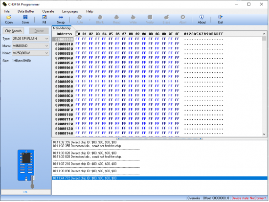

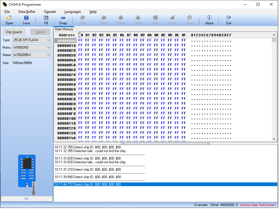

Hello guys,
Two topics:
1. CH341A EEPROM Programmer (software V1.3): I check it with a 3.3V memory, it does work (but it's not able to detect the memory, I have to manual select it). I was able to read/write etc...
I tried to read my 25Q80BW flash memory (not with the clamp) from the donor hdd (with 1.8V adapter). It does not auto detect it and even if I manual select it's still not working, I get the following errors (please ignore the device state, I made the print screen after I disconnect the programmer from USB):
File comment: CH341A_Programmer - manual select 25Q80BW
File comment: CH341A_Error_at_Detect of 25Q80BW
The memory is still ok, I solder it back to the PCB and the SSHD it's working.

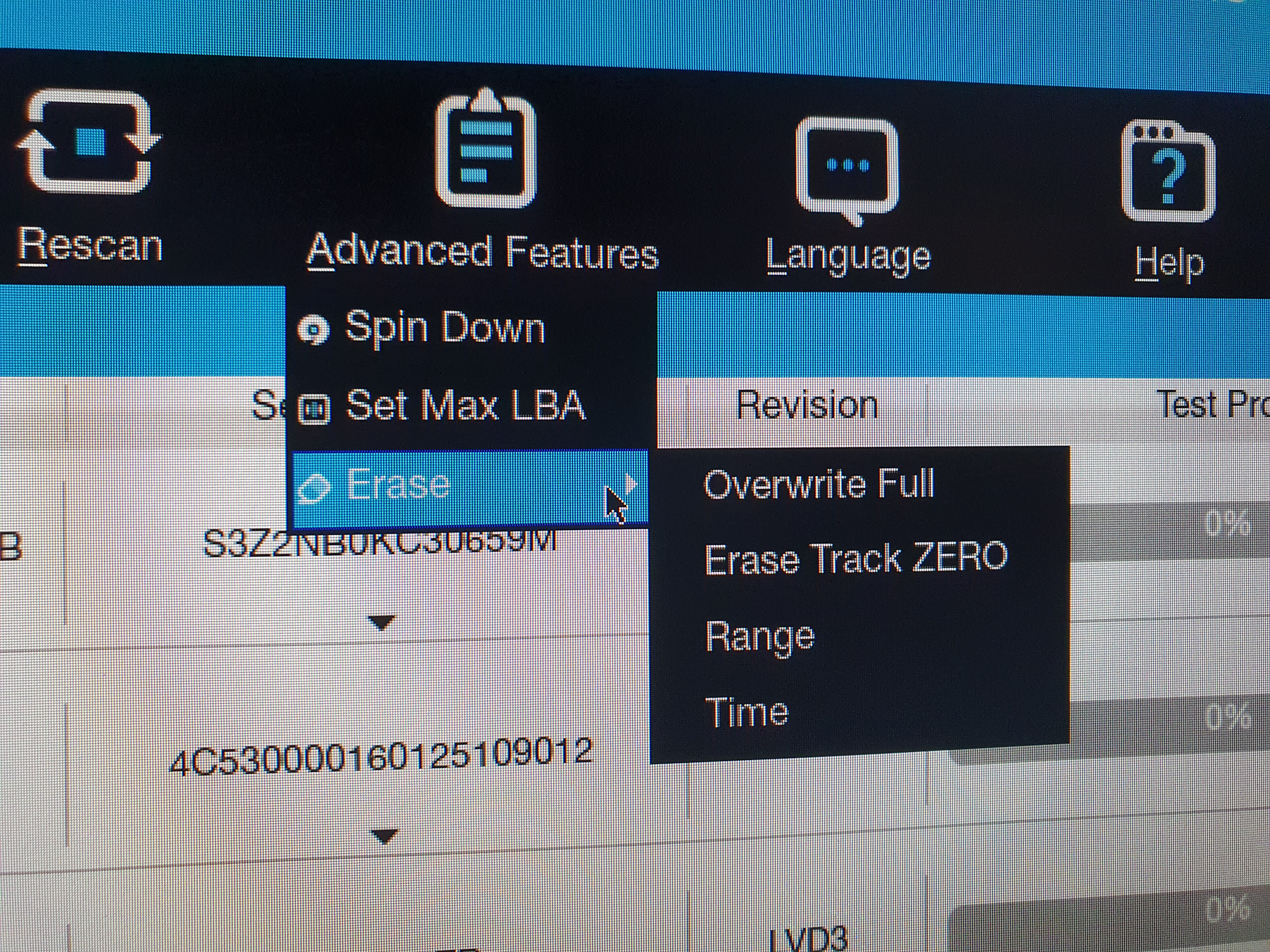

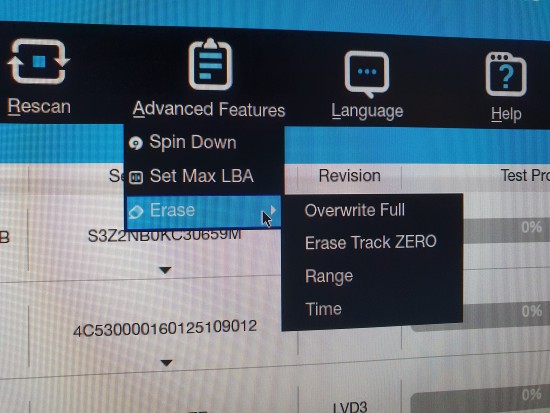

2. Donor SSHD and seatools:
- I have checked the s.m.a.r.t. first, I get "End To End Error Detection". I checked the Seatools (windows version and usb bootable version), and I did not found the secure erase:
In usb bootable stick version I have:
File comment: Seagate bootable USB
In windows version I forgot to make a print screen, and the memory is soldered on the programmer adapter (I will come back with a print screen it you need it). But were 3 options, as far as I remember were something like:
- fw update
- boot partition erase ?
- erase track zero?

Retarding the donor SSHD, do you have any idea how to secure erase the SSHD ? "Erase track ZERO" or "OVERWRITE FULL" would clear the NAND?
p.s. the option from Seatools (Windows versions): Firmware update, Overwrite Erase, Erase Boot Sectors.

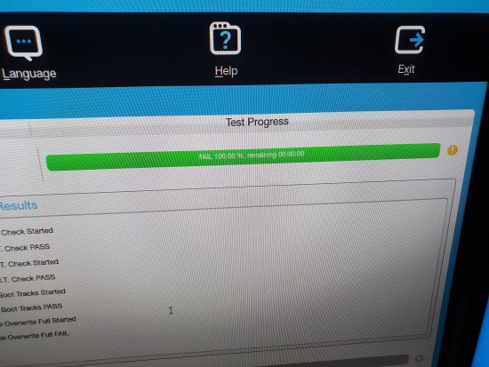

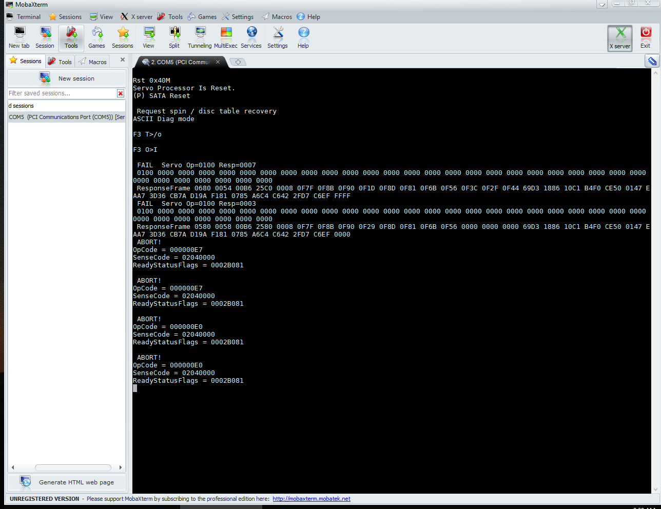

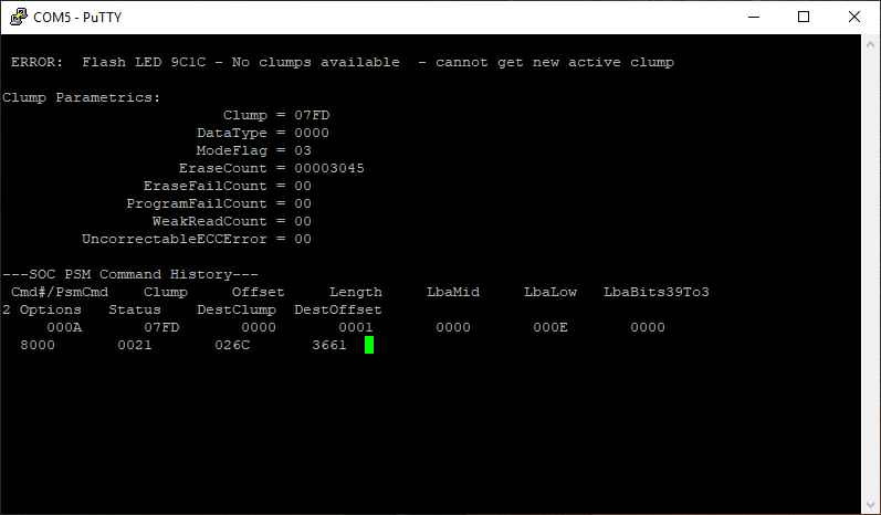

PostPosted: February 24th, 2020, 2:51
Posts: 27
Location: Romania

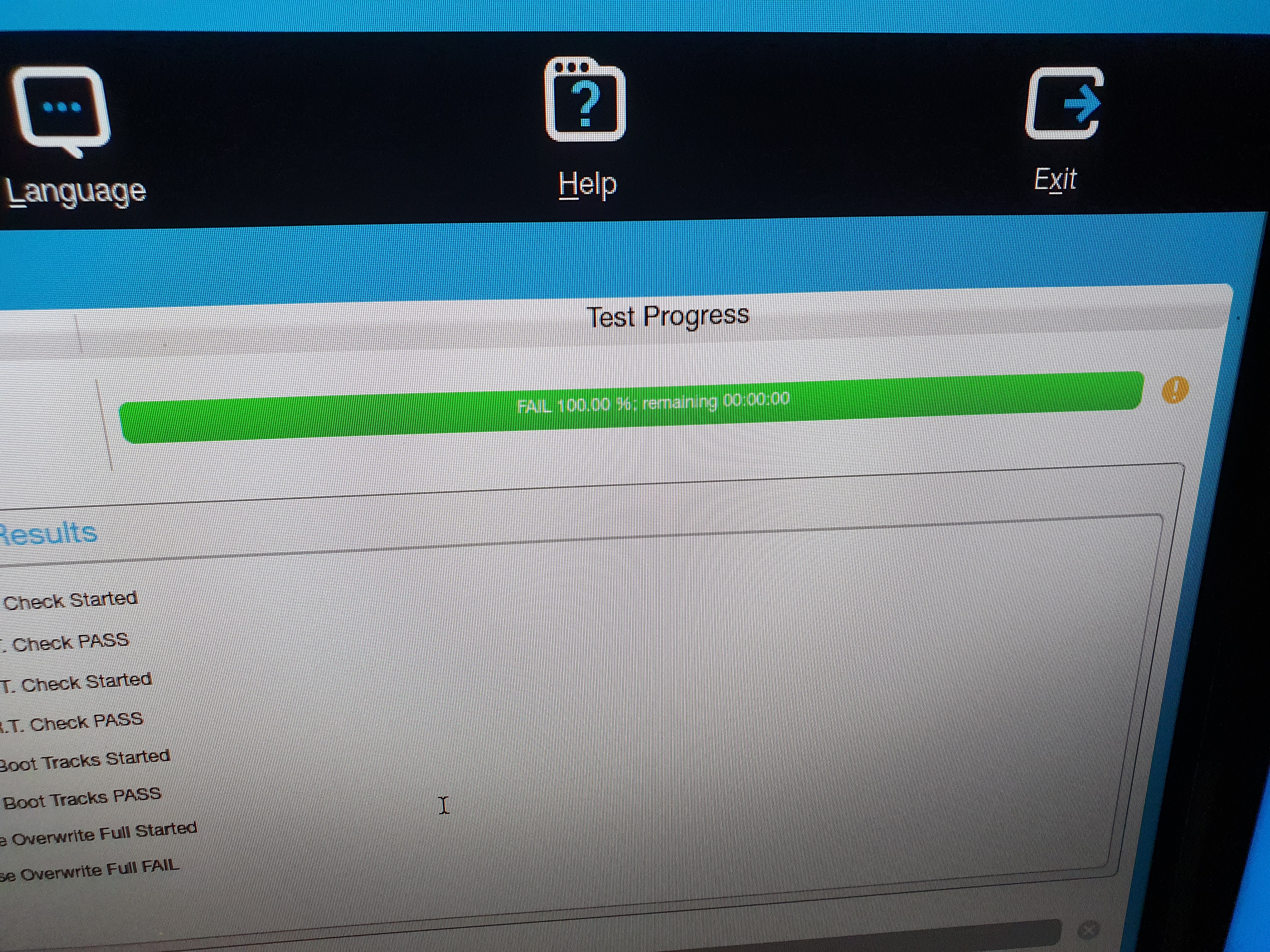

I have tried to run "Overwrite Full", it takes around 3 hours, and at 99.x% it fails.
After that I written into the memory my firmware, swapped the PCB.
In Windows I see it like this:
HDD_Raul_Partitions_edited.png [4.36 KiB]

Pretty strange to me that terminal is working, I have tried to use "/o" and "I", but it fails with the following message:
After a couple of minutes, I safely removed the SSHD from the PC and get:
Do you guys have any ideas? :(
It seems that it's a mechanical problem, am I right?
