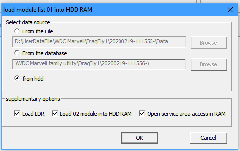

Hi I have this drive and has no detect at all and no strange noise
So I many time try to load loader but I cant get detect , any solution?
this is log of mrt i try to load loader from own drive

load 01...
load 01 to HDD RAM...
The data source : ..............................: HDD
Get 01 module from HDD : .......................: OK
Load module list : .............................: OK
Load LDR(0x5C), As permanent overlay...
Send Data(0x5C) : ..............................: OK
Load LDR(0x11), As permanent overlay...
Send Data(0x11) : ..............................: OK
Load LDR : .....................................: OK
Load 02 module to HDD RAM : ....................: OK
Zone allocation table : ........................: Err
Open SA access ...
Get SA access information : ....................: OK
Check SA access data : .........................: OK
Open SA access : ...............................: OK

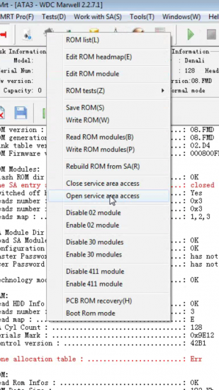

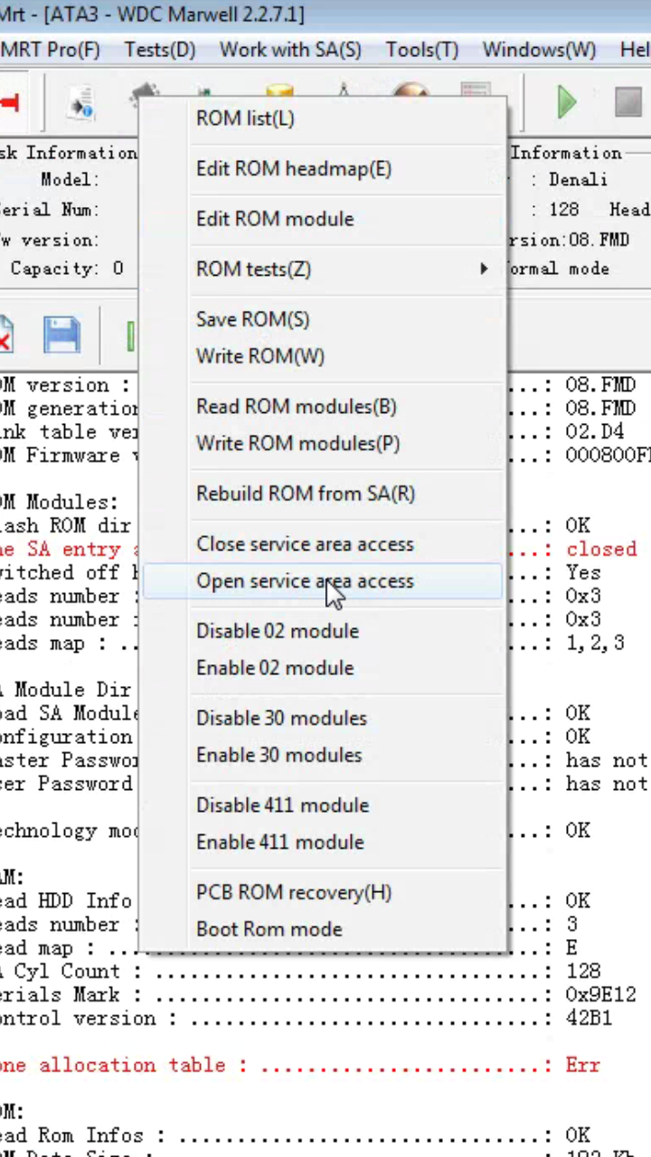

Ever try to open SA access?

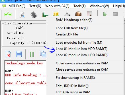

So first short read channel by short TV9 TV10 and close SA , then try to load loader with " Load 01 Module into HDD RAM "
This is the routine procedure for most case in WD hard drives that dont have detect and ID, and in most of them it get to repair them very well.
In this case I can get to read modules after load 01 Module , but after load 02 drive go to busy which is weird!

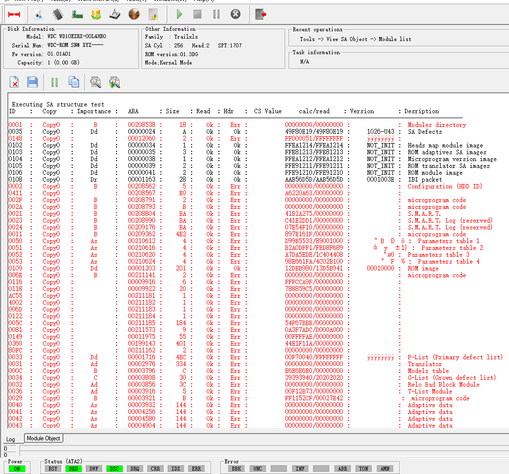

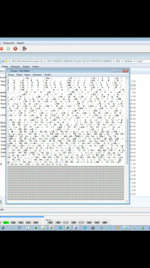

Re: WDC WD10EZRX-00L4HB0 Detect Problem
February 24th, 2020, 10:47

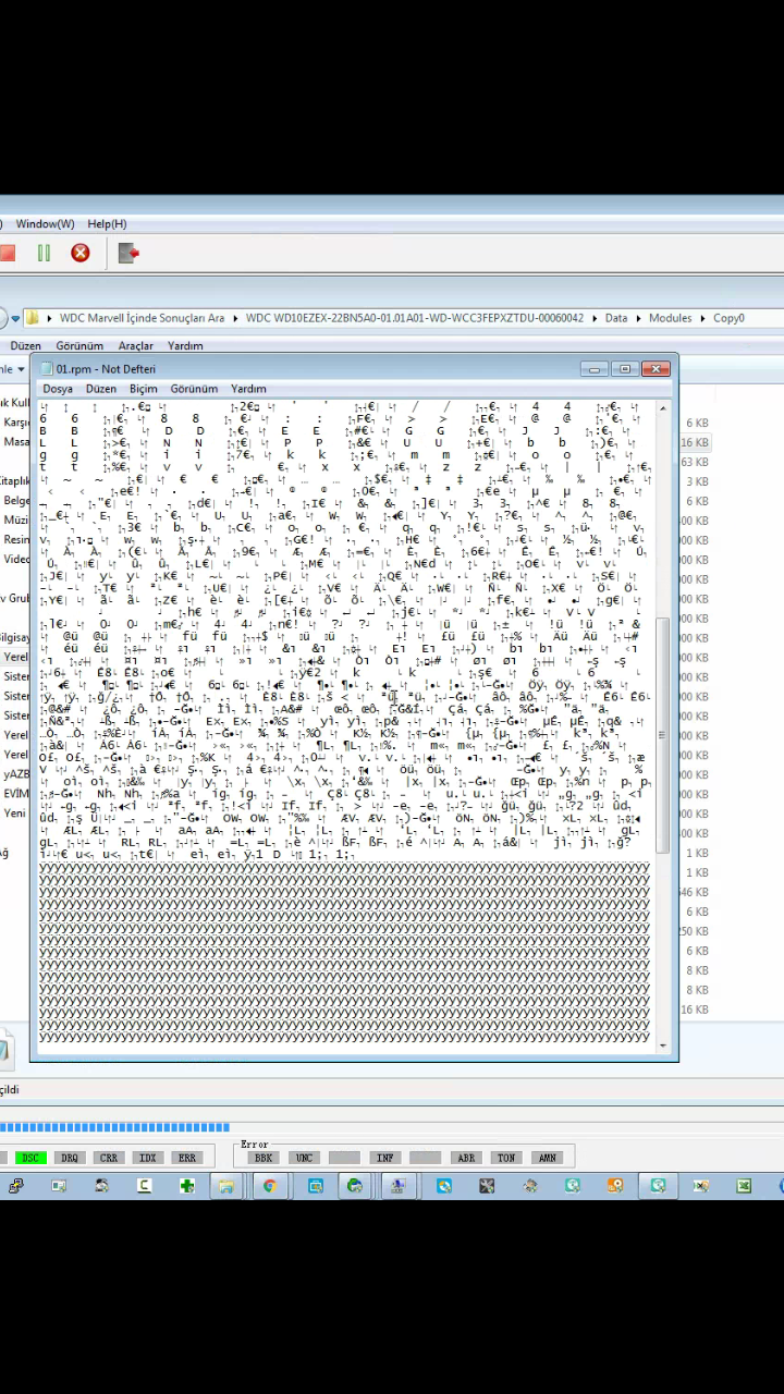

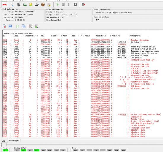

In ID mode and ABA mode all modules are OKay, but in Tracks mode almost all module are zero or incorrect values.
Some of modules in tracks mode
Any advice ?
February 24th, 2020, 15:30
its time to get remote help on this one, is ROM native on this drive ?
Modules reads ok but header incorrect explains alot.
