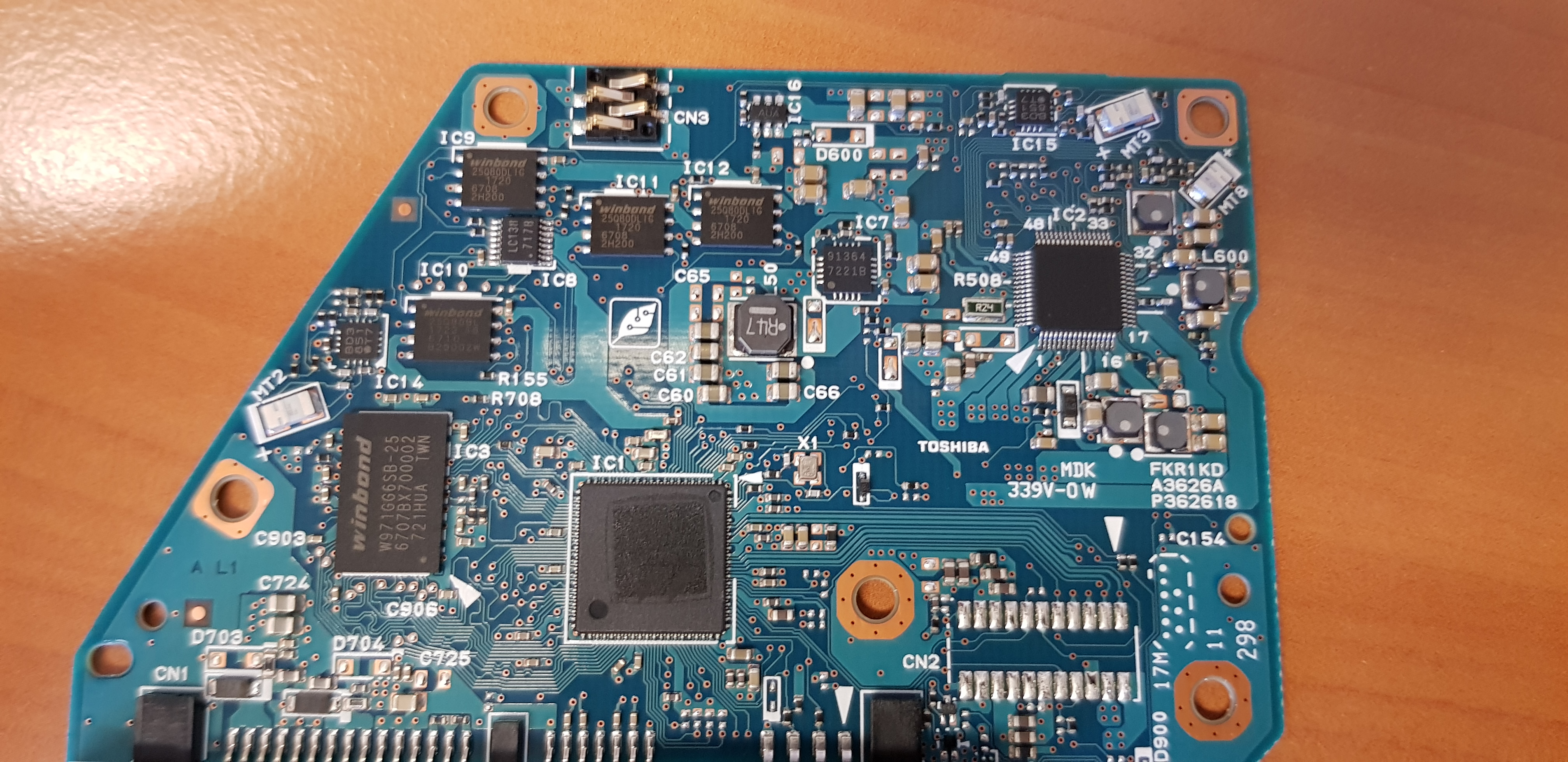

Toshiba 4TB 3.5" HDWE140 - any suggestion as to which ICs need moving to donor PCB please?

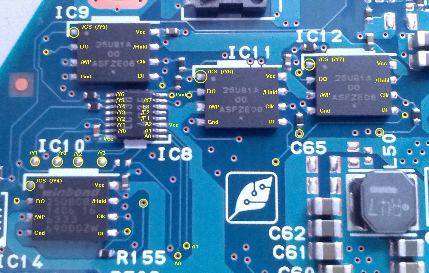

I would suggest IC10.
The other three ICs (9,11,12) have the same numbers.
May someone else confirm.
Good luck Nick.

Swapped IC10, drive spins up and seems to calibrate but remains BSY. Will have to swap the other ICs in question and see if that solves it.

I tried moving only IC10, drive spun up but stayed BSY. Moved IC9,11,12 as well, that worked. So all 4 ICs need to be moved to donor PCB.

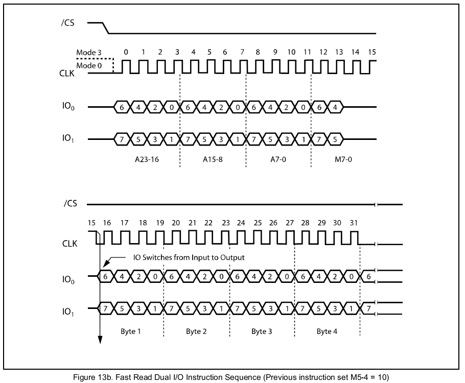

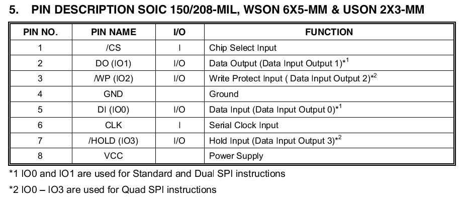

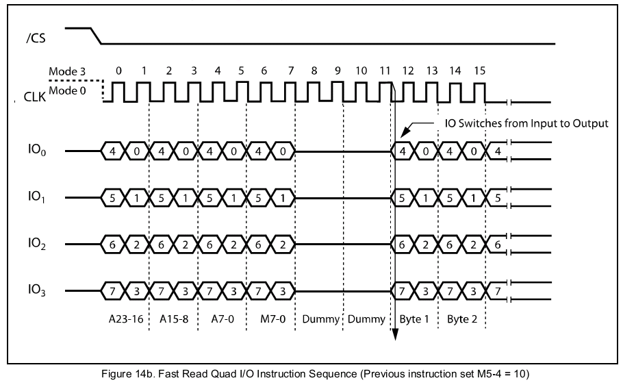

Only 1 of the 4 memories can be accessed at any time. That is the function of the 74LC138 decoder. Therefore the decoder provides no speed advantage. In fact a decoder would not have been necessary if the MCU had an additional 2 spare GPIO or address bits.
Dual I/O and quad I/O are features of each particular chip. When these modes are activated, the DO, DI, Hold and WP pins are redefined as I/O pins, and read speed is increased by a factor of 2 or 4, respectively

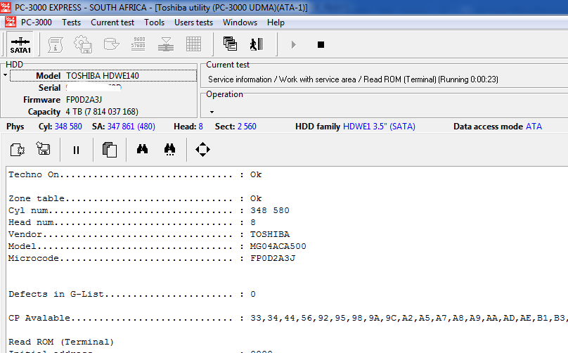

Attached is what the PC3K utility saved as ROM. (renamed to .txt from .bin for upload purpose)
No, I don't have backups of each individual IC.

There should be a 4MB flash image, as those chips are 8Mb each.
So you can probably read them manually through terminal or in a programmer...

AFAICT, the circuit is as follows:
