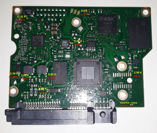

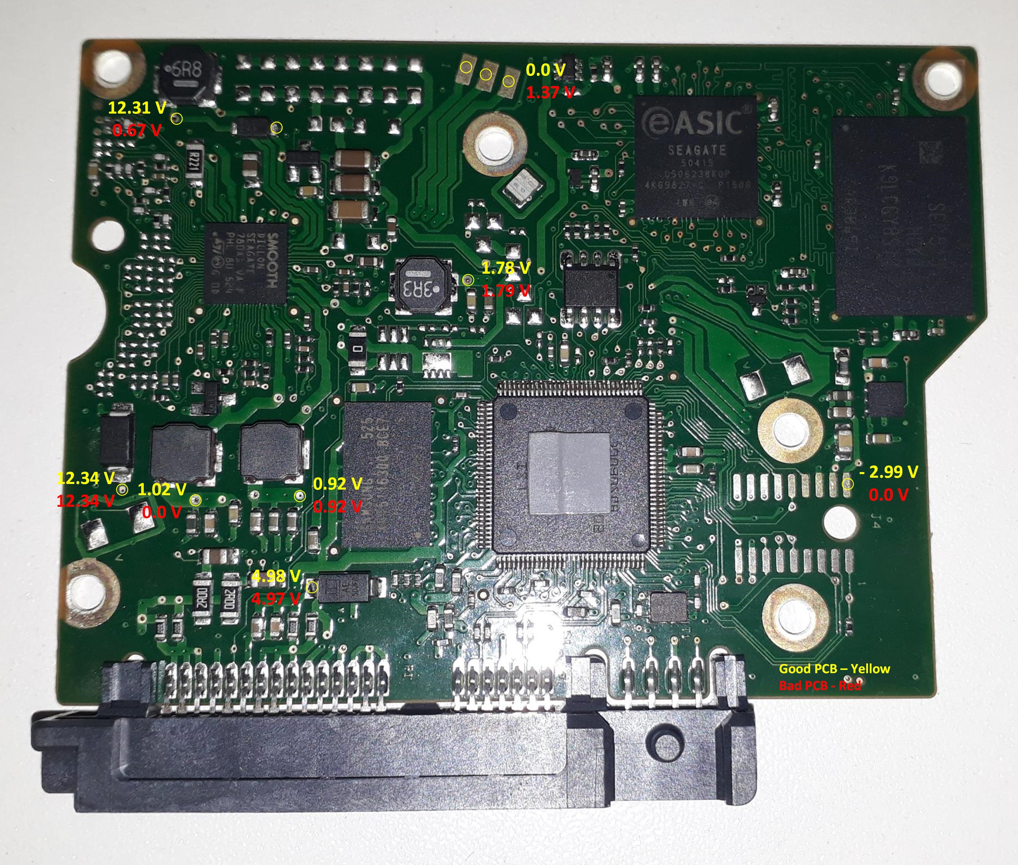

@fzabkar, I attached an image with some voltage measurements for reference. I can access the terminal in good PCB. The console isn´t locked and can execute commands, ex.: V1, V4, V40, etc.
I think there's a short somewhere on the Bad PCB but I don't know where it is.
File comment: PCB Seagate ST1000DX001 - Working vs Not Working

I am wondering about the missing supply voltages.
AIUI, the motor controller generates most of the onboard supplies (Vcore1, Vcore2, Vio and Vneg), and there is an additional linear 3.3V regulator adjacent to the NAND (did you check this?). The MCU requires a Vcore and Vio supply in order to start POST-ing, after (or during?) which time it commands the motor controller to switch on the remaining supplies. In your example the second Vcore is either missing or switched off, and the Vneg preamp supply (-3V) is also missing. This suggests that either the motor controller is faulty (unlikely), or that the MCU has switched off, or not enabled, these two voltages, probably because of a POST error.
You say that you have access to terminal on your working HDDs. Would you be willing to experiment with a good drive, with the understanding that you may brick it? If so, then short pin #1 of the 3.3V regulator IC to ground during power-on. This will disable the 3.3V supply to the NAND IC, thereby simulating a NAND failure. What do you see in terminal after you do this?
Also, which of the supplies are running and which are disabled, if any?

Did you not read this?
In your example the second Vcore is either missing or switched off, and the Vneg preamp supply (-3V) is also missing. This suggests that either the motor controller is faulty (unlikely), or that the MCU has switched off, or not enabled, these two voltages, probably because of a POST error."
It could also be that the MCU is faulty, but unlikely. Let's see what the OP's multimeter will tell us when he disables the NAND.

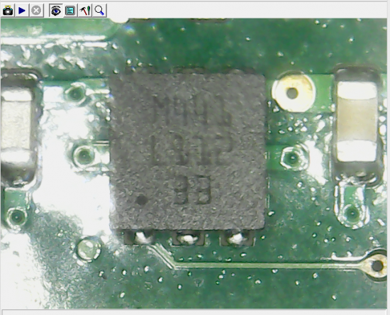

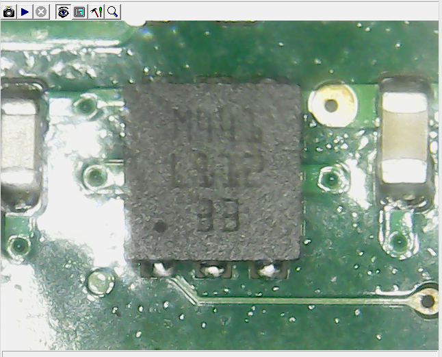

@fzakbar, I didn´t find the datasheet of Regulator IC near the NAND Flash to short pin#1 to ground. I attached an image of the IC. It seems M441 L112 33.
Additional information: In good PCB, after a few minutes, several components become warm. In defective PCB, only MCU IC get warm, even after 40 mins.

LDL112PV33R/LDL112PU33R, STMicroelectronics, 1.2A, 3.3V, LDO Voltage Regulator, marking L112 + 33, DFN6:
https://www.st.com/resource/en/datasheet/ldl112.pdf
Datasheet database:
http://www.hddoracle.com/viewtopic.php?f=100&t=1577
