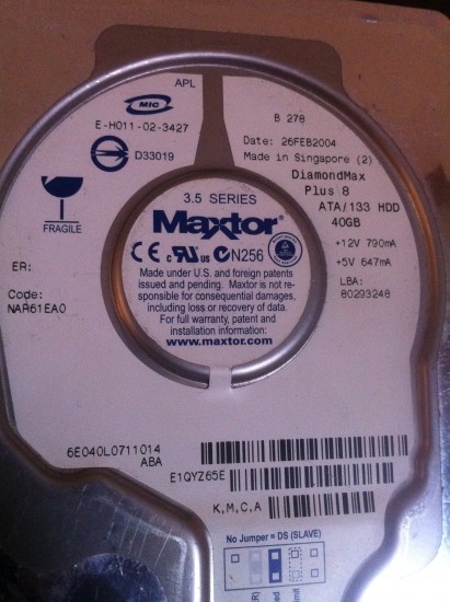

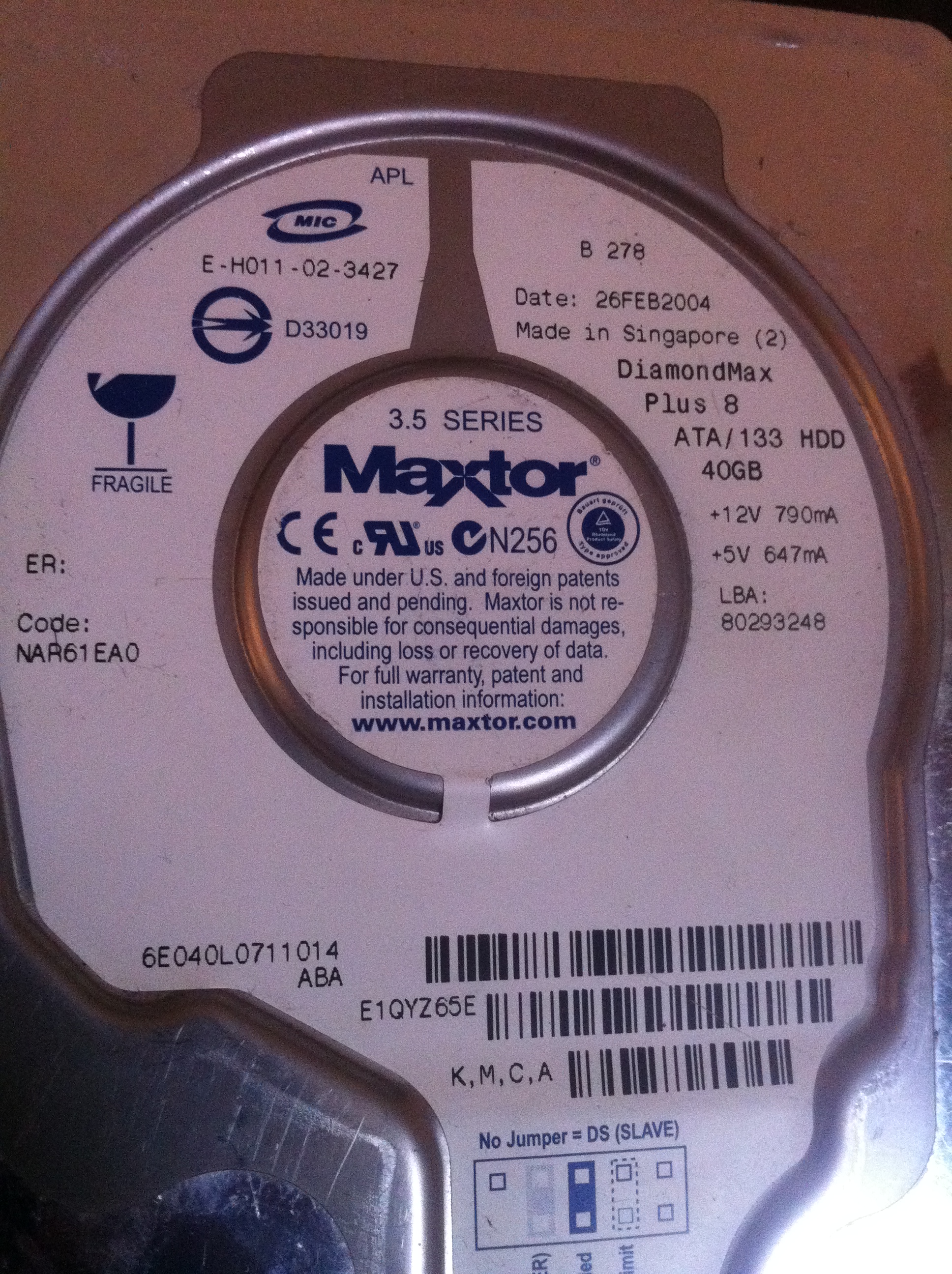

hello please can someone help me find the right motherboard for my old hard drive
here are some of the examples i found on the internet but im not sure wich one to buy they all have same LBA

how do you know the pcb is bad?

Its burned i tried another one the disk spins perfectly but not detected
ROM not compatible.
For the following Maxtor hard drive models: Fireball 3, DiamondMax 16, DiamondMax Plus 8, DiamondMax Plus 9, Diamond Max 10 and all MaxLine products there is also a GTLA Number on the model (next to barcode on the bottom of the drive). Format 1Y222J2223322. 1, 2 and 3 stand for numbers, Y and J for letters.
The numbers 1 and 3 as well as the letter Y need to be identical to be able to replace the PCB on these drives.
This number can be found on the large sticker on the top of the drive.
Unfortunately we can not give you any more information than this. Any of your DiamondMax Plus 9 drives could possibly have a matching PCB, however it is most likely to be an older one as the drive in question is almost 3 years old.
Kind regards,
Gisela Schubert
Technical Support
Maxtor Ireland Ltd.

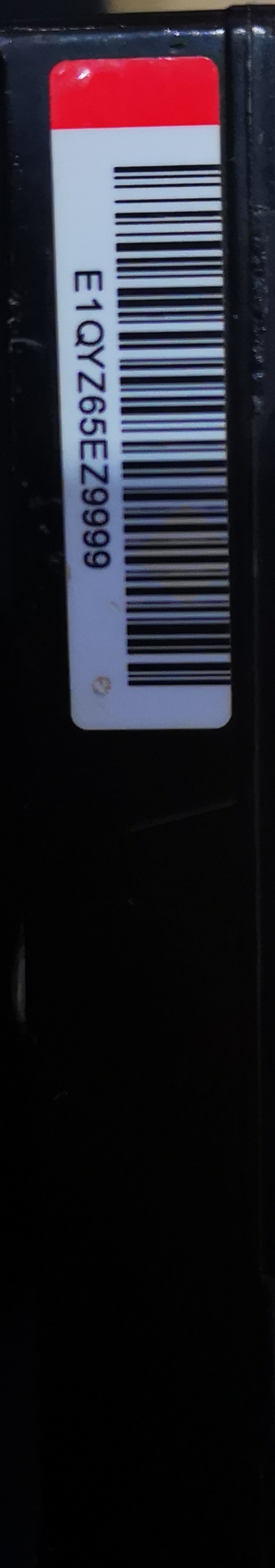

This is it?

No, it is the 6E040L0711014 she was talking about.

What should i do now?

Match PCB's and replace and pray that the pre-amp is still intact and/or FW corruption. Otherwise you will need platter swap to retrieve the data.
