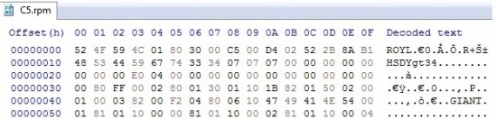

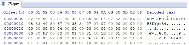

Does module 0xC5 still report the family ID?
yes it does, but sometimes if your drive is not supported or mcu locked you cannot access it to verify

+1, SPE is Giant
 Post subject: Re: WD40EZRX-00SPEB0 Drive Family Conformation
PostPosted: March 11th, 2020, 8:07
Posts: 1729
+1 Giant.

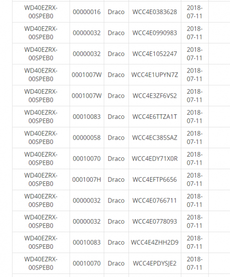

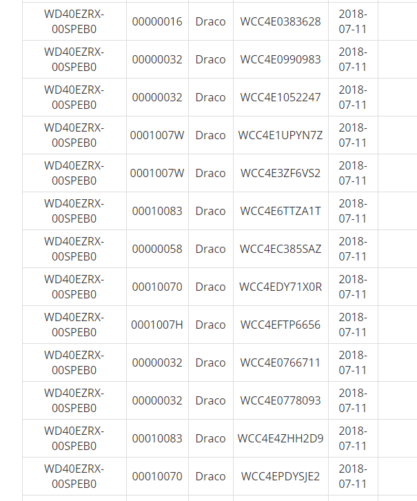

Maybe this is where the confusion stems from. This is an extract from HDDSurgery Firmware website.
PostPosted: March 12th, 2020, 2:12
Posts: 2848
download a sample resource and chk C5
:wink:
