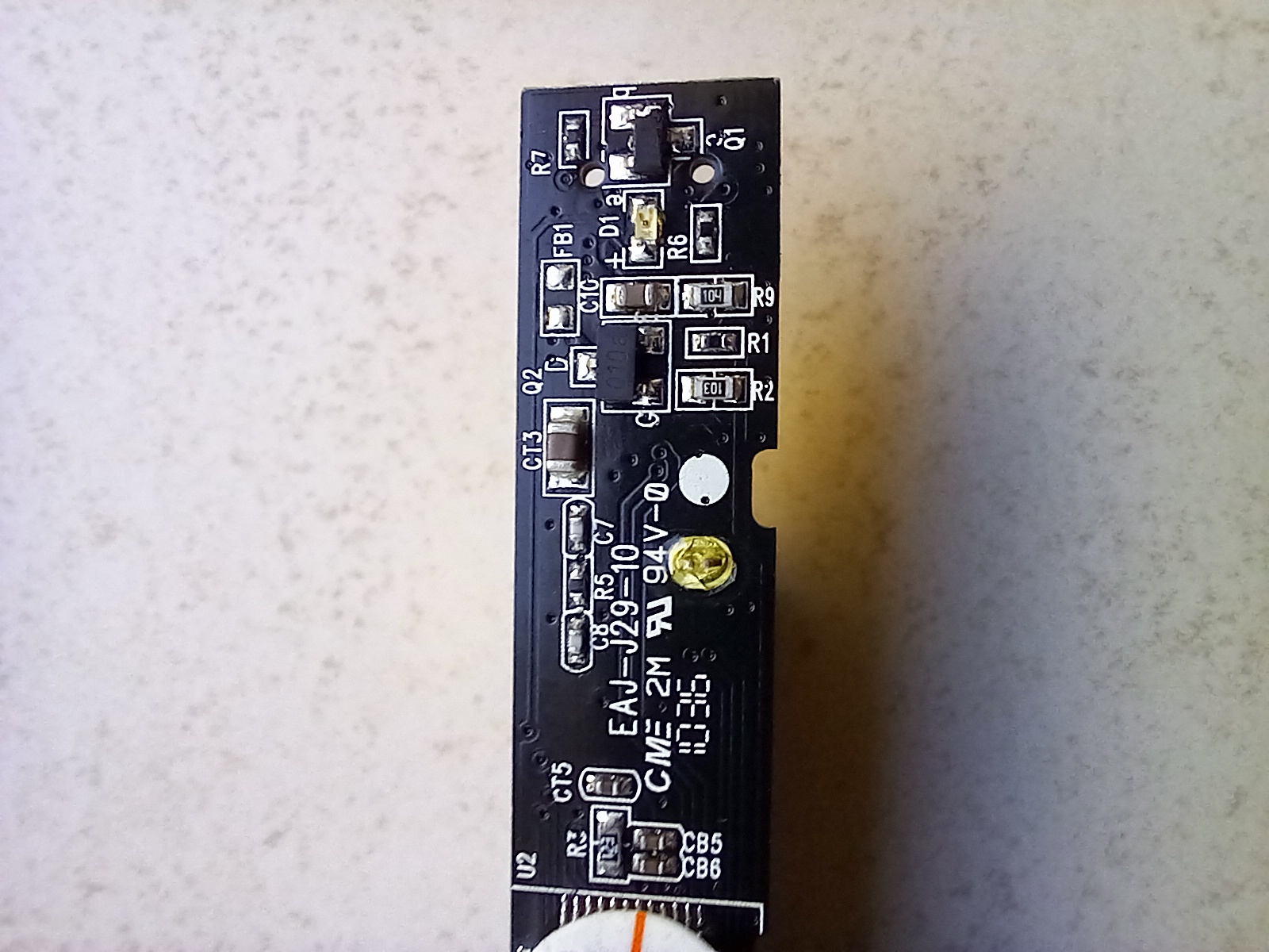

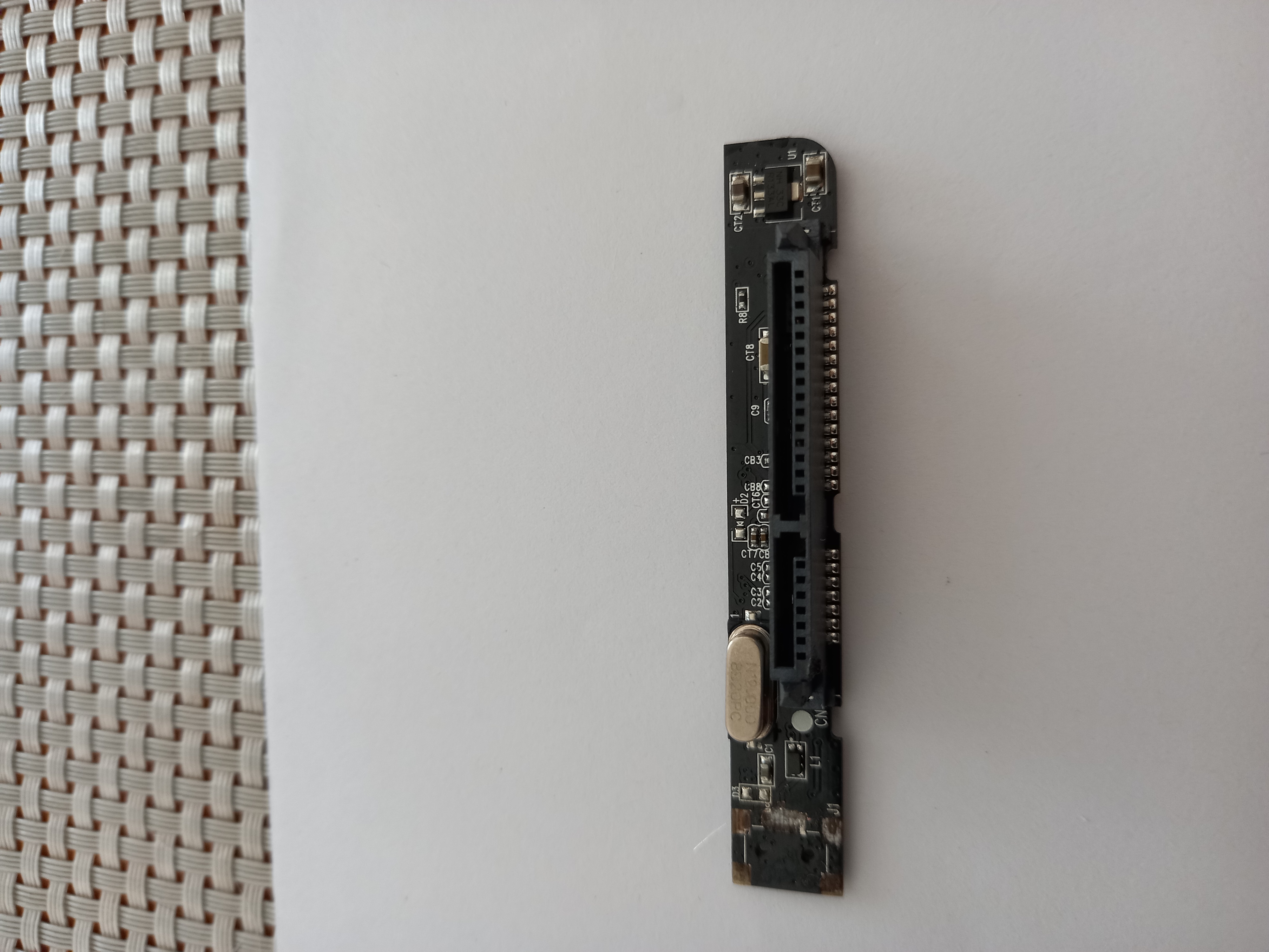

Hello this is my 1st post, happy New Year to you all. Due to poor quality soldering joints the Micro B connector on the adapter connected to the sata drive completely snapped off. I attempted to resolder the Micro B connector back on and plugged the drive back into the USB connector on the laptop, result no sign of drive life. I Checked my soldered repair under a higher magnification and noticed the solder had unfortunately flowed touching other pins. (Could this have damaged the PCB and which board components may have been damaged)? The 2.5 Sata drive is a Samsung 100UI-01 the PCB fitted to the drive has the S/No MT2_S3M.REV-01 After a bit of background research I carefully removed the TVS diode, result no spin! I would appreciate advice regarding what to check next, note my background is not electrical and lol I'm ashamed to admit I don't own a multimeter, though I can certainly get one. Photo of PCB attached.

No spin on these is not always a PCB problem they also have stiction issues, especially if you've had power interruptions. Can you hear of feel anything when initially powering the device. No multimeter is going to make diagnosis almost impossible. If you get hold of one we can at least check the coils for voltages, I wouldn't have clipped that diode blindly either. I don't have a have a rev1 board here but I'd found a rev2 on an old 320GB.

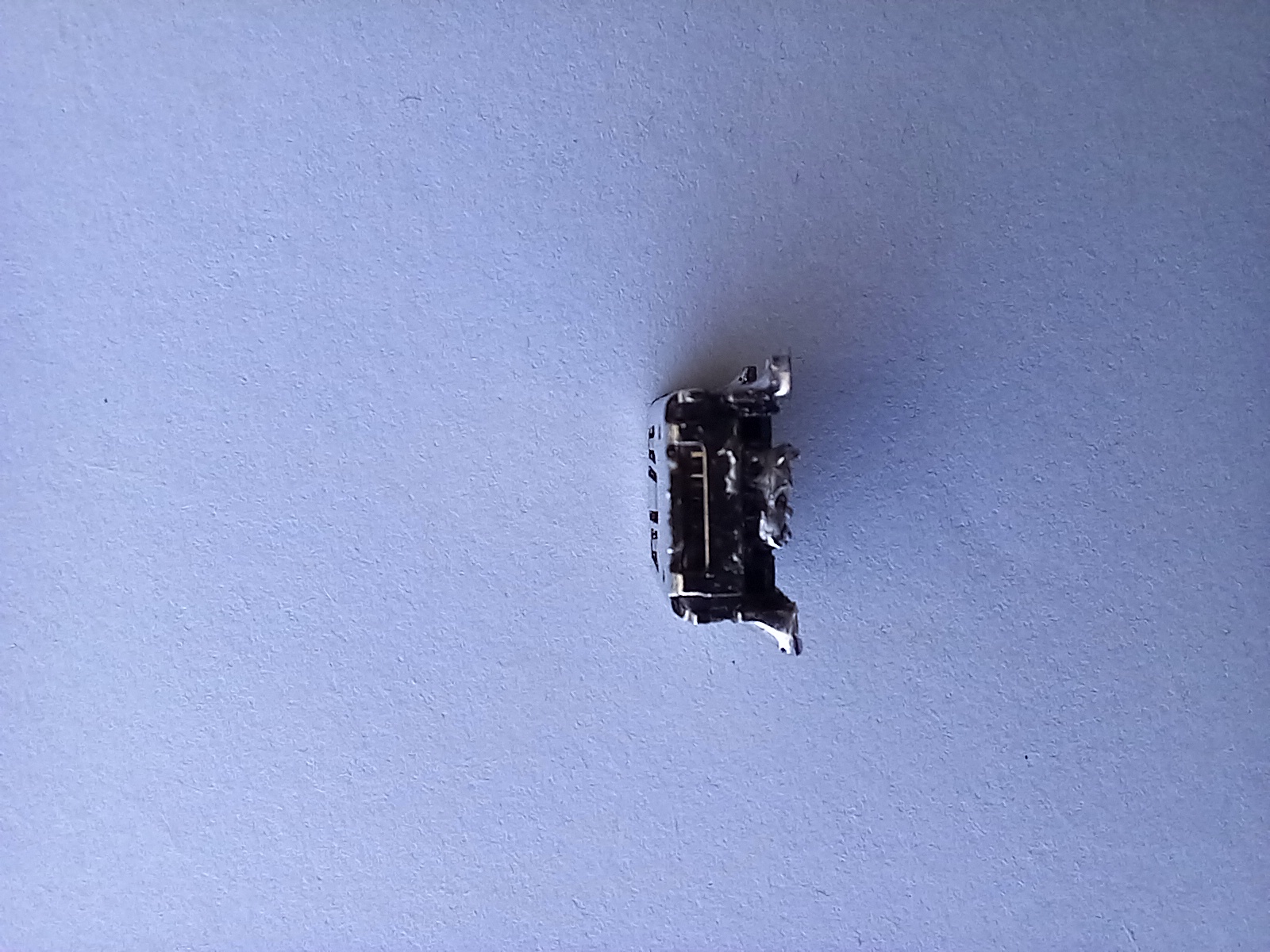

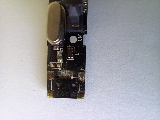

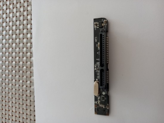

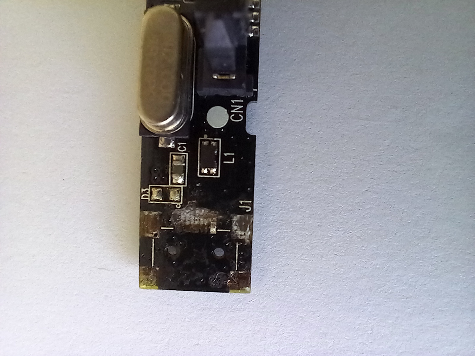

can you upload a picture of the Micro B connector on the adapter so we can figure out what damage could be done, high quality picture on both sides... I'm not sure how a short of the bridge board can cause the drive to be damage as the damage would be limited to the bridge board itself, unless something else happened.

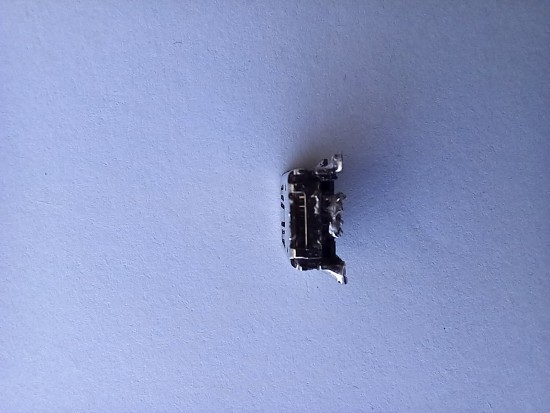

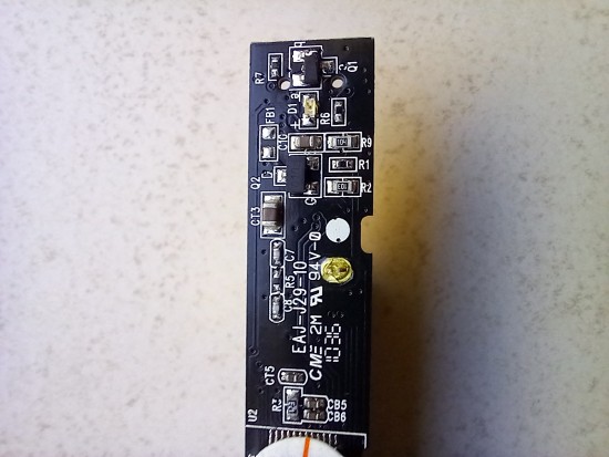

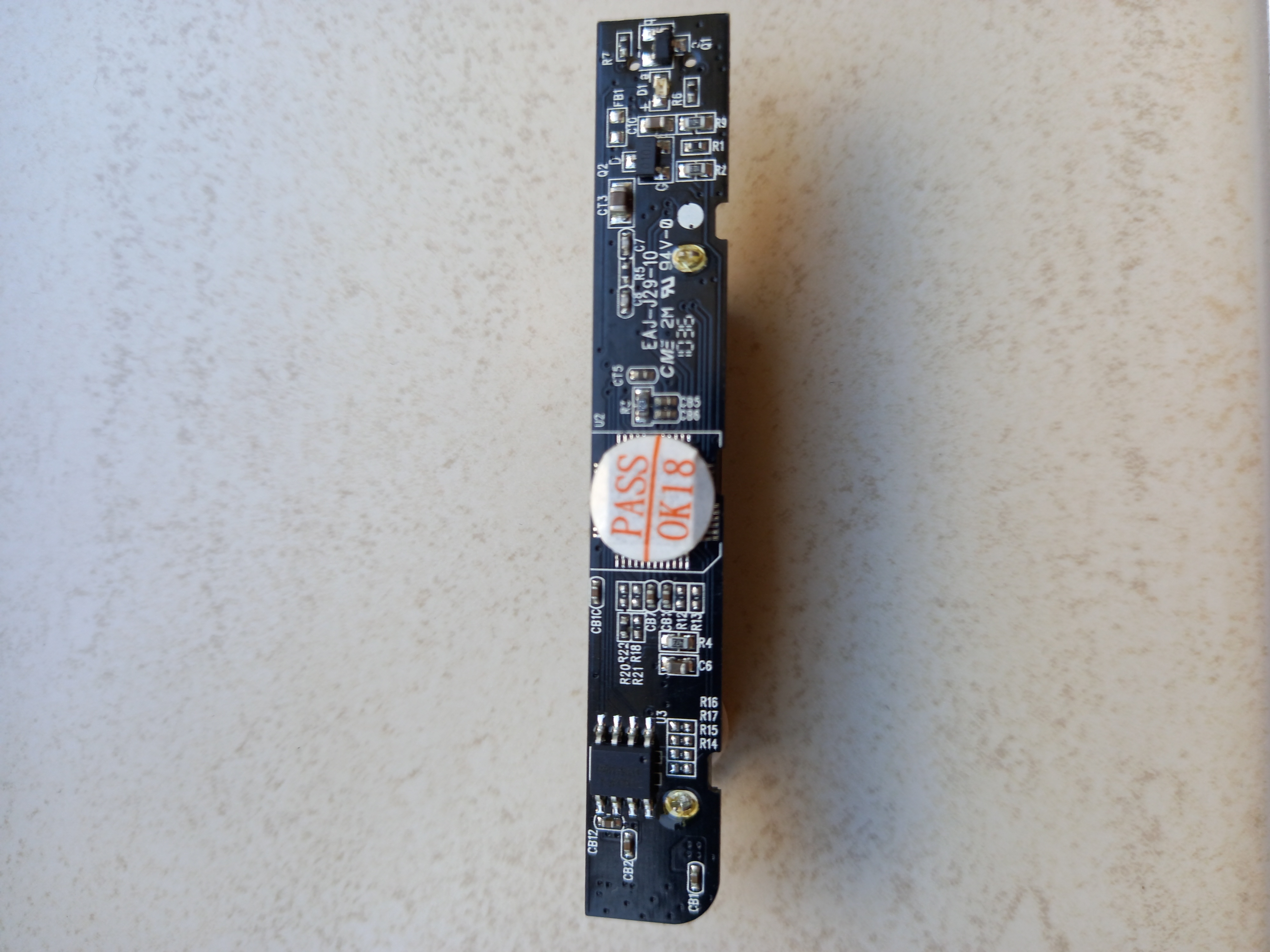

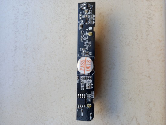

Hello Shane Ward I've located the Micro USB broken connector and Adapter board, pictures are attached. I now have a multimeter for testing, any suggestions for fault finding would be welcome.

 Post subject: Re: Iomega portable HDD not spinning
PostPosted: March 6th, 2022, 10:54
Posts: 1312
You didn't plug it with soldering like that did you ?

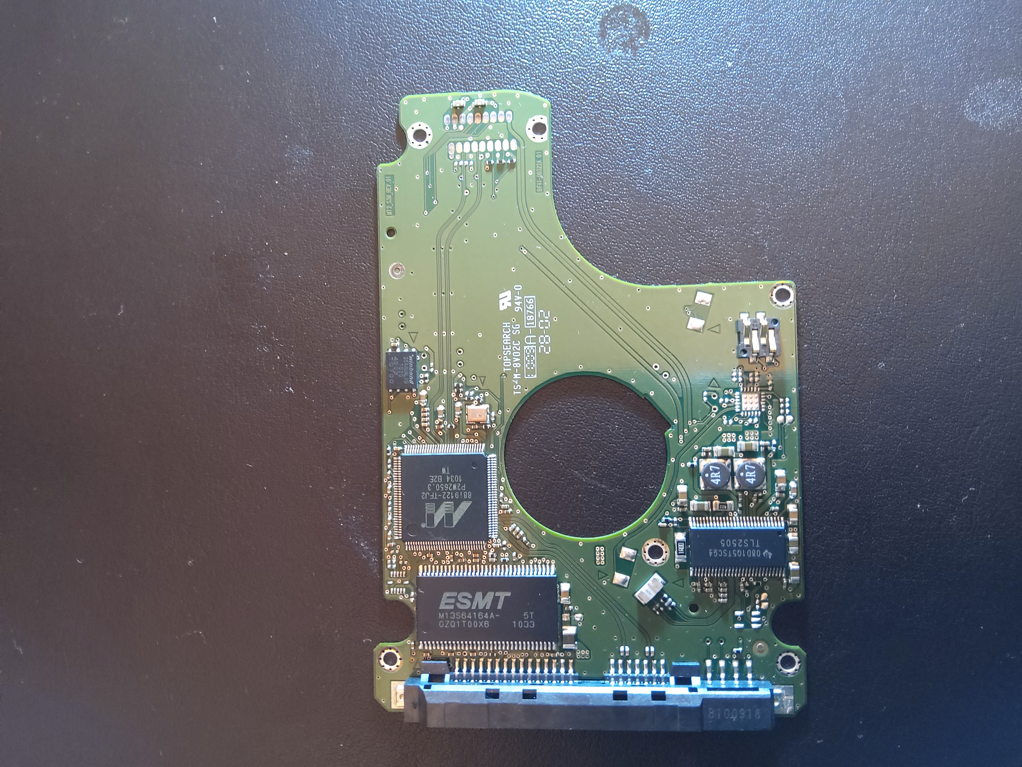

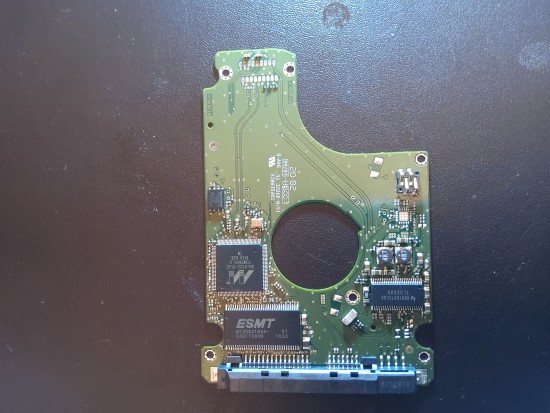

I've not checked to see if I have one of those PCB's in but check resistance to ground (a screw hole) from the v5 rail on the connector and the first inductor past it (there looks to be a diode missing there) and from the live side of the coils below the motor connector. I'll have a look for a pcb later if I'd got one in I'll get some comparison readings for you.

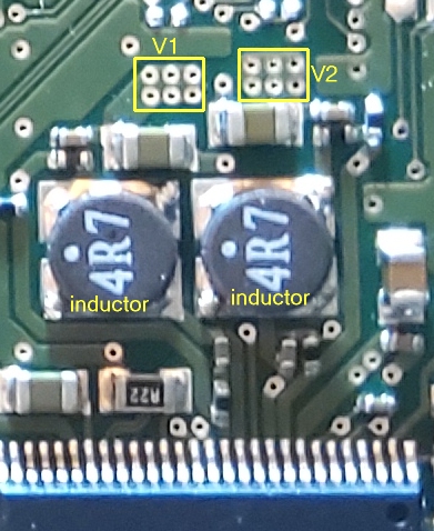

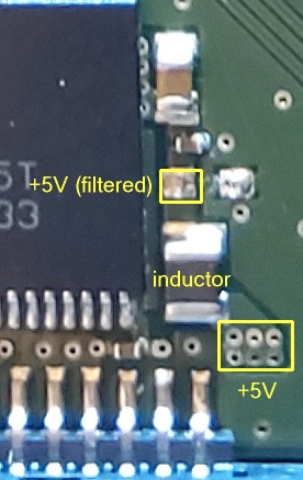

Measure the voltages at V1, V2, +5V and +5V (filtered). Use a screw hole as your ground reference (black probe of multimeter).

Thank you Lardman and Fzabkar for your helpful replies I'm ashamed to admit that I did plug the connector in with the soldering shown :oops: my solder repair wasn't up to scratch and I was unable to examine the joint using higher magnification. Hi Lardman can you clarify exactly where to position probes (noob) :oops: ie red on components indicated, black probe? Position.

fzabkar has highlighted the locations for testing, these are with usb power on and the meter set to dc volts.
I found a board to check for you and you should be getting the following, or there about.
+5v - 4.89v
+5v Filtered - 4.82v
V1 - 2.48v
v2 - 1.06v

Here are the voltages from testing the board.
+5V = 5.04V
-5V Filtered = 5.02V
V1 = 2.46V
V2 = 1.06V
All seem OK?

All OK. Are you sure you don't hear any sound at all, even a soft ticking sound? You may need to place your ear on the drive.
