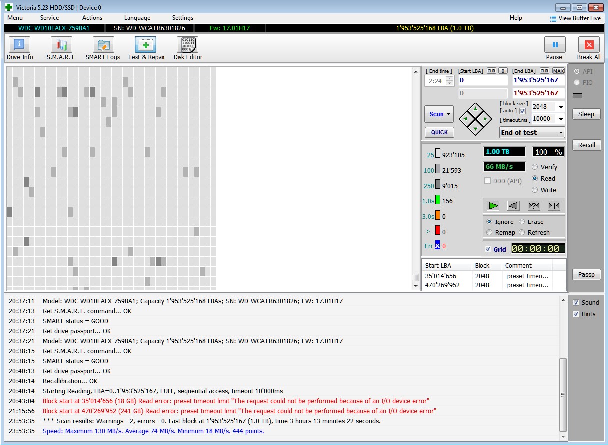

I am sorry to trouble you with this but my C: system drive is, I think, on the verge of failing, causing occasional OS freezes and resisting complete backup. It boots fine in normal mode but the monitor cuts out after c.5mins if booted from CD or in safe mode. The data on it is moderately important - the most important data is on my D drive which I keep thoroughly backed up. But I am 80% of the way through a project, and am using quite complex software installations. So loss of system/software access and even moderately important data would prove very disruptive.

  1. Backed up what I can on drive C to the web using Idrive. The backup seems to fail (locks up!) at different points different runs. I am trying to incrementally back up what I can in short runs.

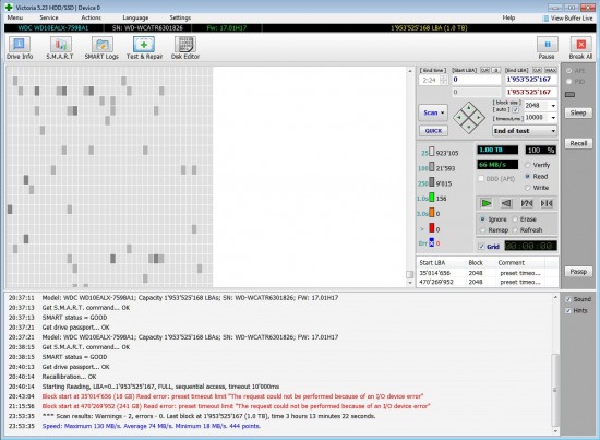

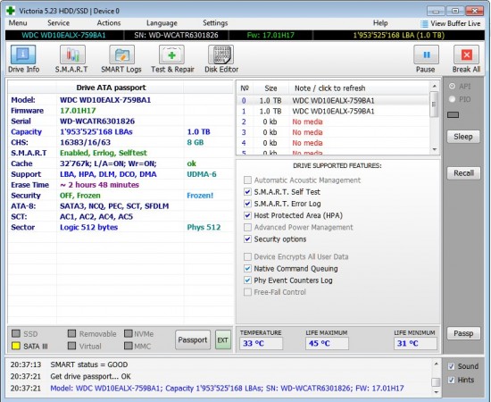

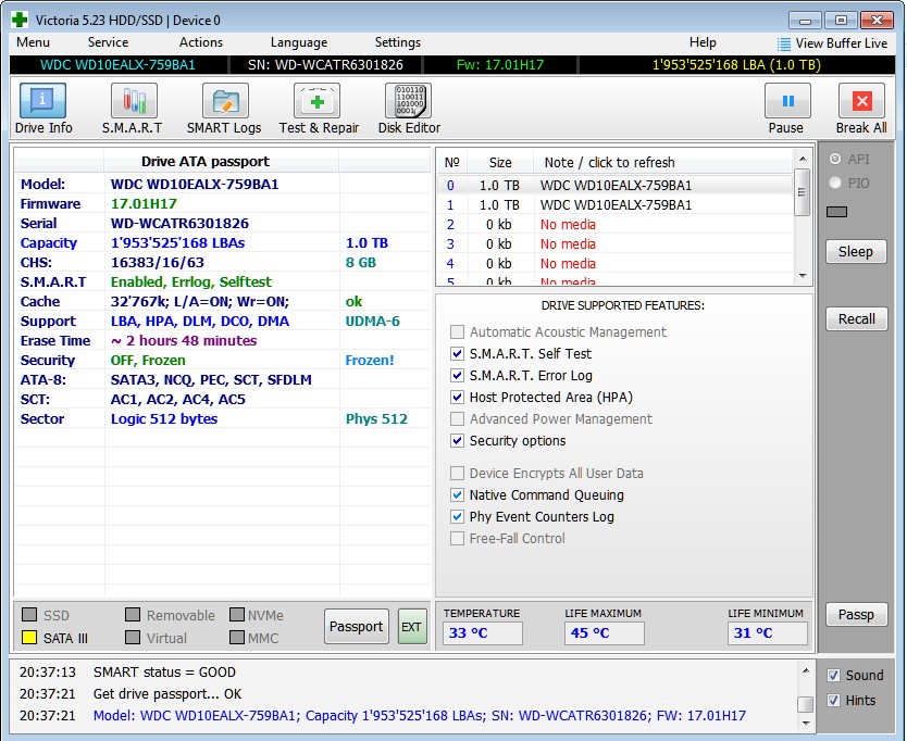

  2. Installed Victoria on drive D, and run a drive C scan in read/ignore mode. I append full results, showing 2 LBA read 't' (timeout) failures, and large number of green LBAs. The results which will also give you the exact make and model of the drive, SMART data etc.

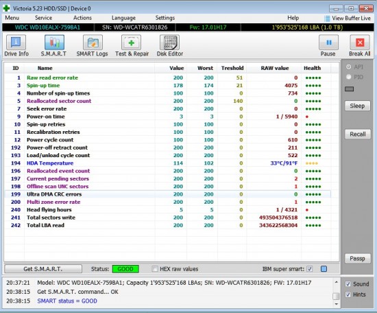

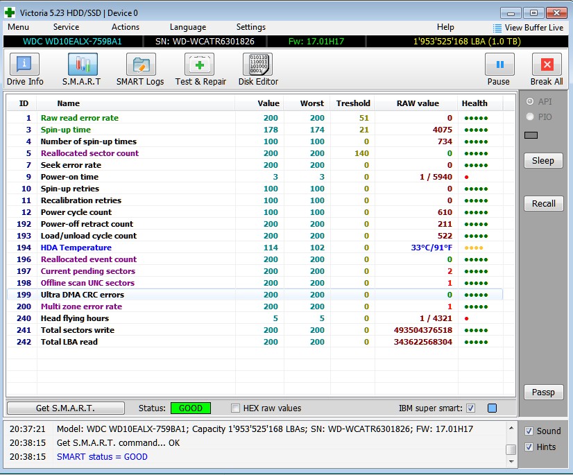

  3. Noted from the SMART results that there is one sector already marked bad and two pending
  4. Tried hard to fix the safe/CD boot problems. Next step might be to uninstall the graphics card and switch to onboard graphics but I hesitate lest it destabilise the system drive
I assume that one thing I could do now is run Victoria in erase mode on the two failed blocks (presumably these are the pending blocks from the Smart data?). But being new to all this I though I had better check first. So my queries are:

  5. The system, prior to original supply to me, was reconditioned by Dell and changed from a 1TB RAID array of 2 x 1TB disks to a pair of separate 1TB disks (controller Intel Cougar Point PCH - SATA AHCI 6-Port Controller [B3]) Does this create any complications?
  6. Are the red dots in the SMART data a matter for concern?
