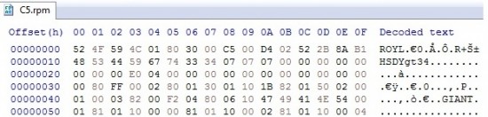

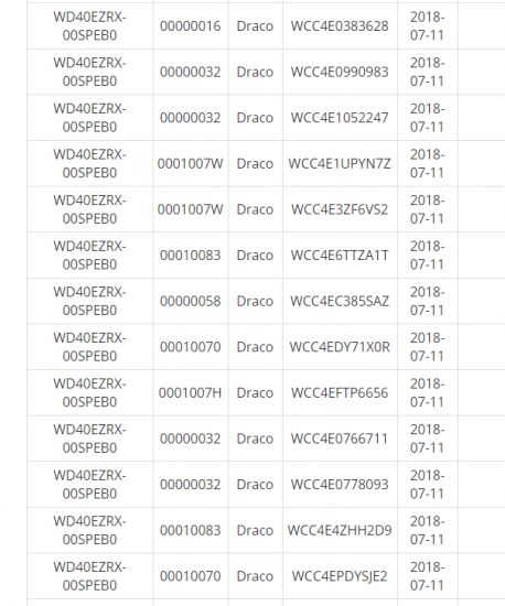

Maybe this is where the confusion stems from. This is an extract from HDDSurgery Firmware website.
download a sample resource and chk C5
:wink:
