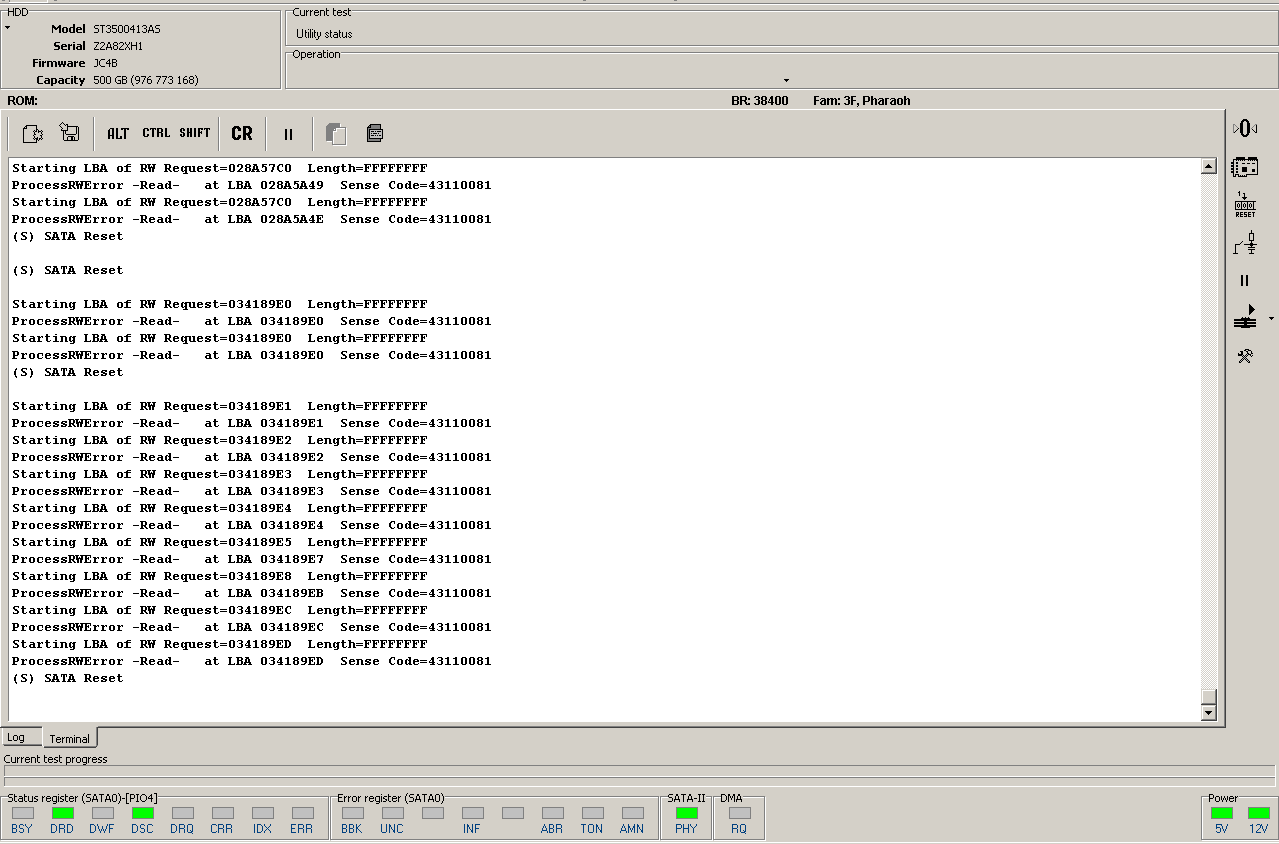

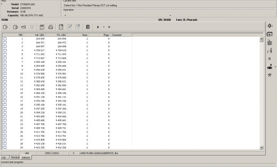

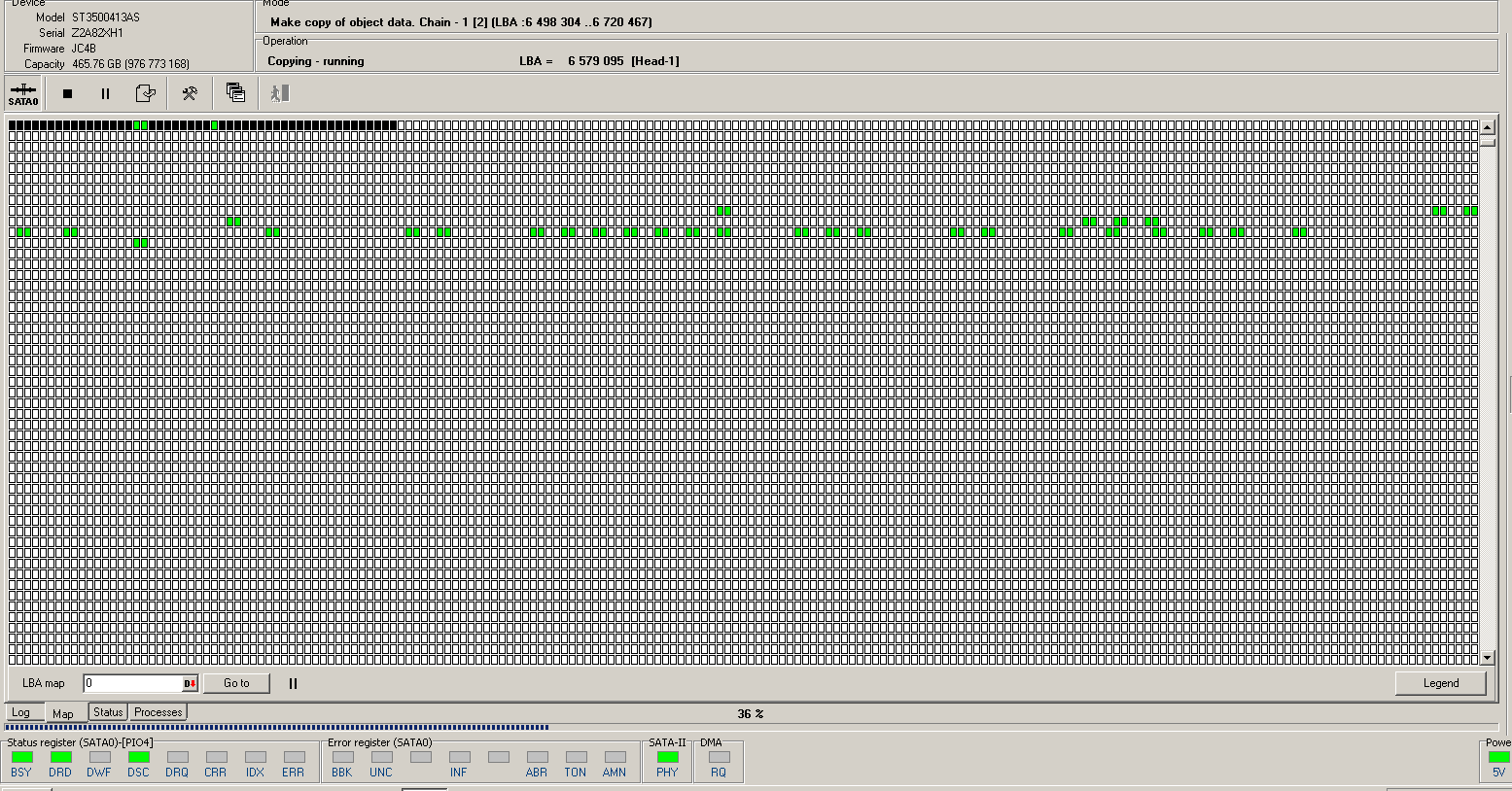

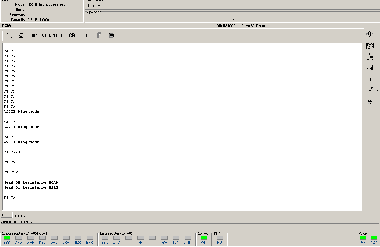

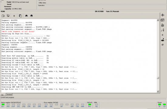

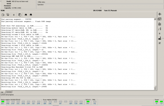

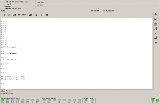

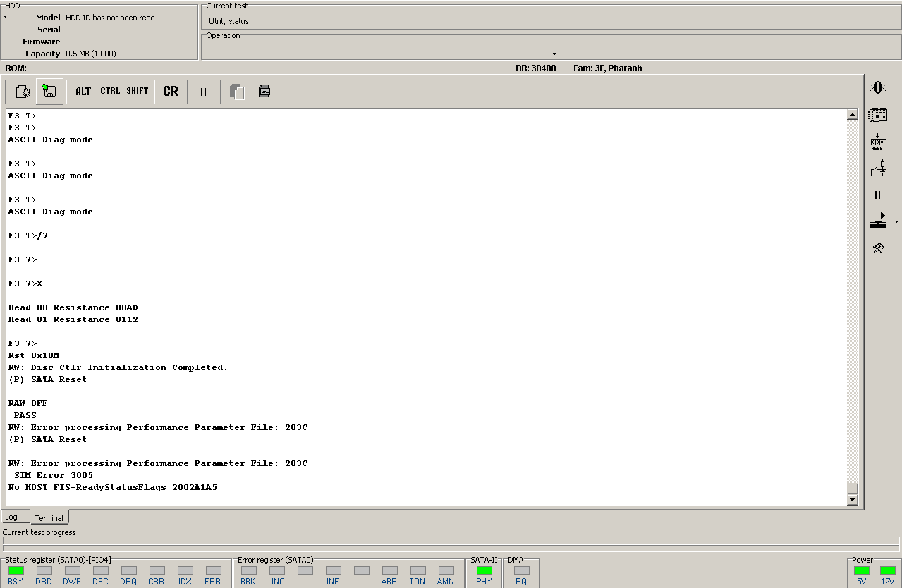

I have got this seagate Pharoh desktop 500GB disk ST3500413AS / FW - JC4B .
It was staying busy , I have cleared SMP flags now drive gives DRD- DSC and sector access as well . I could image D and E drives with speed of aprox.40mb/sec (I have kept read speed low to 66mb/sec) .I have recovered aprox. 269 GB data as well.
However when I try to read C drive ,I experience lots of defects and often drives goes to not ready / busy state.
What could be the issue and what will be my professional safest and technically right plan.
So far I have not shown any impatience and have not fired any defect list clearing commands. I haven't touched anything except clearing smart .
Can someone pls. suggest what will be problem in this part of drive or heads while reading particular parts only.
Here are snaps showing drive diagnostics.
 Post subject: Re: Seaagte Pharoh no mistake recovery
PostPosted: March 19th, 2020, 6:06
Posts: 4831

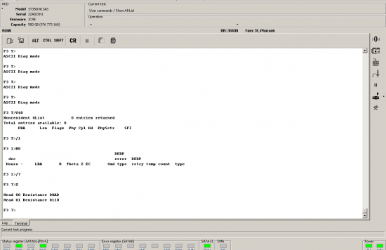

I suspect AltList being full...

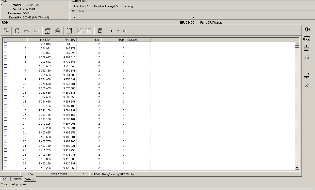

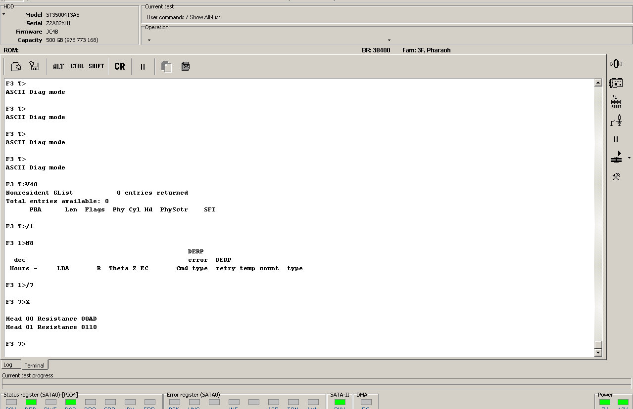

just erase AltList, that's all
don't touch the translator it is fine.

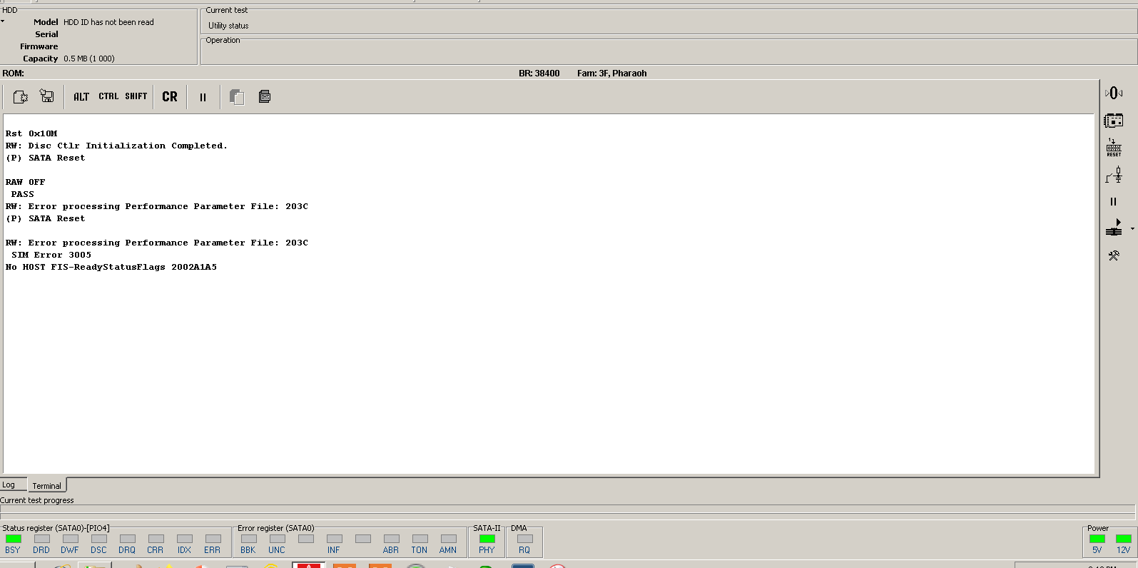

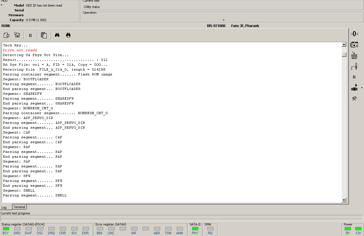

Unfortunately there is no improvements in symptoms even after clearing Alt list .
Is there anything else I can try.

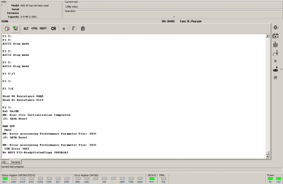

PostPosted: March 20th, 2020, 4:50
Posts: 548
Location: brisbane

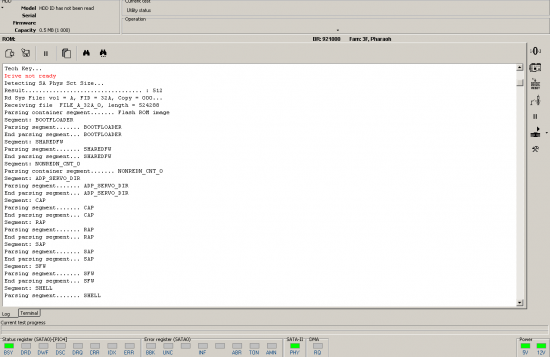

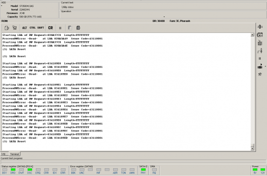

Unfortunately drive has lost readiness and sector access ,it stays busy.
PostPosted: March 20th, 2020, 10:42
Posts: 1777
Location: Phoenix, AZ USA
You do now have translator failure caused by the bad heads.
IMO you need to swap head before doing any more work.
https://blog.acelaboratory.com/pc-3000- ... error.html

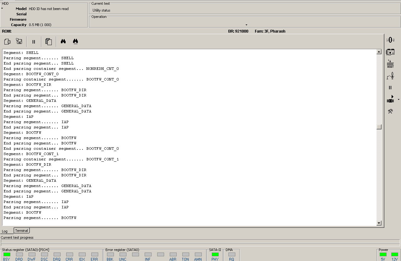

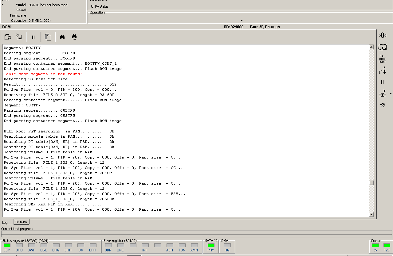

PostPosted: March 20th, 2020, 22:24
Posts: 548
Location: brisbane
Thanks ddrecovery

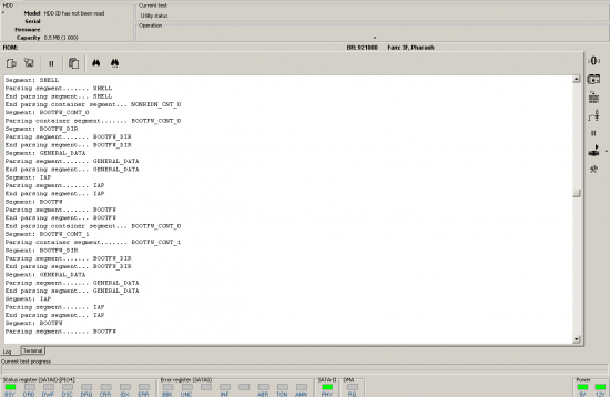

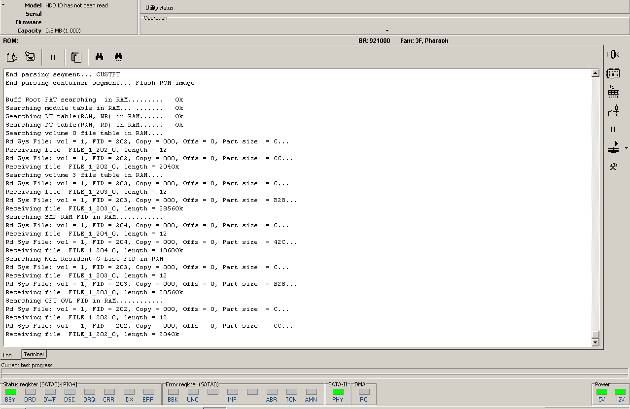

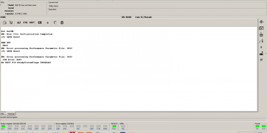

I must admit subject of my topic was no mistake , but I ignored it and made mistakes in panic
Actually I was of opinion that since I have multiple FW backups I can revert back to original state ,unfortunately that is not happening.
Another reason is I have been successful to recover almost 269 GB of data only data left is from C drive.
I have tried random solutions not firstly understanding exact issue but I am confused -
If there was originally head issue then how can I was able to recover such large data without single bad sector.
Now the same disk with same heads is showing large defects for starting part.
I also dont know whether any firmware changes will cause head failure.
Initially when disk came it was having SMP flags issue which I have cleared.
Now reason for disk again getting busy is somewhere else might be in NRG list /translator or G list
Though disk is not spinning down ,a strange whistle type tone is generated for some time after powering.
Now I am restoring system files from backup.Hope it will be successful and drive will give DRD DSC again,
PostPosted: March 21st, 2020, 0:12
Posts: 548
Location: brisbane

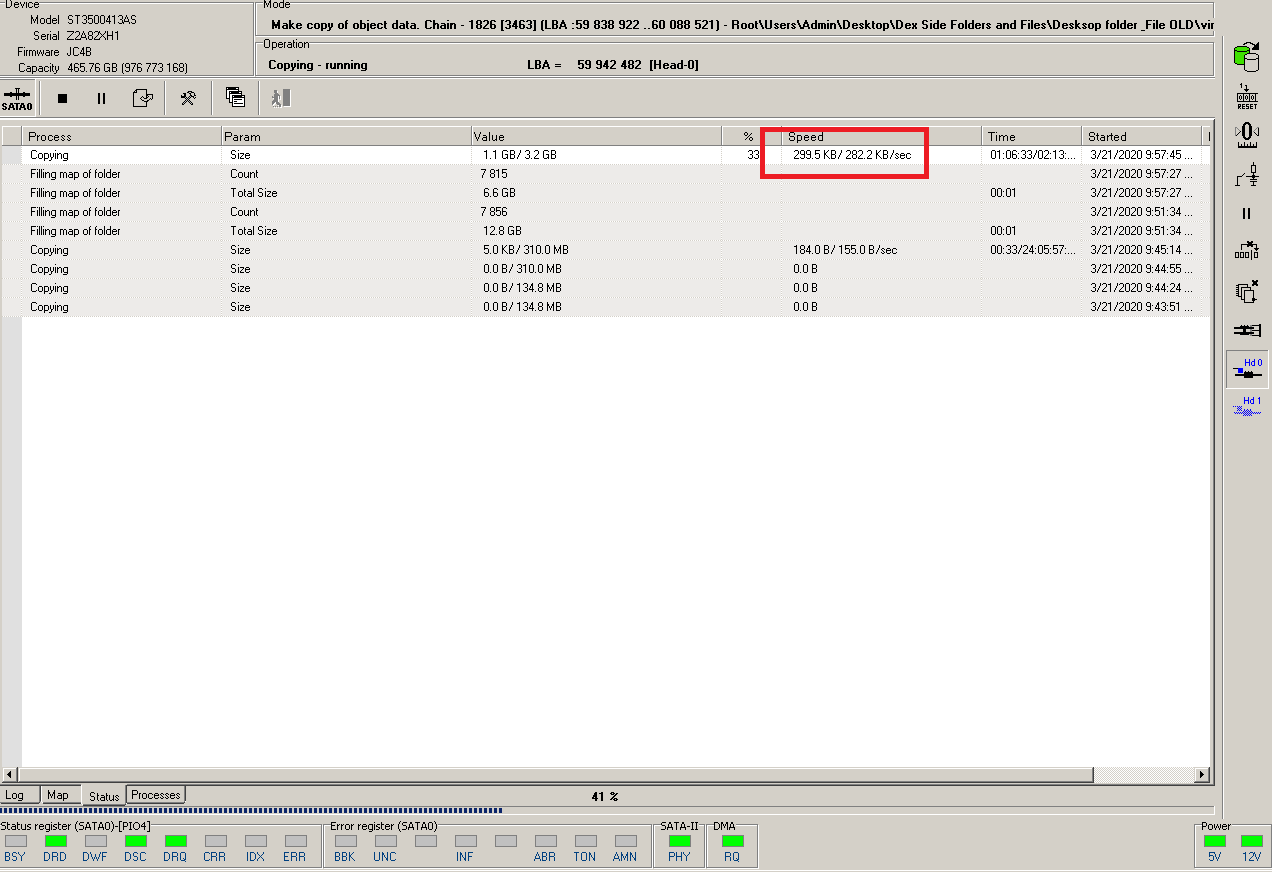

I have been successful to restore all system files and disk has been restored to previous state with full access.
It was a close shave.
ddrecovery - Since I can write system files back any issue with heads can be ruled out now.

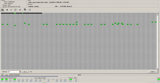

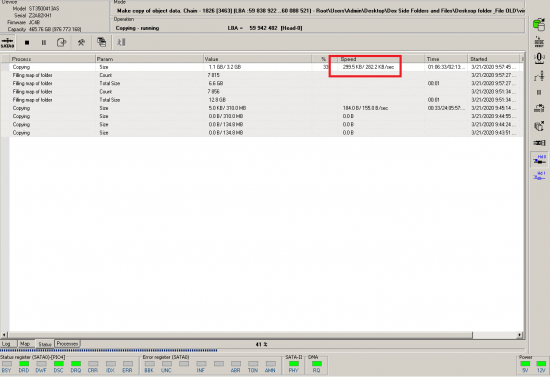

To be honest I dont know design and working of heads, nor I know how they functions fully.
Here both Head 0 and 1 are behaving normally for D and E drives , for C drive Head 0 is slow but reading ( 200-300KB/sec)
However Head 1 refuses to read at all.
That means same heads are behaving differently for different parts of same platter
Strange . I have heard that those super gurus like pepe / doomer know some secret technique to boost signals from head 1 or some other manipulations (increasing current). May be part of the platter is more degraded than rest of the surface.
PostPosted: March 21st, 2020, 7:21
Posts: 4831
Head is weak or contaminated. the easiest way is replacing the MHA, if you don't know how to check if it is weak or contaminated, not to mention cleaning it. There are 2 factors for slow reading: towards lower LBAs (higher track radius) the tangential velocity is higher, so is the flying height of the slider. Another factor is the data rate, which is also higher at higher radius, which can be difficult for a weak head to read.

it was probably due to contamination which may have been blown off uppon head park-load cycles. I can't imagine any sysfile that would cause slow reading on one head. All adaptives are in flash.
