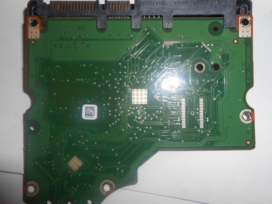

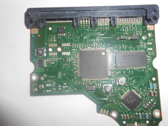

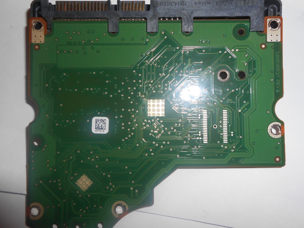

Here are some images of the PCB. Which channels do I short to get terminal responding. Not sure if the read channels should be shorted to ground.

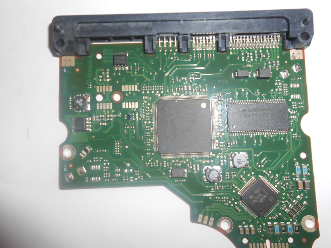

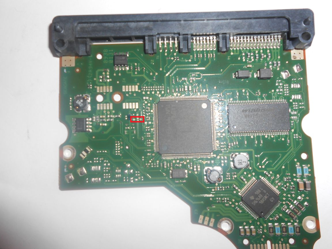

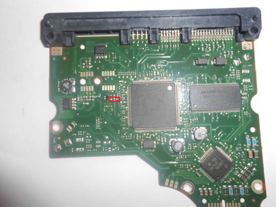

Tip: How to identify the Read Channel test points:
http://www.hddoracle.com/viewtopic.php?f=24&t=123
