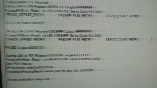

Hello
Drive in topic makes a strange behavior, image at high speed ( ~100 MB ) approx. 260000 sectors and after that read error approx. 260000, and so on till the rest of the drive.
any suggestions ?
Thanks in advance

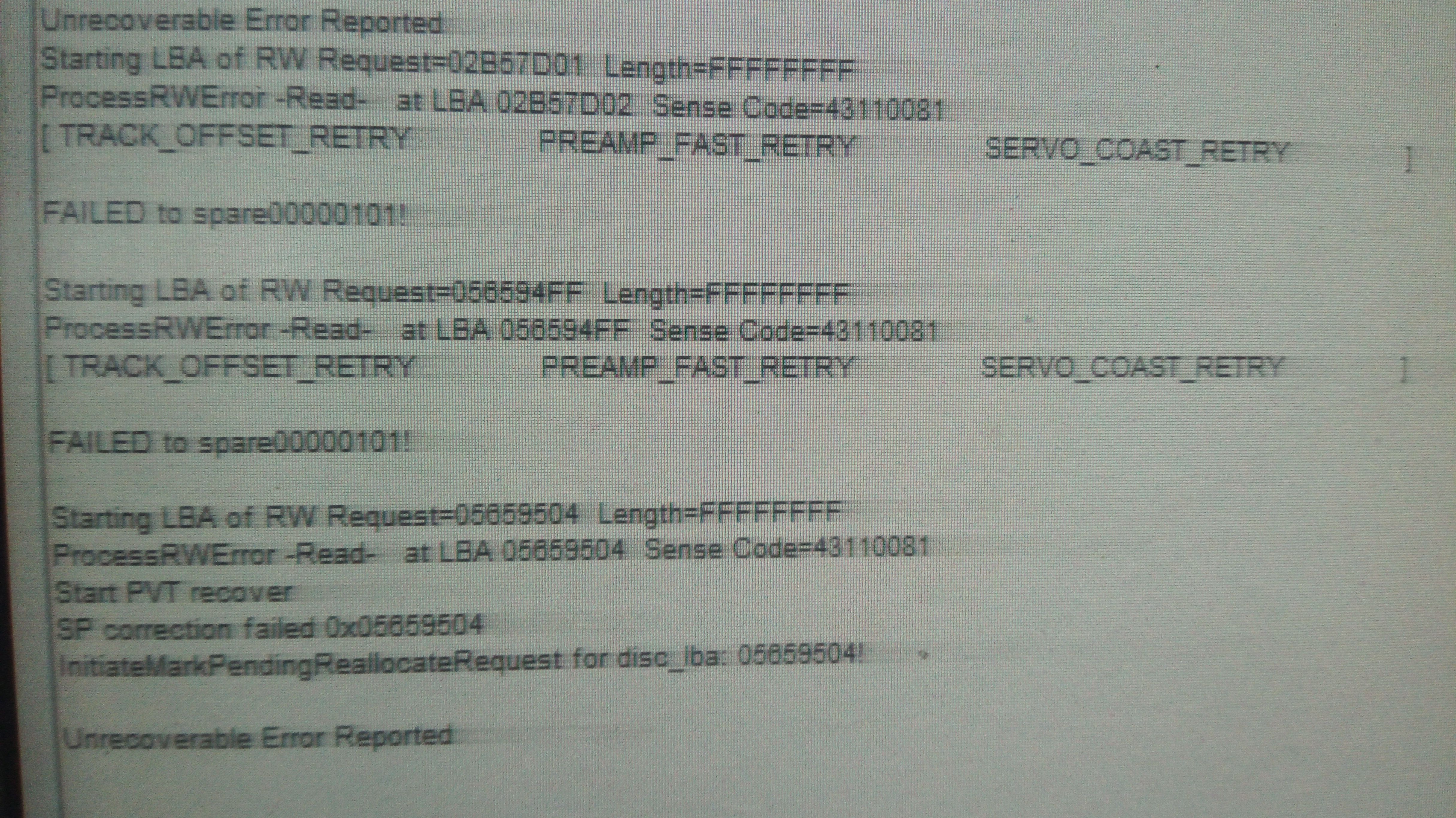

 Post subject: Re: ST500LM021
PostPosted: March 30th, 2020, 16:55
Posts: 1729
pepe wrote:
build hm in DE and verify. You might find it head related...
If so, tune adaptives or try another head set.
Already tried all of that, sir.
And tried to tune adaptives for both heads separated but no luck.
Sorry for the bad quality of picture.
I think that some one has already messed with trans, am I right?
Thanks for your inputs, sir.
PostPosted: March 30th, 2020, 20:33
Posts: 1729
pepe wrote:
pls tell me if the unreadable areas are located on the same head...
Unfortunately, on both sides (0,1).
Two sides make the same behavior.
I believe it's a defect list/s and/or trans problem.
PostPosted: March 31st, 2020, 5:43
Posts: 4829
it would be very hard to produce such problem with the translator. In case of a translator corruption You have either no LBA access at all or you have partial access up to a specific LBA but not such intermittent access you described.
PostPosted: March 31st, 2020, 6:30
Posts: 1729
First sectors and last sectors are readable so there's complete LBA access.
This is very odd, first time see such case.
Thanks for trying to help.
PostPosted: March 31st, 2020, 8:52
Posts: 4829
the head map built by DE might be shifted due to MC. Thus you get the illusion that the unreadable areas are on both heads but in fact they are not.
