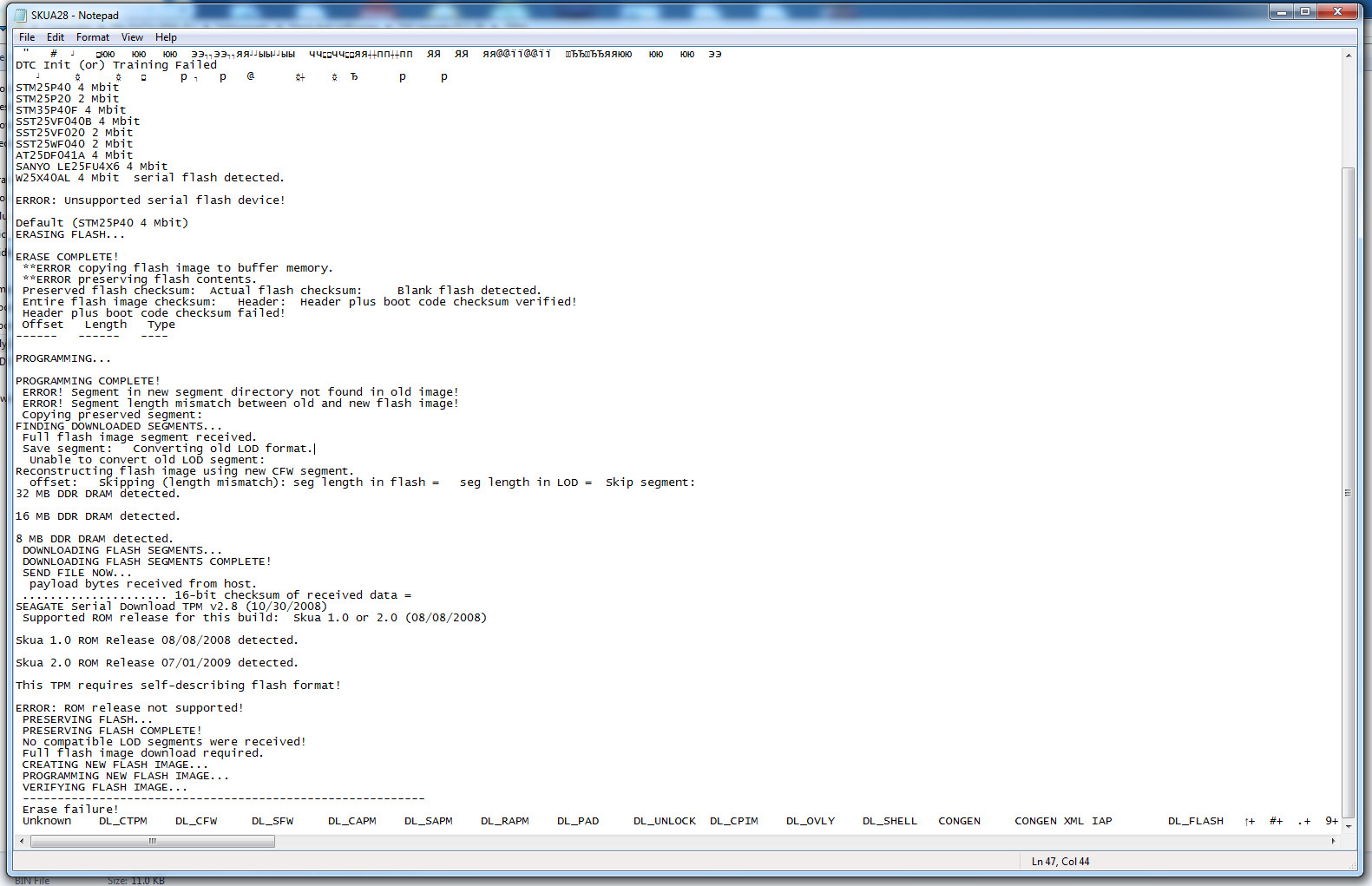

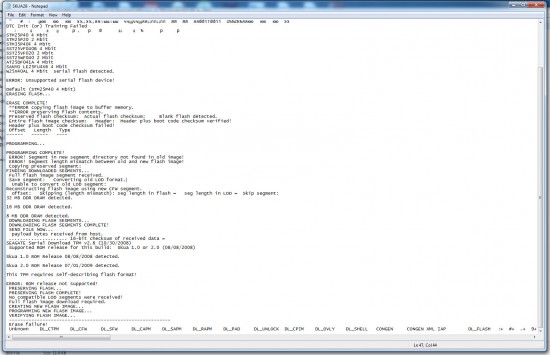

Hi
I think we both get miss understand.
Please Take a look at the picture, here is the Original TPM file from the Factory, in which the names of the ROM modules are mention, but not all names.

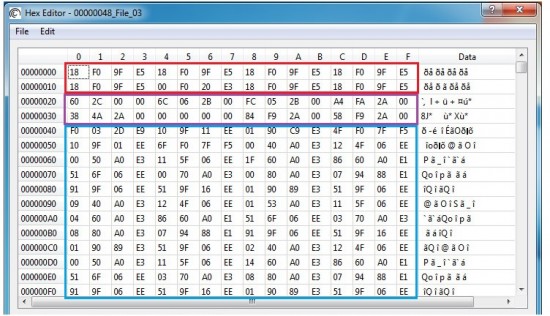

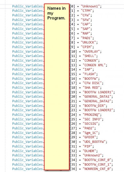

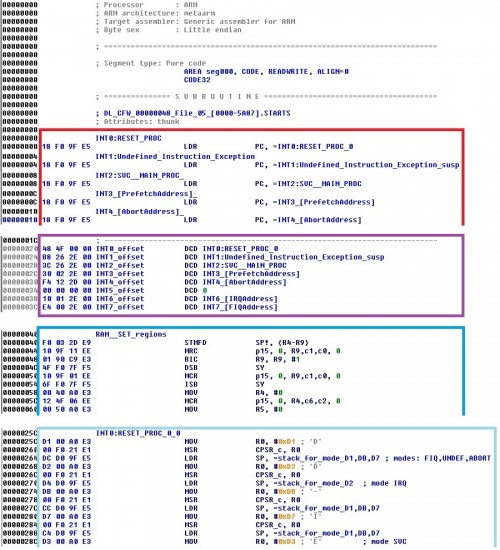

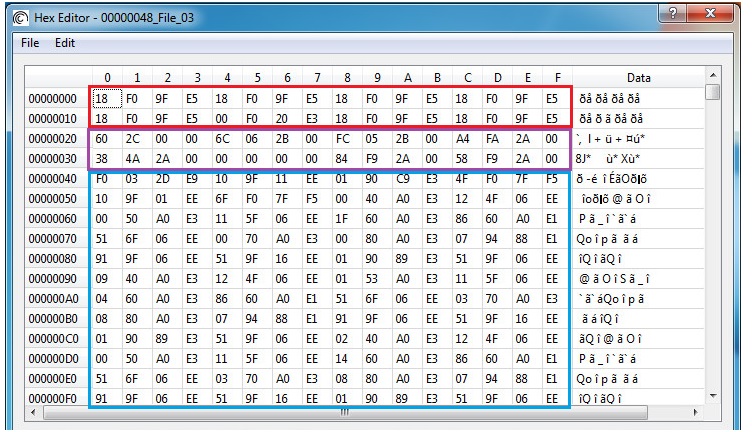

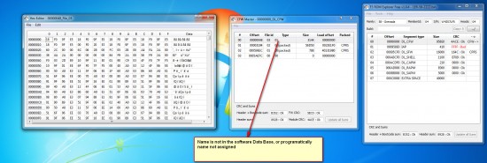

How you collect the Names from the ROM.bin file, without the Factory names , which get from the Factory Data.
Can you please show me how to get names from ROM.bin

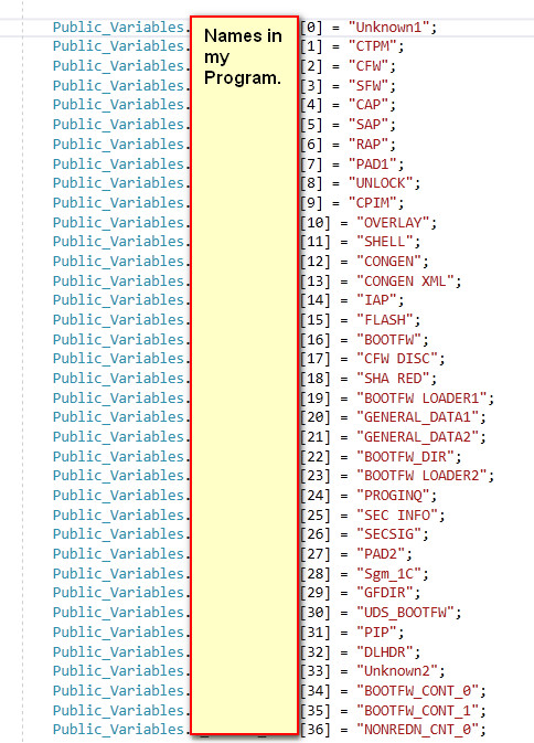

Because as i know, because i am a programer.
We Open rom.bin , parse the address, and then read the Module ID and set the name and then we show in A ListView
ID = 06 in Hex in Rom.bin = RAP a simple Example
So the Question is, This RAP is not mention in the Rom.bin file
We have a ready made compare function in our program, which read the 06 ID and assign the name , which we have in our Data Base.

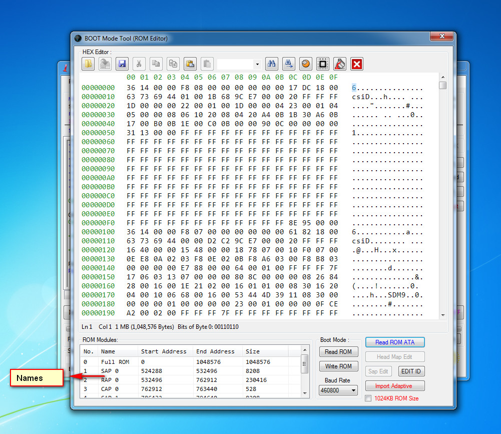

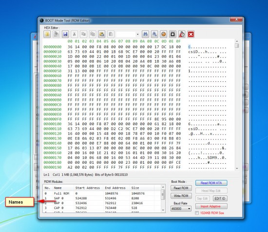

Lets see the following picture
I hope you can now understand.
Second you cannot Dump ROM without a Original Factory info.

From the Above Picture, i show you the way how to get the names and then add in your own software.
If you want me to understand your words fully, Can you please Upload with some reference and pictures.

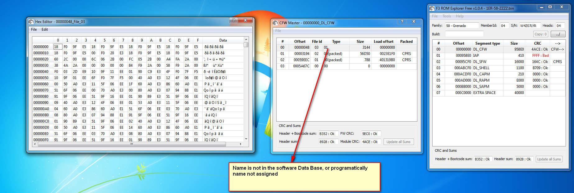

Hi
Few more example for you with my Own SRS software
Here you can see, its showing Few ROM Modules name.
And here you can see names of the modules in my Database which i am assigning by Coding

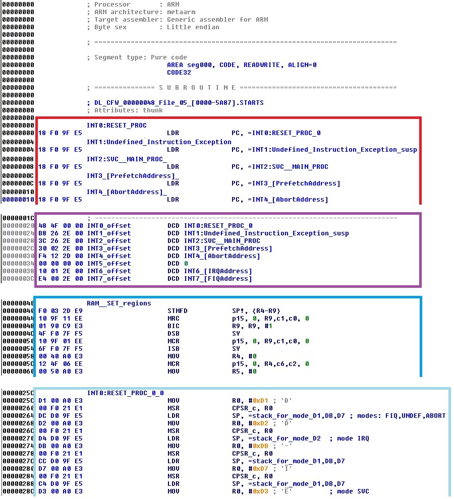

Ali, I really dont' understand what you try to do
You just want to give names to DL_CFW sub-components??
They have no specific names given by Seagate
But if you are programmer, you should know what are they
"ID=3" of your DL_CFW is typical ARM start code: interrupt table, ISR and so on
I've attached similar code from disk I work on:
And same parts of code marked on your module:
Other parts of this DL_CFW are "ID=2": code and "ID=1": data, as I see
The list of ROM modules, which you copied from F3ROMExplorer, doesnt' name sub-components, because there is no reason to give names to sub-components which cant' be used apart. You can add new CAP to flash-ROM, but you cant' change only "ID=3" in DL_CFW, leaving the rest unchanged - this would be total incompatible

Are you saying that all names , like rap cap sap. Are in side the rom.bin file ?
Can you show us us where in the ROM.
By the way i not copy from fw rom explorer.
Canot you see by eyes that i uploaded factory tpm file picture.
From there i copy names.
How could you say that i copy from f3rom exlorer.
I think its easy to just say that some one copy from them.
I copy from factory tmp file. Not from f3 explorer
F3explorer person also copy from factory tmp.
I am sure that name like rap cap sap, not available in rom.bin file
Like name CPRS, open rom.bin and search CPRS test you will find it.
Can you show rap cap sap IAP ? Any of these 4 ?
Also i can swap any thing from 1 rom to another without any problem.
Rap cap sap sfw. This is added in my software to swap from patient to donor rom.
In the above post. Where is mention ID
This is just example. Not an accurate value.
I am requested you to please please show rap cap sap names in rom.bin
After that i will show you a video how a develper find the names of rap cap and sap from rom.bin

waqas_ali766 wrote:
eaxi wrote:
I present small portion of factory log extracted from Seagate HDD SA ...
PROGRAMMING COMPLETE! ---------------------------------------------------------- VERIFYING FLASH IMAGE... Header: 530B00004800000000000000E2B50400 Header plus boot code checksum verified! Offset Length Type ------ ------ ---- 0x00040 0x598E0 DL_CFW 0x598E0 0x00410 IAP 0x59CF0 0x16000 DL_SFW 0x6FCF0 0x01100 DL_SHELL 0x70DF0 0x00210 DL_CAPM 0x71000 0x0A000 DL_RAPM 0x7B000 0x05000 DL_SAPM Flash Byte size : 0x00080000 Entire flash image checksum: 0x44F0 PASS Done
AIUI, @eaxi is telling you that these names can be found in the factory logs in the SA. The names of these ROM modules are not present in the ROM, only their IDs.

Hi
Friend me to saying the same, that it can be found in Factory log.
Not Available in the ROM.bin file
But some people try to show me in the IDA Pro , that names are in the ROM.bin
because CPRS is available in the ROM.bin file
that's why i said, show RAP CAP SAP names.
then he reply, that its compressed.
i try to say him, that in ROM Image, only the ID is available
like 01, 02, 03, 04
And from that ID we assign the Names By programming.
Same method is done in WD Drives.
in WD hdd, all modules and there address is available in 01 module, but only the ID number and There Location and there Size.
Not the Names of Modules.
Names of Modules we get from Factory logs. and put in the Software ListView Programatically , so a User can understand.
