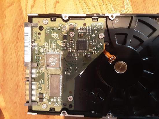

This is a data drive which suddenly wont spin up and isnt recognised in the bios.
I watched a video that suggested that it could be one of the diodes which I checked and one registers a value and the other beeps. So guess the one that beeps is fried
The hdd is a samsung spinpoint hd154ui
If I purchased another drive the same can I just swap out the pcb and be good to go or is there something else I can do
I just want to get the data off and move to a new drive
Remove the diode and check the power circuit to ground. If all is well, turn on the drive.
