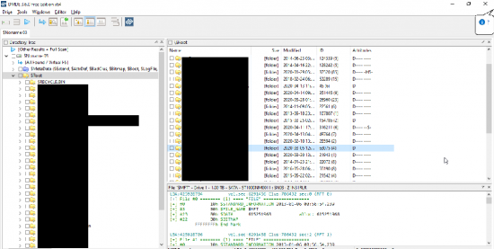

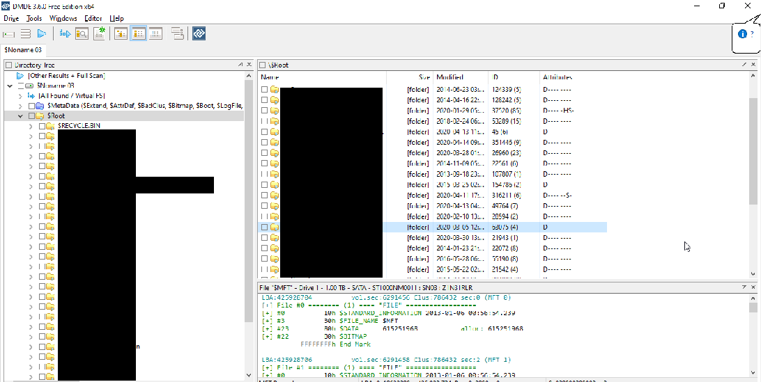

Here's a screen shot of what I see after clicking "open volume". Sorry for the resolution because the forum imposes a size limit.
Not sure where the partition info is. Where should I copy and paste?

Usually it would be safe to r-click the partition and select "Insert the partition (Undelete)", then Apply Changes and reboot. If it goes wrong, only sector 0 would be affected (in an MBR system).
It would be safer if you could upload the partition info so that we could examine it.
Hi, I have decided to move forward, however if I click "Insert the partition (Undelete)"
There is this message warning me:
I am guessing that it's trying to remind me the I don't have a boot record at the very beginning of my hdd, so should I click
the restore button here:
t423.png [ 863 Bytes | Viewed 14487 times ]
to "restore boot sector from copy"?
as suggested, FIRST?

If the boot sector and partition data are the only missing items, then your proposed solution should work. However, without seeing the damage for myself, I would suggest that you try to backup your critical files while you can.

It's hard to know what has been changed when you don't have physical access to the drive. If I had the drive in front of me, I would be examining the boot sector and the sectors immediately following it.
Problem solved!
I restored it first, then undeleted it later.
All data recovered, thank you so very much!
