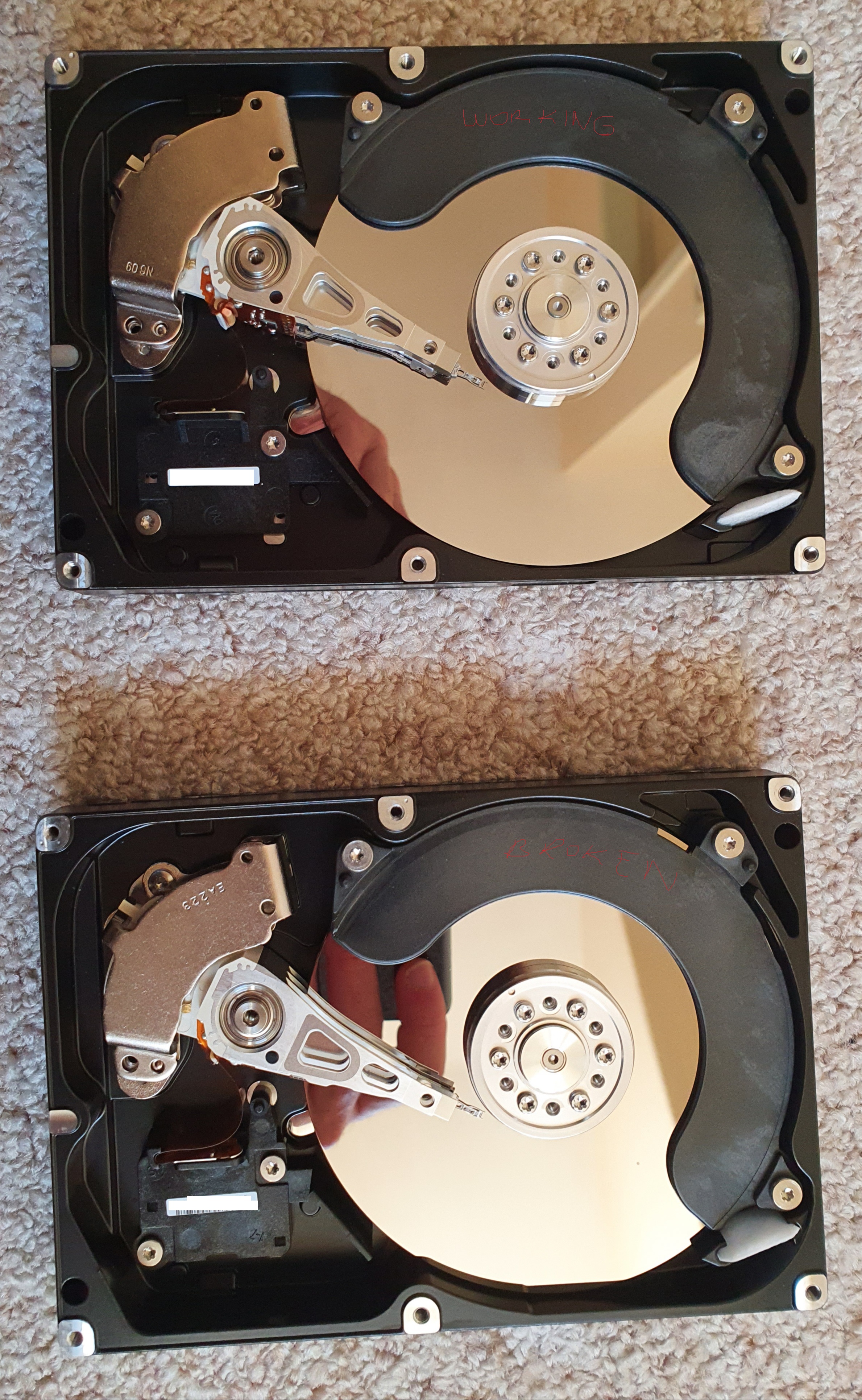

Hello Everyone,
I hope you can help me or give me an idea.
I have a Samsung HD103SI HDD which i dropped a sometime a go. Although disk wasnt running when i dropped it and it was inside a case, It stopped working
and starting making the sound in the attached video below.
https://vimeo.com/user112899863/review/ ... 5e3ab72cf2
It sounds like head got broken to me but i dont know maybe other reason.
I have purchases exactly same model on ebay with the idea to replace head with the healthy one. When you see the picture below. head looks like normal. Above one is working, and below is the broken HDD in the image.
So my question is is it the good idea to replace the head? Can i achieve this? I am an IT person and reparied several hardware issues in the past but never done something with HDDs.
in the attached photo
Any idea or suggestion please?
thank you all
No, it is a really bad idea. Not as if i knew anything about your skills, but you would make things worse almost surely. We see enough drives after such attempts, believe me it sucks. It sucks for the client coz he/she has to pay more than for a clean recovery and it sucks for us coz we can't charge for the extra amount of labour it means for us, nobody would pay that (ok, most clients...). So it is a loose-loose situation.
Your drive needs proper evaluation (now that you opened it, cleaning as well), it might have severe surface damage on the surfaces you can't see, take care of those, etc. Replacing the heads is just the tip of the iceberg. Cloning it is rarely a walk in the park mostly a stressful process even with the best tools, when it comes to surface damage.
So consider what your data is worth for you.
But, at least you came here for advice, that's a really good sign :)

this HDD is difficult and different than others i think. if you see the head attachements. there is only 1 screw under the head. How can i unscrew it? Does anyone have any experience with it? because if you turn the head off the bladders, it covers above the screw and you cannot just unscrew it when it is on the bladder? backside has a no possible access.
Anyone had any experience with this HD103SI model. that will be really helpful

 Post subject: Re: Samsung HD103SI clicking and spinning problem
PostPosted: November 10th, 2020, 16:57
Posts: 17257
See the PDF manual and the video:
https://hddsurgery.com/data-recovery-tools/hdds-sam-f1-f2-f3-p2-3
https://hddsurgery.com/pdfs/HDDS_Sam_F1-F2-F3_p2-3_4.pdf
https://youtu.be/kaBx2_zVzfk
