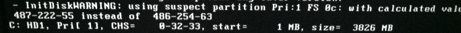

Update:
1. At power at first heads moves normal, and
2. after detected in bios heads sounds really busy running around
3. with a delays i started mhdd, and F2, and F4, but due to the fact
that heads running around on the previously fast sectors indicates slow.
Also notice a warning during mhdd start:
  - InitDiskWaRNING: USING SUSPECT PARTITION pRI: 1 fs 0C: with calculated value
     487-222-55 instead of 486-254-63
https://i.ibb.co/BPD8fr8/initDisk.png

it takes some time to even get to the mhdd, so
he responds to the commands, but very slowly, and
hdd led is constantly Red.
I want to understand what happened and what he is busy with.
 Post subject: Re: Seagate Barracuda 7200.12 1 TB ST31000528AS Issues
PostPosted: April 19th, 2020, 7:54
Joined: April 6th, 2014, 5:59
Posts: 78
Location: ukraine
Summary:
- Starting sound ok,
spins, heads moves
- Bios detects fast, but
- Booting FreeDos for mhdd HDD is
constantly busy.
- Terminal TTL responds, but not sure
what commands will help here,
don't want to make wors
