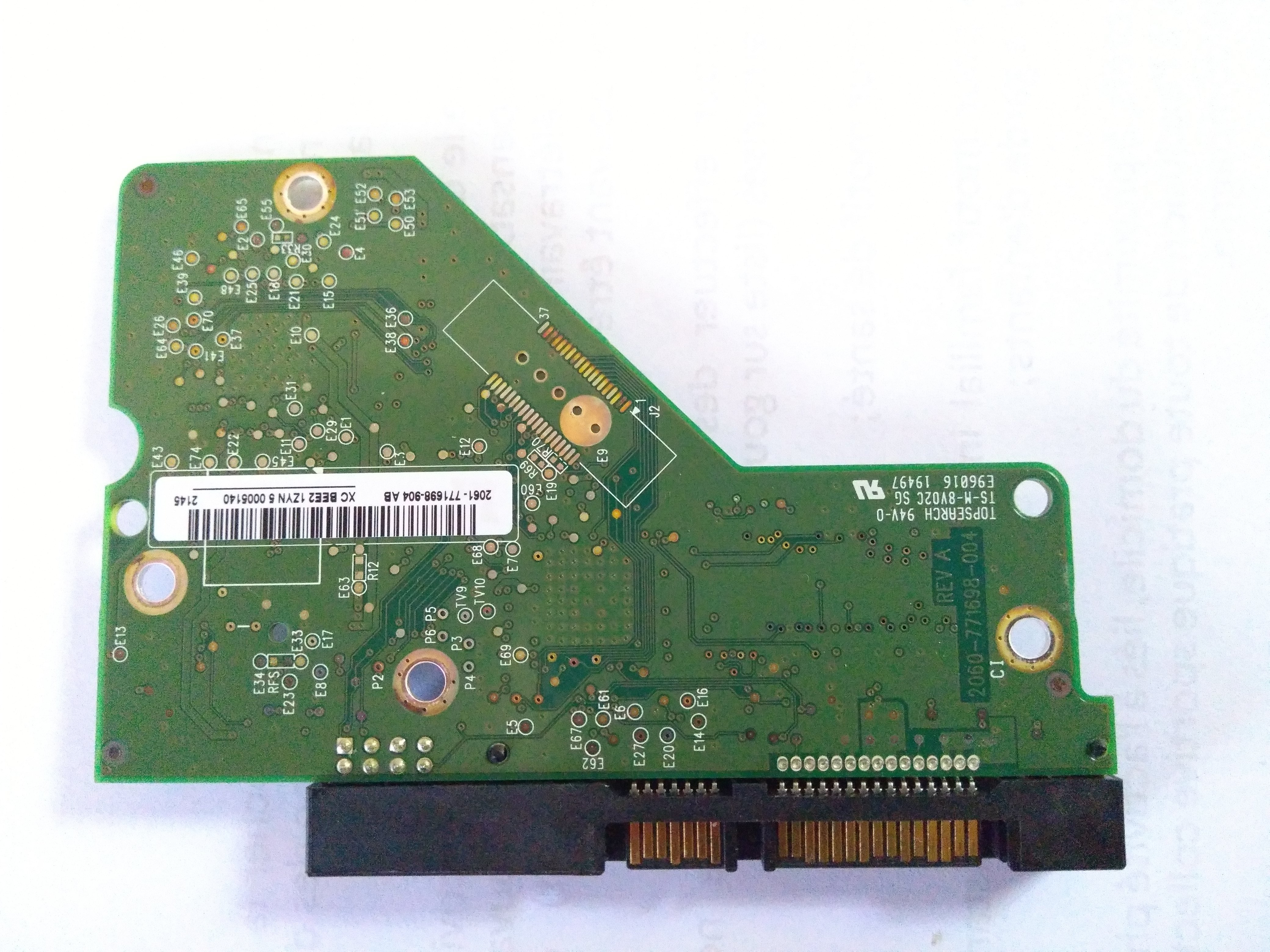

HDD informations :
Brand: WD
Type: WD10EARX-00N0YB0
PCB : 2060-771698-004 REV A
PCB sticker: 2061-771698-904 AB
I had two external HDD cases with the "same" charger, but what I didn't expected is that the polarity was inverted ( + pin in the middle for one, - pin in the middle for the other ).
I've only seen my error after a few minutes and discover that the charger was hot....
Since this incident, the HDD doesn't spin even after I tried to plug it on a new external HDD case.
I removed the PCB to see if there was some burned component but doesn't seem there is one.
I tried to take some measurement with a MM who could be find below. (no skills in this but everything seems ok from my understanding)
D3 / MM on 2M ohm : 0.39 / 0.59 if I invert the leads (values keep growing if I keep the leads on it)
D3 / MM on diode test : no beep / 1 (OR) / 1161 if I invert the leads (values keep growing if I keep the leads on it)
D4 / MM on 2M ohm : 0.43 / 0.56 if I invert the leads (values keep growing if I keep the leads on it)
D4 / MM on diode test : no beep / 1 (OR) / 955 if I invert the leads (values keep growing if I keep the leads on it)
R64 / MM on 2M ohm : 0.37 / 0.53 if I invert the leads (values keep growing if I keep the leads on it)
R67 / MM on 2M ohm : 0.31 / 0.40 if I invert the leads (values keep growing if I keep the leads on it)
Does the HDD have a kind of protection for this case ? If not, is there any chance that is only the PCB who is faulty and not the motors/head inside the HDD ?
In case, only changing the PCB is sufficient, from what I've read, I need to found the same PCB.
Is it still relevant to swap U12 even if the PCB sticker number is the same (as the PCB number on the board itself) and the PCB is coming from the same hard drive reference (but not the same DCM) ?
Thanks,
Best regards,

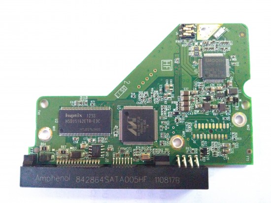

Please find the two sides of the PCB

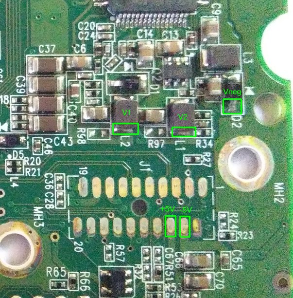

Measure the voltages at V1, V2 and Vneg with respect to ground (eg a screw hole).
Could we see the USB-SATA bridge PCB as well?
