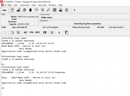

I am attaching a damaged rom.
Thank you for your help.

Why not just use any ROM version and compatible loader?

I used rom from a similar SN disk: 3KC1D ... and it doesn't work

I found :). Works from 60GB. Thank you for your answer.

I am attaching a loader that works.
